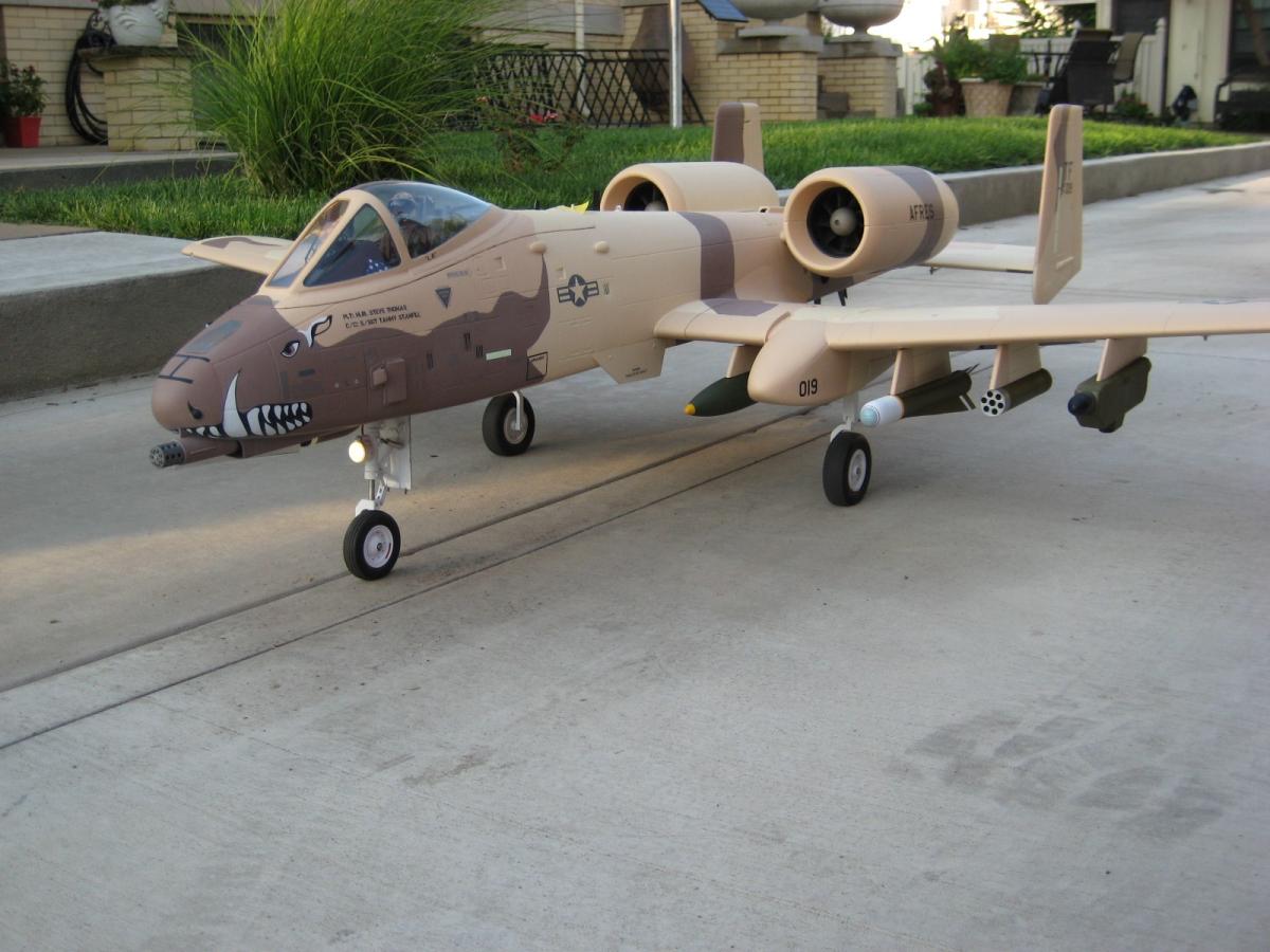

          SI, Welcome to "The Squawk". I used white electricians' tape from the local home store. It came in a blaster pack with 3 or 4 other colors. I painted it with matching latex paints.. Make certain the tape is 'relaxed' before painting it and allow it to dry completely before lifting it to add to your airframe. I did the "Peanut Scheme" though and had the latex paints on hand. You could do something similarly with either latex or enamels, I would think.. Best, LB

            Thanks Elbee . That's a great idea. I'll either look for a color match at my local hobby store or color match at paint store.
            You did an amazing job w/ your A-10. I'm seriously thinking about customizing mine to the Blacksnake livery. Tracking orientation might be an issue though.

              MAN ELbee, that is a sharp looking bird. Great paint job!!

                I thank you, Sir. This bird was my return to the hobby after 20+ years. Things have certainly evolved since those days, but the customizing is much like old school scratch-building with all the perks of a ready made airframe. I love the way this plane tracks and is just so solid. I had some buckin'-bronco landing damage, but that was entirely on me and since has been fully repaired. Best, LB

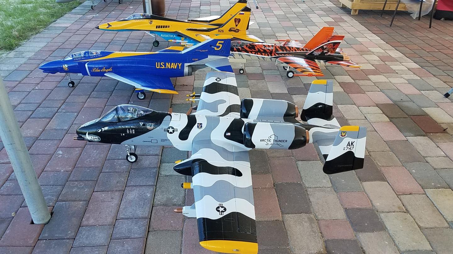

                                    Quick video on my "Snow Hog" that I got out last week with a few other EDF's. This is definitely one of the most relaxing EDF's I have to fly. It's so stable and it's slow flight capability is unmatched, yet even the twin 80mm version has more than enough power do to any maneuver you desire. I'm flying it on 2 SMC 6200mah packs balanced around 18-20mm further back than book recommendation. I've set my timer for 5 minutes of useful throttle time (shutting off at 28%) so usually end up with 6-7 minutes of air time. Not bad for such a large EDF. If the real thing flies as nice as this model, I can see why our troops on the ground and our "Hog" pilots love this machine so much! :ov10:
