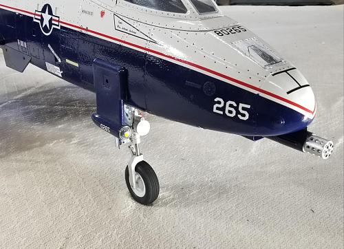

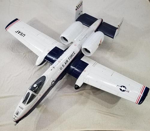

      Just finishing up my A-10. Just need to permanently install the receiver and satellite and final balance.
      I did a bunch of custom painting with my airbrush, and also a bunch of weathering following loosely the RC Geeks tutorial on weathering.
      Did all the "rivets". Lots of rivets....
      Pilot is Jet Hangar Hobbies 1/10 scale I painted up.
      I think it came out pretty good.
      -Dave
      great job on the finish work - mine will look like that too after the maiden... :)

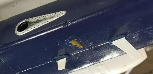

                  In the first two pics , I made the refueling port removable so air can come in and cool my batteries with the APU exhaust port in the rear as the air exit vent.
                    Gorgeous bird, Jetman... well done!

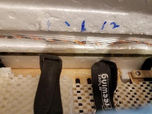

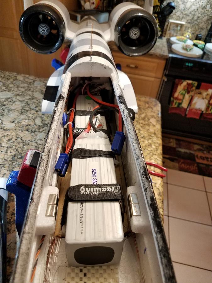

                                      The only modifications I did, other than cosmetic of course, was moving the board to allow the batteries to go further back as I mentioned above and I also added a 5mm square carbon fiber tube with length of about 24" glued into the existing channel on each side of the front half of the fuselage. Not sure it's necessary, but someone recommended it and the empty channel just looked like a good place to stiffen the fuselage considering the weight of 2 batteries. I also recently swapped out the stock 80mm outrunner fans with the 3658-1920 Kv 9 blade inrunner fans from my Mig (which I upgraded to FMS fans with 25% more thrust). It honestly didn't need it, took off fine on grass, climbed with ease and had plenty of power, but I didn't want those Mig fans to go to waste and they did give me about 15% more thrust, more efficiency on battery use, takes off from all kinds of heavy grass much better, and climbs like a rocket!
                                      Hope some of this helps, if you have any other questions, just ask. I know you'll end up loving this aircraft. IMO, it is definitely the easiest EDF to fly and land and when it's with me, it's always the first up because it really relaxes me to fly it and I get a load of confidence before moving on to something else.
                                      The photos below show the location of my batteries (that was using 2 Roaring Top 6250's, which weigh about the same as the SMC 6200's I'm now using) and also the carbon fiber tube. Third photo is the rates and elevator neutral position from the manual.
