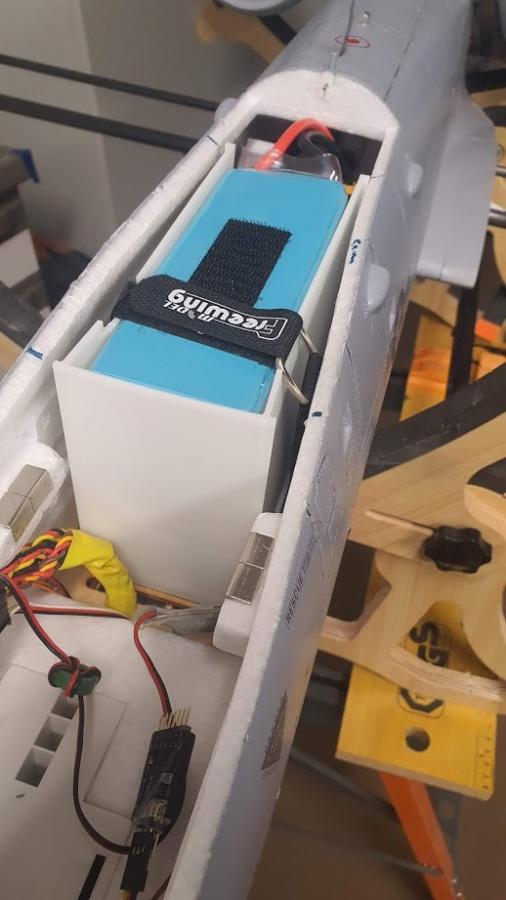

            It's not a particularly power hungry setup in stock trime, particularly given it loves life at cruise throttle. I suspect those packs would be good (we dont get RT packs here so have no experience), and make life easy for balancing the plane.
            I use pretty heavy (~900g) 6000mah batteries, which necessitates 'stacking' them to achieve my target 88mm CG, rather than the layout freewing intended for the battery compartment. This also necessitates moving the control board back slightly. Didnt like the way the batteries moved around when sat on top of one another so 3d printed a little caddy - put the batteries into the caddy and then strap that entire brick down into the plane. Please, no comments on the wiring loom - this has since been tidied up with a single sbus wire lol.
            Click image for larger version  Name:	20210415_212937.jpg Views:	0 Size:	49.5 KB ID:	316729
            Couldnt actually tell you flight times as I fly this plane purely on voltage telemetry. It's liberating flying without a timer. I have seen people stretch out some borderline unbelievable flight times on this thing - it can manage energy incredible efficiently.

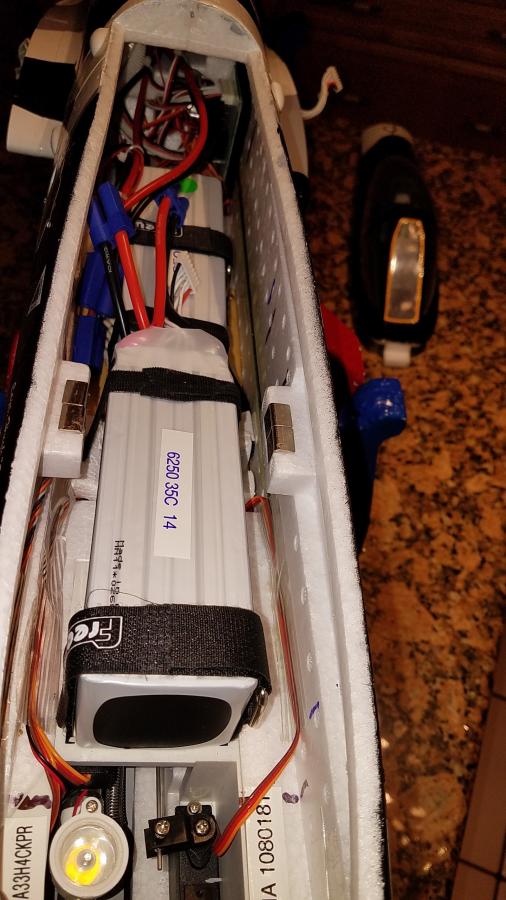

              I also stuck with the stock 80mm fans (and it does everything it needs to with those) and am using 2 Roaring Top 6250's and get over 5 minutes of flight time. I changed the nose strut to the trailing link, primarily because I fly off of grass. Additionally, I would also suggest that you balance it not at the 78 mm suggested in the manual, but more like mshagg and sam51401 did at 88 to 90 mm. I balanced mine at 90mm (and it is still slightly nose heavy there) and found that it lands and takes off much better there. On landing, you can get the nose up much easier and touch on the mains first thereby avoiding the dreaded bucking bronco. If your nose hits first, or even simultaneous with the mains, especially on a hard surface, you will most likely start the bounce (immediately followed by a call to MRC for some new parts). The RT 6250 weigh in at 798 gr, and had to remove the circuit board and mount in further back on the fuselage wall to get my batteries far enough back. Stacking them as mshagg did is a great idea, but I was able to get it done with one in front of the other. Different strokes, but both work. I'm guessing you'll have no problem with the RT 5000's getting it to balance around 90mm and you should get something like 4 minutes of flight time, based upon my experience with the 6250's. I would also suggest you strengthen the forward section (the entire battery bay area, from back where the foam wall is all the way forward) with some carbon fiber tubes. A channel is already in place to put them in.
              Oh, and if you do decide to get this, you will definitely not be disappointed. It's actually, IMO, one of the easiest and smoothest EDF's I've ever flown, including landing (as long as you keep the nose up). Even with the 80mm fans, it takes off of grass quickly, has plenty of vertical, will knife edge at 80% throttle, and will cruise all day at 50% throttle. I was a little nervous with the first flight, but quickly found out it has a "pucker factor" of 0, right there with the Avanti!

                Thanks for all the information, that will help a ton! The more a read about this plane the more I love it 😂 what size carbon fiber tubes did you use to strengthen the forward area?

                        Honestly can't remember which size I used, probably a 4-5mm round or square rod. I have a lot of different sizes and whatever fit in the existing channel. Just measured it and it looks like I used a 5mm and epoxied it in. The total length is about 15 inches. Horizon Hobby has a lot of different size tubes if your looking for them.

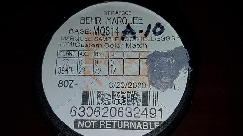

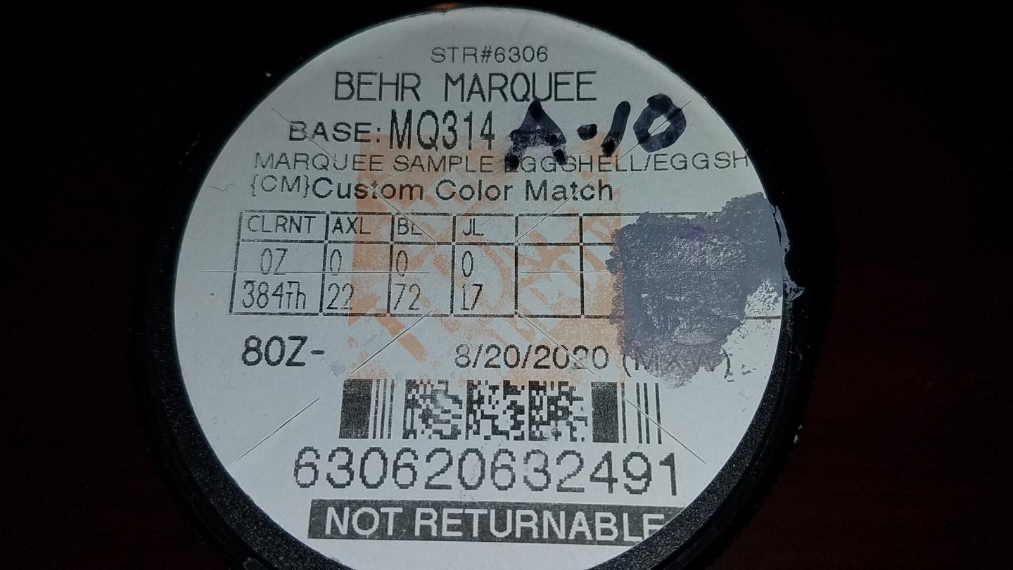

                                      Does anybody on this forum have the Home Depot Acrylic Paint Codes for the Greys on this A-10 ? Or remember seeing which page it might already be on so I can get some made for touch-up purposes. Thanks in advance guys. Love my A-10 !

                                        This is what I used, can't remember if I got it myself or from someone on the forum. I used an eggshell base, in the event the numbers are not clear in the photo, they are: 22/72/17.

                                          Thanks Hugh I'll try it for sure. Was wondering if you might just have the codes for the 2nd color grey that is stock on the Freewing A-10 as well?
