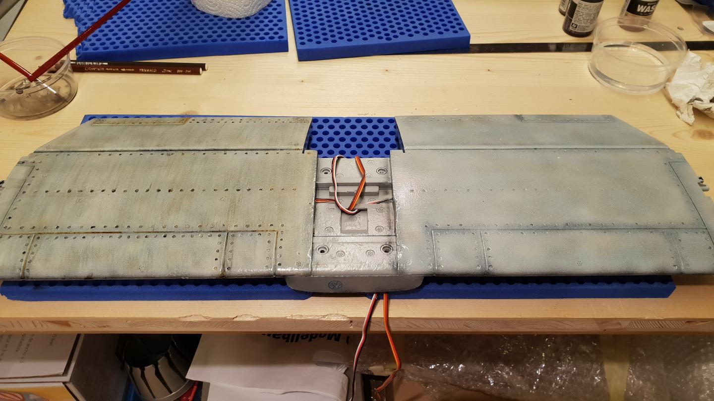

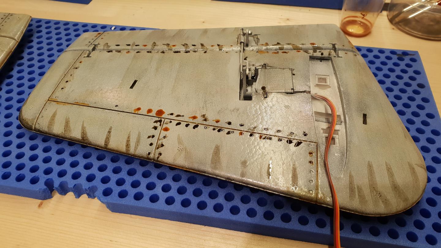

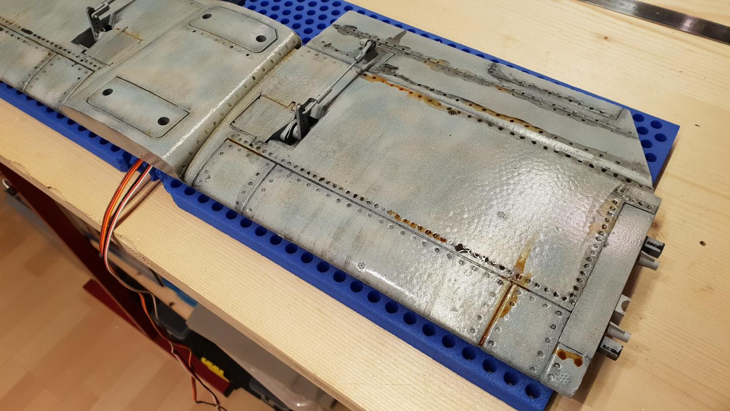

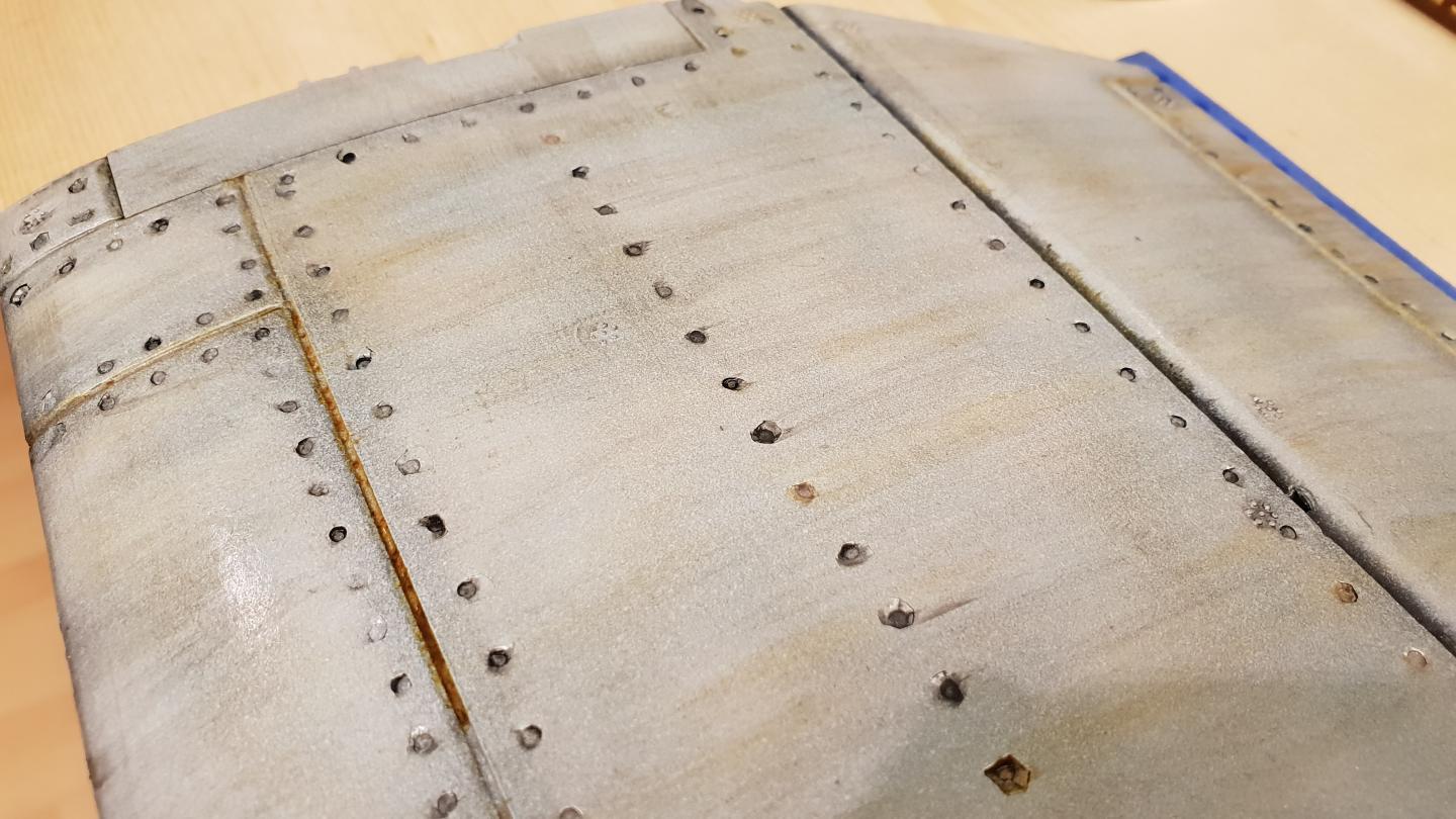

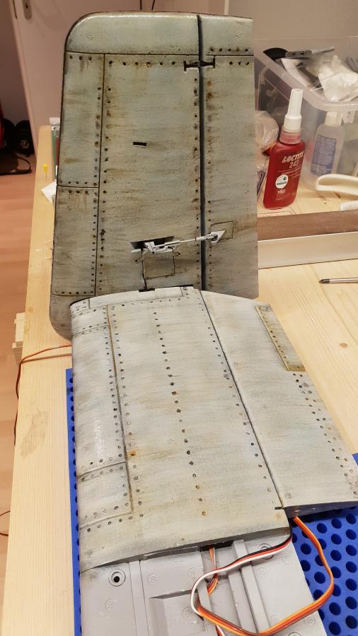

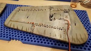

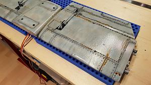

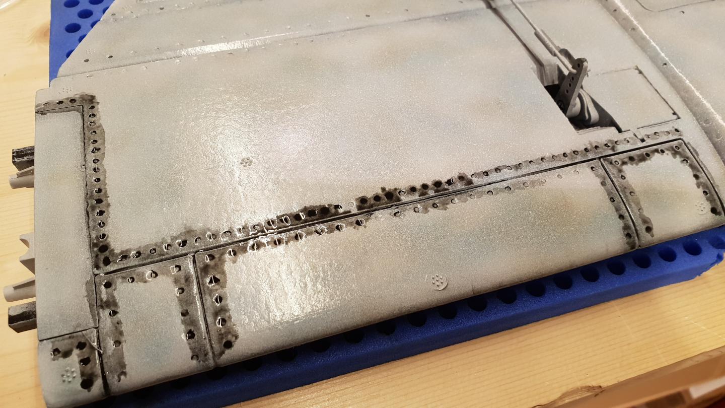

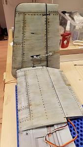

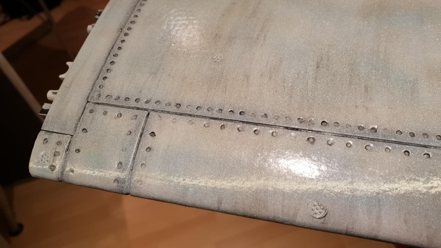

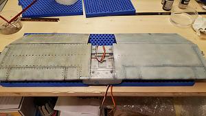

    Finally I started to wash my bird with some Vallejo Wash. It turned out to look pretty old and done. I won't take a ride with a real bird looking so bad. It's my first time to use this technique, used three different type of color. Dark grey, Middle grey and rust.
    Applied some water to the rivets and panel lines with a brush,
    then applied dark grey with a second brush.
    Click image for larger version  Name:	20181108_193019.jpg Views:	1 Size:	175.4 KB ID:	160835
    used a paper towel to remove exceeding color after approx. 5 min.
    Click image for larger version  Name:	20181108_194001.jpg Views:	1 Size:	167.9 KB ID:	160836
    next application
    Click image for larger version  Name:	20181108_195506.jpg Views:	1 Size:	184.6 KB ID:	160837
    after second cycle
    Click image for larger version  Name:	20181108_202237.jpg Views:	1 Size:	153.7 KB ID:	160838
    next cycle
    Click image for larger version  Name:	20181108_212340.jpg Views:	1 Size:	173.1 KB ID:	160839
    and so on, guess I have to stop now. :-)
    Click image for larger version  Name:	20181108_202222.jpg Views:	1 Size:	152.7 KB ID:	160840
    Click image for larger version  Name:	20181108_220212.jpg Views:	1 Size:	66.9 KB ID:	160841
    Remember to check the look under daylight.
    Now it looks like a Mad-Max style Jet. Not sure if you like it...but I do. I built many Jet's so far but this one will turn out different.

      Welcome, Edin and Wobisch!
      Wobisch, I like your unique approach. In your photos some of the surfaces look like bleached denim jeans, which I think is a very unique effect. "Different" is good! As long as you're happy with it, that's all that matters. I've used Vallejo paints in the past but not as washes. Are you using the Model Air series from Vallejo, or their normal, thicker paint series?

        Hi Alpha

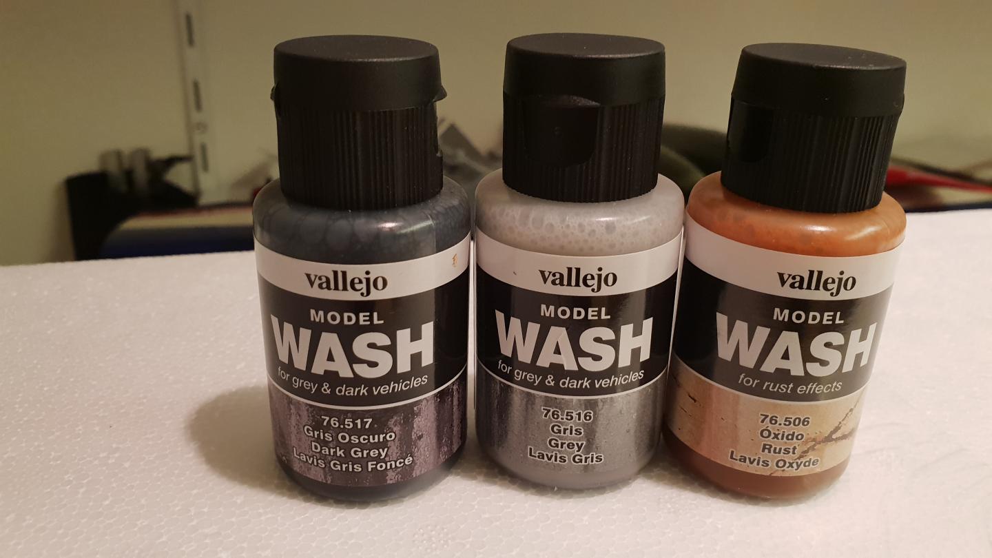

        The Denim Effect is much stronger under the LED Light in my hobby shop than outside.
        I used the Model Air Series for the painting and the WASH Series for the washing. It seems that there are much more pigments inside.
        Click image for larger version  Name:	20181108_223851.jpg Views:	1 Size:	101.6 KB ID:	160851
        Thank you for making this nice bird... really love it. Next one will be the Phantom. Got it last week.

              Wobisch, Welcome and I wouldn't ride in it either, but I'd sure as heck fly it! Best, LB

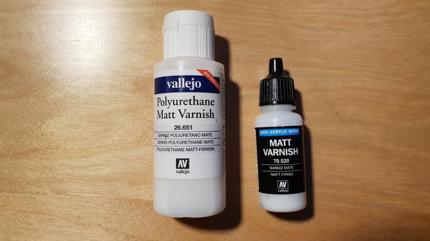

                  I used an acrylic PU Coat which is semi gloss, you would use it to seal your wooden floor normally. That's actually what I don't like but it helps to get a stronger surface. Next step will be the decals and then one more coating with a matt coat from the airbrush shop. This is an experimental procedure. Not yet sure if all steps are in the right order.
                  This products I found in the airbrush shop meanwhile. Gonna use it as soon as the decals from Callie Graphics are applied.
                  Next time I will apply the PU coat with the air brush to avoid brushstroke.
                  Hope you understand and my english is good enough.
