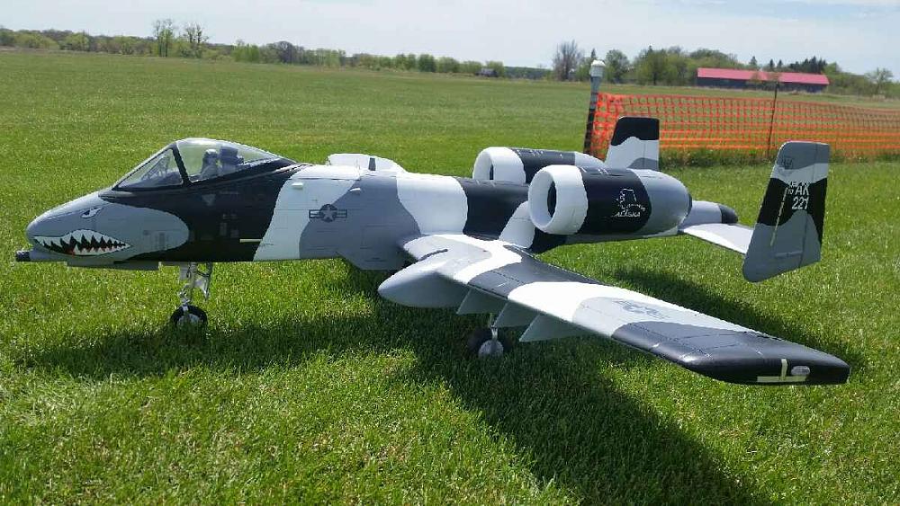

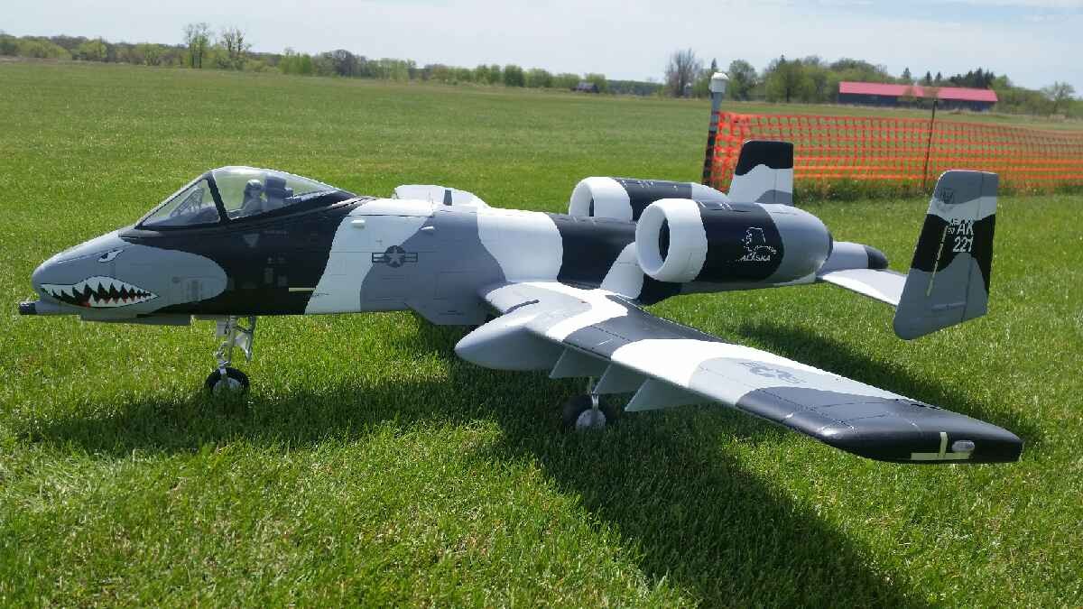

        #8783
        Here is my Arctic scheme
