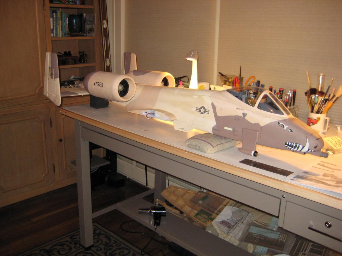

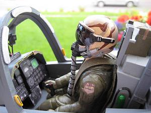

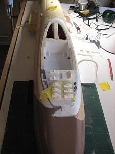

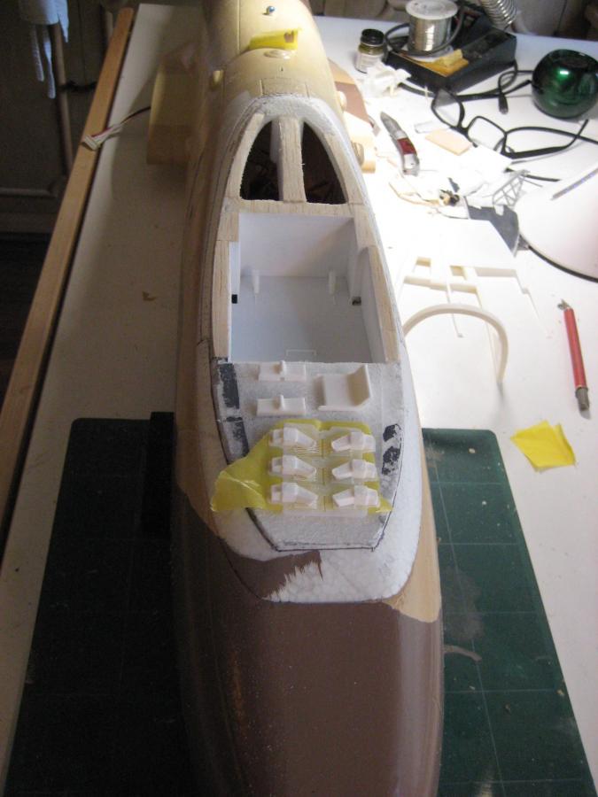

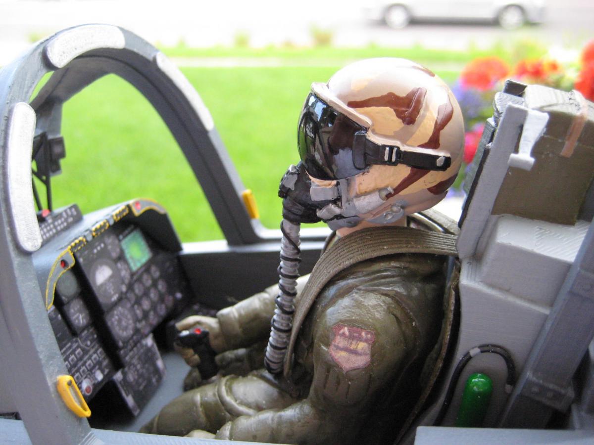

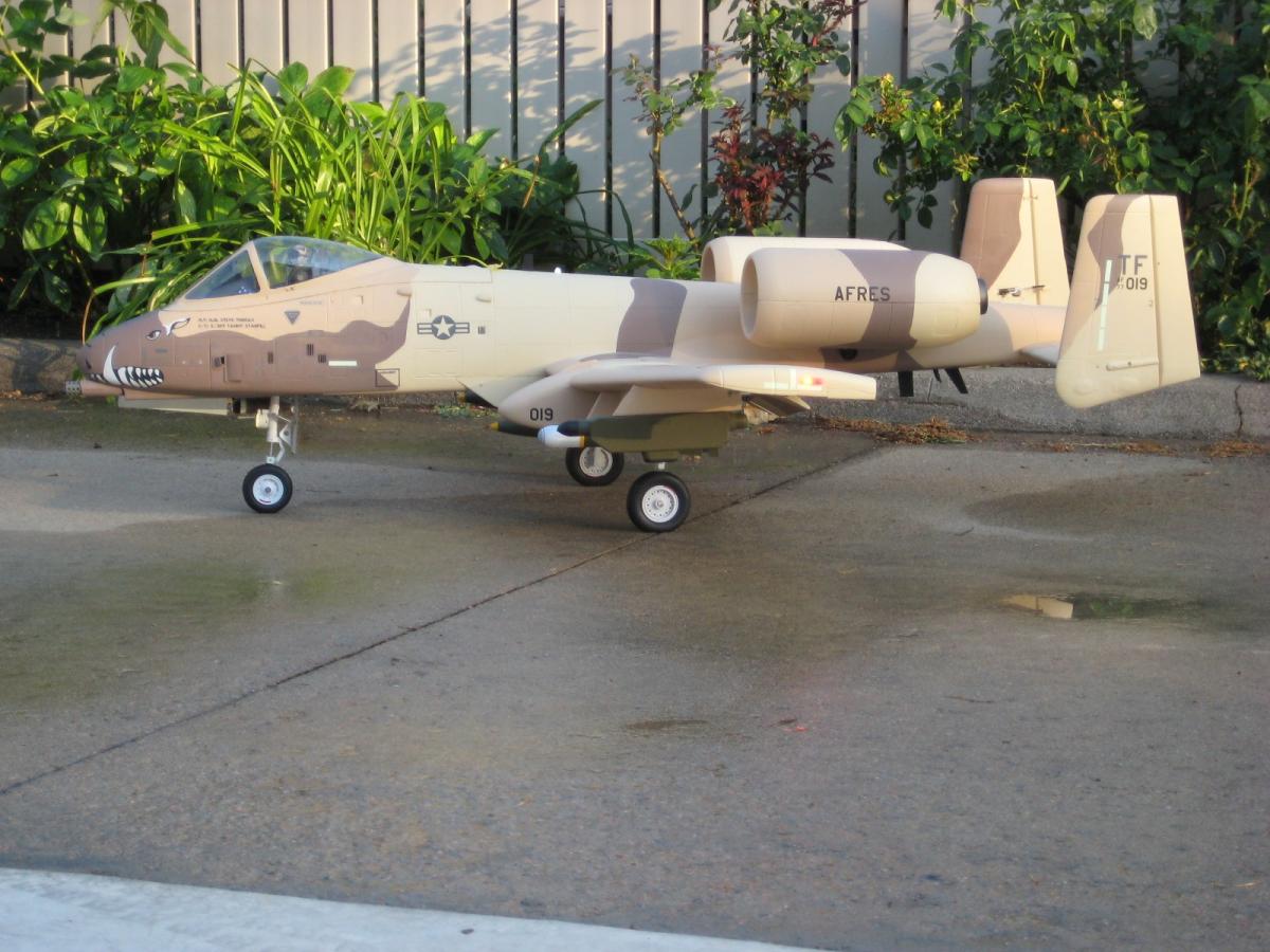

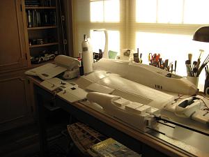

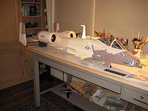

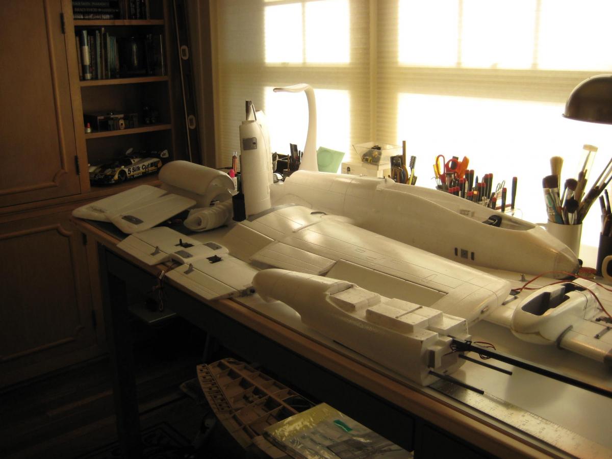

                                        Stilgar99, Welcome to "The Squawk"! I understand going through the entire thread, though it is decent reading. As for your repaint, I stripped the entire model with acetone as it doesn't hurt the EPO foam, but will soften the 'plastic bits'. If you choose to strip the OEM paint, I think you'll want to come back with a base coat to protect and seal the surface and give it back some depth. I used Minwax Polycrylic clear with a foam-brush 2 coat application and added a third to areas that were still 'gatored' looking. There is any number of ways to accomplish this, that is simply how I did it. Many guys have simply put down a couple of coats Krylon primer over the OEM paint. We're not worried about 'fuel-proofing' so buy whatever product(s) you're comfortable with using. Uncertain what paint scheme you've chosen, but any model acrylics or enamels will work great. I had Home Depot (HD) color match FS numbers and airbrushed and hand-painted using thinned semi-gloss Behr Marquee outdoor latex (sample sized jars). I finished the model with several light coats of Krylon clear flat rattle can after applying all the markings. Hope this helps somewhat and simply ask Q's here and I promise you'll get an answer and of course differing techniques. Post pics when you are able. Best, LB
                                        Click image for larger version  Name:	Blank Canvas.JPG Views:	2 Size:	93.2 KB ID:	147243Click image for larger version  Name:	Cockpit parts (8).JPG Views:	2 Size:	58.8 KB ID:	147244Click image for larger version  Name:	007.JPG Views:	2 Size:	112.8 KB ID:	147246Click image for larger version  Name:	IMG_0001.JPG Views:	1 Size:	103.5 KB ID:	147245Click image for larger version  Name:	IMG_0014.JPG Views:	2 Size:	140.4 KB ID:	147247
