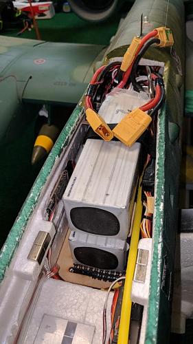

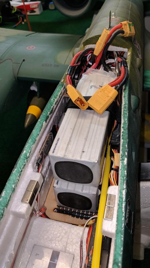

      Because of my mods I had to stack my batteries like this. My other 90mm A-10 has the batts in the stock location.

        Originally posted by brrzee
        Janmb, stacking them in the aft position? Sorry not sure exactly what u meant by that. I am really trying to avoid moving the guts around. Thinking of taking some weight wrapping it in foam and lodging it behind the electronics and just keeping batteries in battery bays. Will have to keep playing. Guess thats one flaw of buying batteries other than recommended
        I am refering to what RCJetdude posted in his image: Having both batteries on top of each other in the aft battery bay. Doesn't require any mods other than a longer/extra strap.

          Awesome awesome gentleman...i will try & go that route. Just tidy up the wiring around the batteries..where is your receiver. I see the speed controller taped to side of the fuse

              What type of batteries are those in the above posted pics

                  Those are Roaring Top 5800ma, 6S, 35C batteries. A gear door sequencer is just to the left of the upper battery and the receiver is servo taped to the opposite wall. Again, this is not a normal installation because behind the batteries is my powder canon and Shockwave2 sound board. The additional nose weight warranted stacking my batteries. My CG is between 80-85mm inverted with gear down. Balanced with my index fingers on the plastic wing roots. At one time this bird weighed in at a whopping 16lbs but I have since shed some weight. Around 14lbs. now. Flies great on the stock 80mm fans and 3D printed whistles in the nacelles give it a very realistic sound without the sound system. I hope Motion will have some video of it up soon from NEFI.

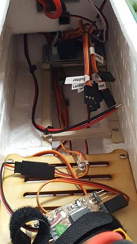

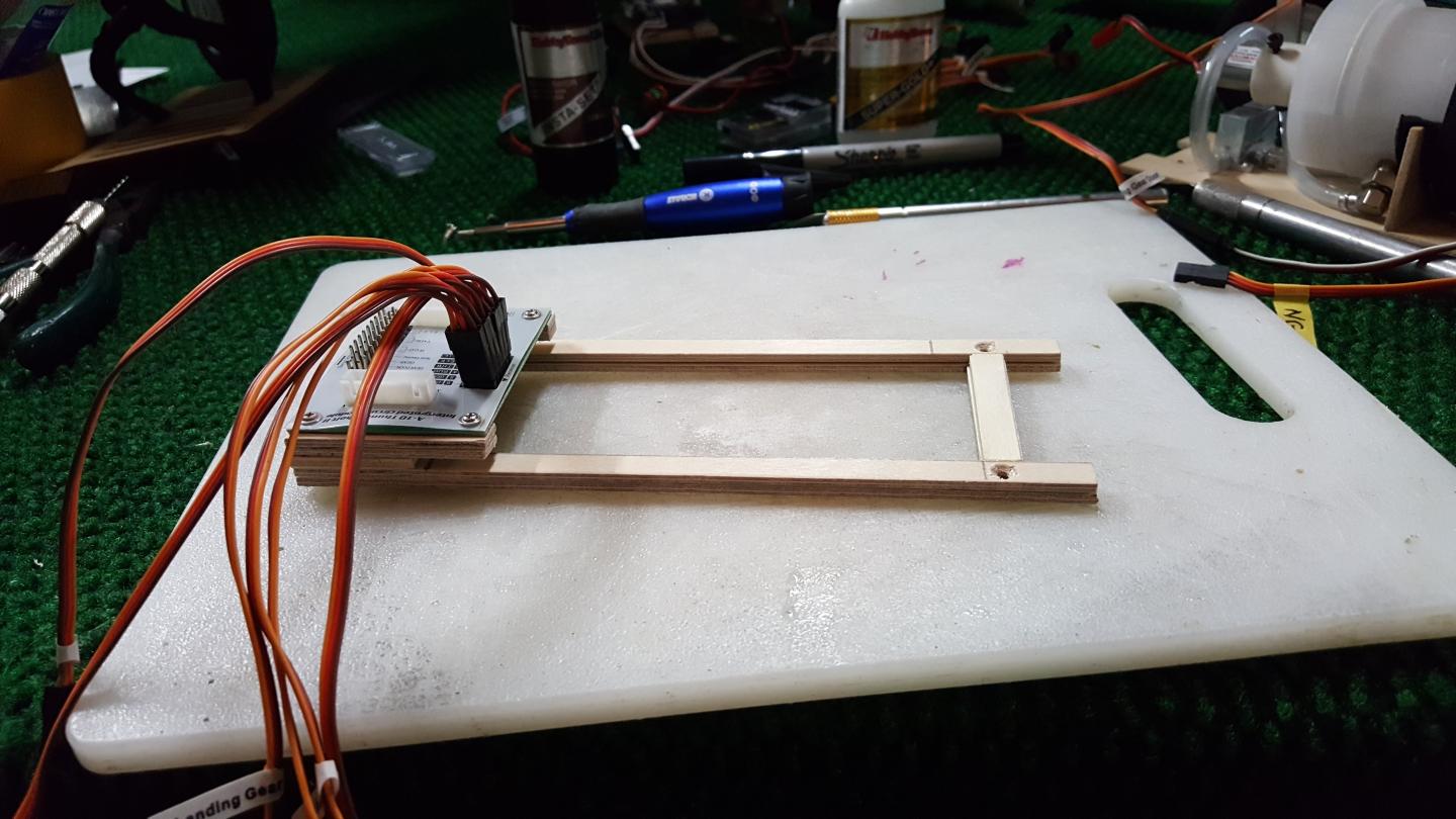

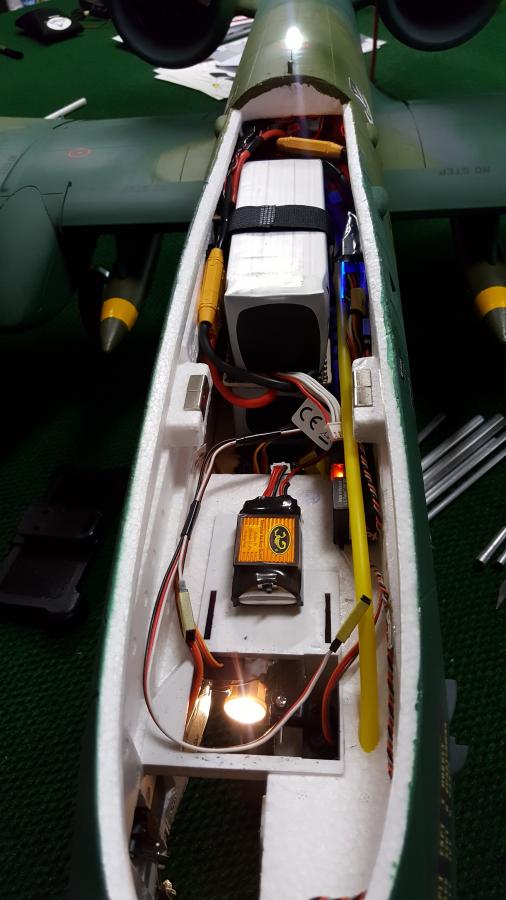

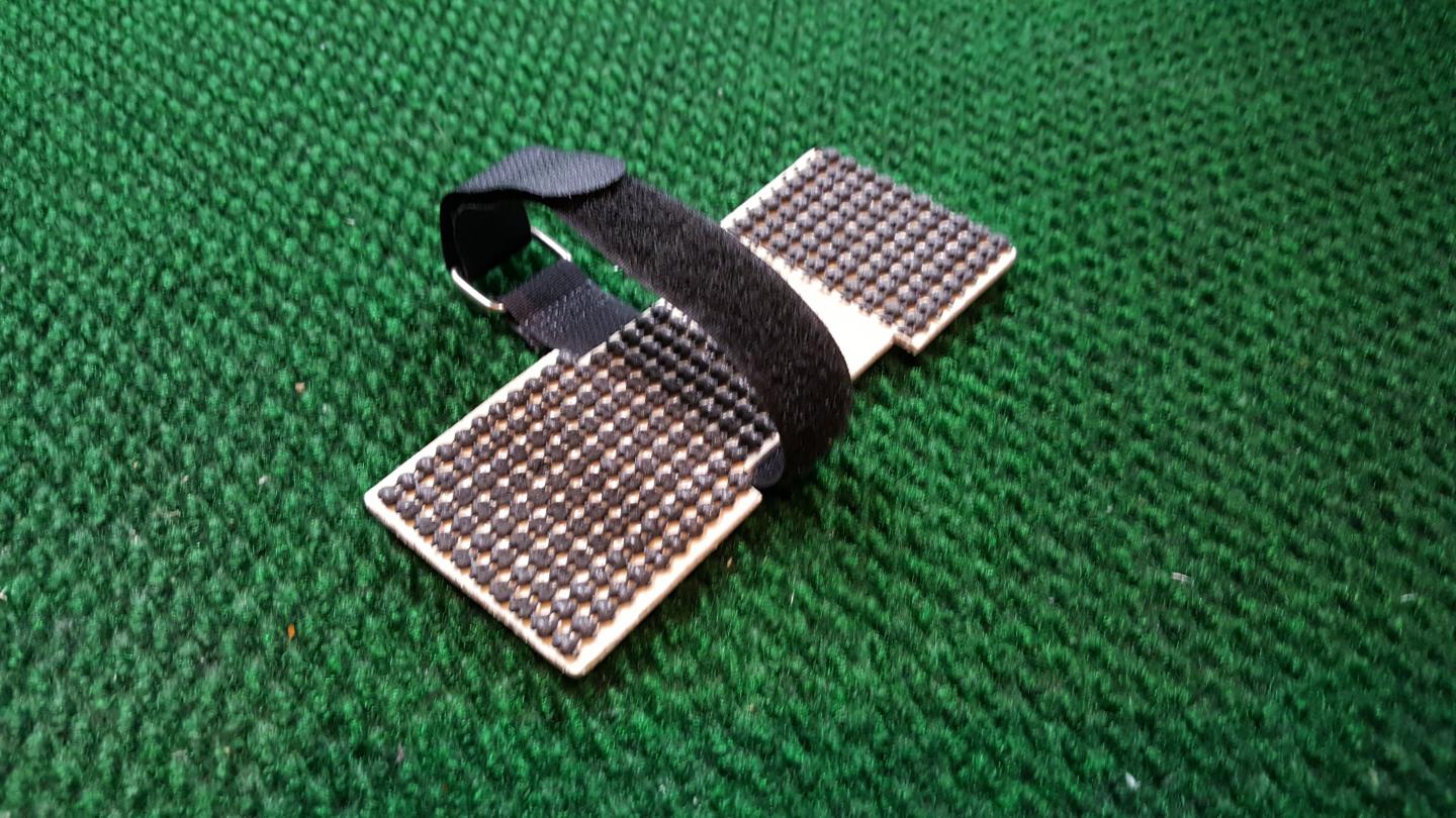

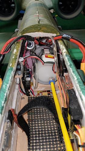

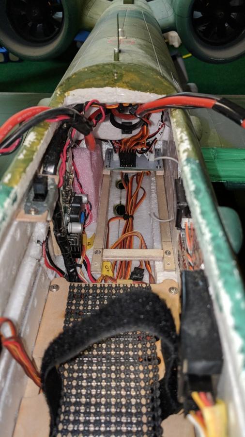

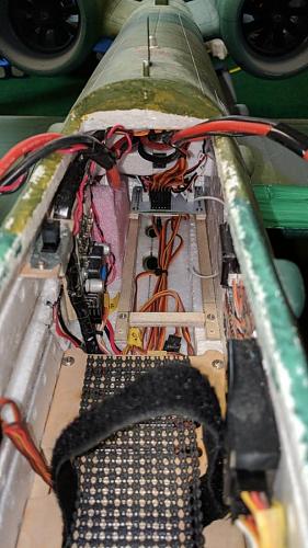

                                RCjetdude did u have to remove the control board then to fit your batteries & all your other extras. If so where did mount it. Absolutely amazing job on your A10 by the way
                                Cheers
                                  #8596
                                  Cheers

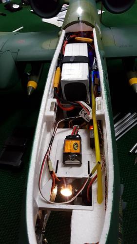

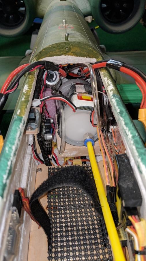

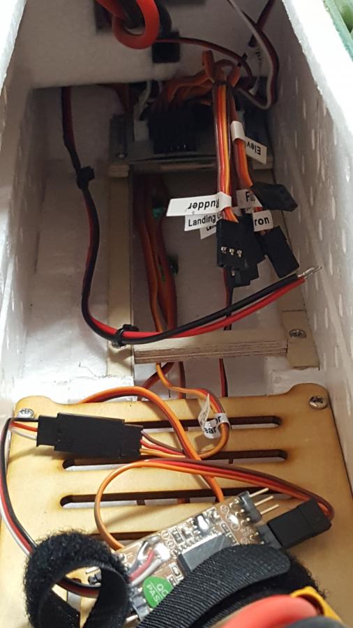

                                  Oh yes...it was a PITA but it worked.

                                    Awesome pics RCJetdude thx..how did u balance it..wheels down right side up..or wheels up..upside down
                                      #8598
                                      Wheels down inverted index fingers on the plastic wing roots is how I do mine.
