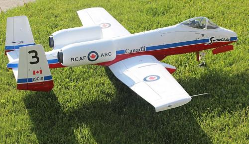

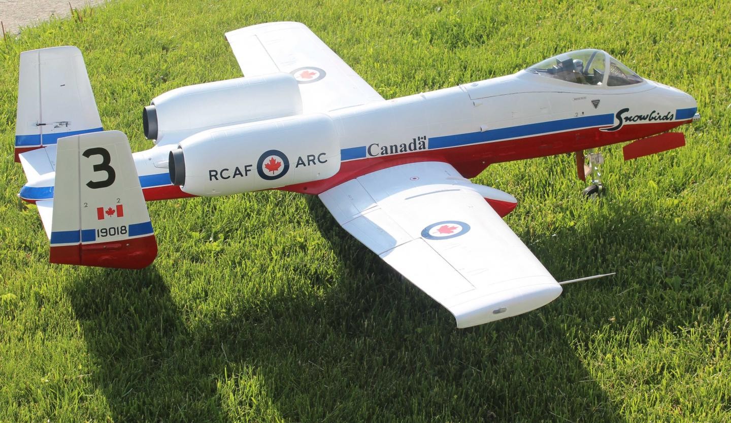

                          #8392
                          Originally posted by t33jetman
                          Spammer, that is a very nice Canadian paint job , I like it !
ID:	136666Click image for larger version
                          Thanks t33jetman! Saw your bird, and figured if one could be done in white, certainly there was room for two....??? Will say though, never want to paint white on a bird this size again! Learned a valuable lesson of using alcohol markers to make a pattern, and having them bleed through a number of coats of white paint...will try pencil if there is a next time.
