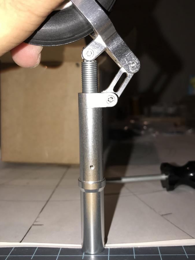

    It shouldn't do that. It should be able to full collapse and spring right back, even with the weight of the plane on it. There should already be a spring inside the cylinder. Check to see if there is one in there. When you compress it by hand, does it feel "sticky"? Something is binding it. I suggest you use a drop or two of machine oil or 3in1 oil and work it into the sliding plunger part. Also put some oil on those links that need to rotate on the pins. Also check to make sure there is no screw on the side of the cylinder that might be screwed in too much and it's touching the piston that goes in and out. I don't have mine handy to know if there is a screw or not. I'm guessing based on another trailing link suspension where there is a screw that goes into the side of the cylinder. Once loosened a bit, the piston goes in and out freely. If there is a screw, put it back in with some FoamTac on the threads so it won't fall out.
    It feels like... once compressed to a certain point it kinda stays holds its angle in a way but will eventually return. Yes it kinda sticks and by no means a smooth operation. I guess I’ll take her apart and see what’s really going on in side tomorrow. Not a good thing after 4 flights though.

        Helmsman (Bill), I think the problem is there is very little of the inner tube inside the outer when the strut is fully extended, hence the binding. I've had mine completely apart, lubed it etc. and I'm afraid it's just not designed right. I'm going to take it apart again and shorten the spring a couple of coils so the inner tube is engaged a little more.:Angry:

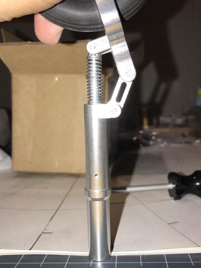

          Your right about the design. Here’s what I just did. I added a compression spring. Then I used marvel oil on all hinges and piston.
          Hell its a lot smoother and you won’t have to do the rear gear door mod because of the added spring. It doesn’t look scale but hey it works!
