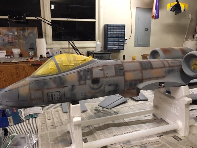

                  #8068
                  Click image for larger version  Name:	 Views:	2 Size:	77.7 KB ID:	130654
                  Originally posted by Elbee
                  Hey Ya'all, I am prepped to begin painting colors this week on the personalized Peanut A-10 and I had a thought. I will be using Callie Graphics pressure sensitive decals and some of the OEM waterslide decals, so my thought is to paint with gloss Home Depot matched paints as I cannot find all the FS #s in locally available Hobby Master acrylics and finish with a matte clear coat. Am I on the right track here? Best, Elbee
                  Here's my thoughts, but I took a different path than others. I used Home Depot paint to color match samples of the exact FS numbers (Testor's). I didn't enjoy using house paint in my airbrush but I got it done. I was covering undercoats of darker shades to give a 3-D effect...a technique I had never done before but learned about from Alpha. The net result was I was too generous on the application of the color coat, and lost a lot of the potential benefit from the shading underneath. Also, the FS shades of light and dark ghost were too similar and I wasn't happy with the differentiation. I took many photos while at the Reno Air Show (see pic) and in real life, it appeared there was a lot more difference.
                  So I'm now re-doing the under-shading and have custom mixed my own colors. I'll finish with a wash to give some more dirt and will airbrush grease prints. Here are some shots from my first effort and where I'm at now. Rob

                          • 768
                          • Northern Illinois
                          #8072
                          boy, do I feel stupid right now, haha.
                            • 4819
                            #8073
                            I see where you're headed. Looks good and I will learn from your work. Thanks. Best, LB
