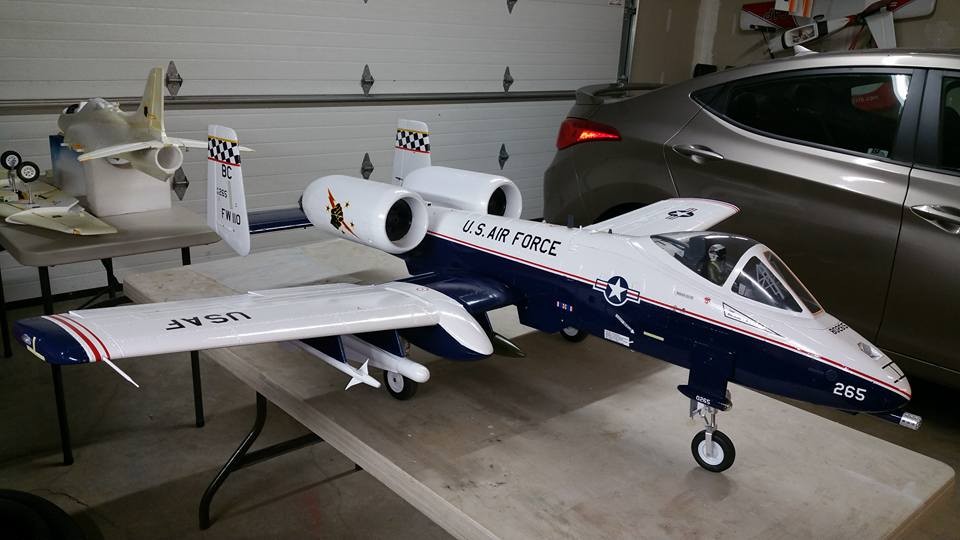

    Click image for larger version  Name:	 Views:	1 Size:	93.1 KB ID:	134291 One year old and still going strong with original equipment. I love this plane.
        I remember when you first got her finished after the release...it's a classic look and really nicely done! Rob
          Very Nice!

            #8225
            Yeah that's an awesome scheme t33, I also remember when you first posted it ages ago, and it still looks sweet. Really nice mate

              Thanks shorty and Woody.
              I'm busy with the new FW F-4 paint job now can't wait to finish this one.

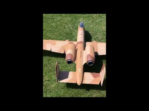

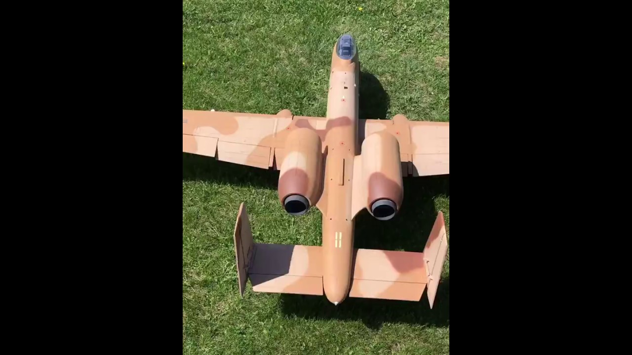

                                  Ok this was my fourth flight and I have the trailing link gear and my question is, why does the front gear collapse and stay collapsed? Watch 3-4 sec into take off it drops and stays! It did the same on my first flight but not as long.
                                  I am thinking that a compression spring is going to have be inserted on the strut or a piece of fuel line so it doesn’t bottom out?
                                      It shouldn't do that. It should be able to full collapse and spring right back, even with the weight of the plane on it. There should already be a spring inside the cylinder. Check to see if there is one in there. When you compress it by hand, does it feel "sticky"? Something is binding it. I suggest you use a drop or two of machine oil or 3in1 oil and work it into the sliding plunger part. Also put some oil on those links that need to rotate on the pins. Also check to make sure there is no screw on the side of the cylinder that might be screwed in too much and it's touching the piston that goes in and out. I don't have mine handy to know if there is a screw or not. I'm guessing based on another trailing link suspension where there is a screw that goes into the side of the cylinder. Once loosened a bit, the piston goes in and out freely. If there is a screw, put it back in with some FoamTac on the threads so it won't fall out.

                                        #8239
                                        I'm also guessing going from zero to wot with the resistance on grass might be helping push it down. (Though I'd expect that to come up after it gained speed). Try also easing up the throttle.

                                          #8240
                                          I was thinking the same Shirty at first. My first flight I didn’t film but on the take off roll out it nosed halfway through once applying more throttle.
                                          Now this clip is the second flight take off and landing. I full throttled it to see a difference and there was no prob lol.
