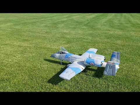

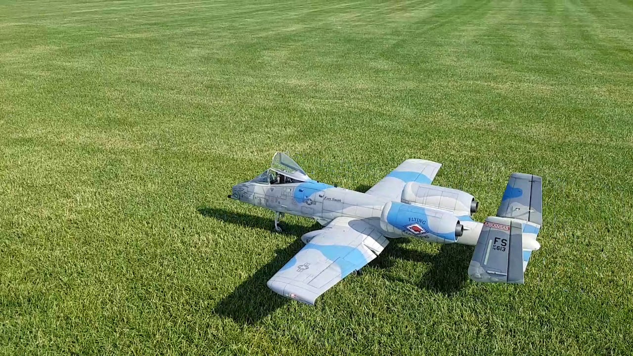

                        #8371
                        A short video of taxiing around with the canopy in operation and the nerf whistles doing their thing. :Cool:
                        Tom
                        • Pogo
                          • 452
                          • Waterford, Ontario, Canada
                          #8372
                          Well I just don't know... here's the link: https://www.youtube.com/watch?v=9RR3...ature=youtu.be
                            #8373
                            Looks and sounds great!
                            For adding videos here, click on the underlined A on the right side of the posting area, which toggles the Advanced Editor. Then in the 5th section from the right, the far right symbol is Insert Video. Click on that and you get a popup dialogue box. Then copy and paste the video URL into the box.
