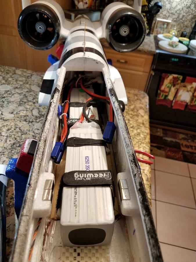

                                      Originally posted by kenbry
                                      What battery configuration are people using on this model? I was hoping to use two SMC 6S 7200/6200 or two SMC 6S 5900/5100. To my disappointment they don’t fit in the front battery area.
                                      I'm using 2 of the SMC HiV 5900's in mine and it flies outstanding with those. Moved the circuit board and stuck it to the port side fuselage wall for more room. Also upgraded the original 80mm outrunners with the 9 blade 1920 kv inrunners that originally came in my Mig 29 when I upgraded those fans to FMS fans. Flight time over 6 minutes, depending on how you fly. Definitely one of the best flying EDF's in my arsenal. CG back at least 16mm from manual- around 94mm if my memory is accurate. Lands like a dream there and stays relatively oriented level at all throttle positions, since this one is very sensitive to that since the thrust goes directly over the horizontal stabs. Too nose heavy and as you lower throttle it rises, too tail heavy just the opposite.
                                      The picture below shows my battery placement when I originally used 2 HRB 6250's. Don't have a picture with the SMC's, but have both of them about 2 inches further forward since the SMC's together are about 180 gr less in weight, which also makes it fly much better with longer flight times than with the HRB's.
