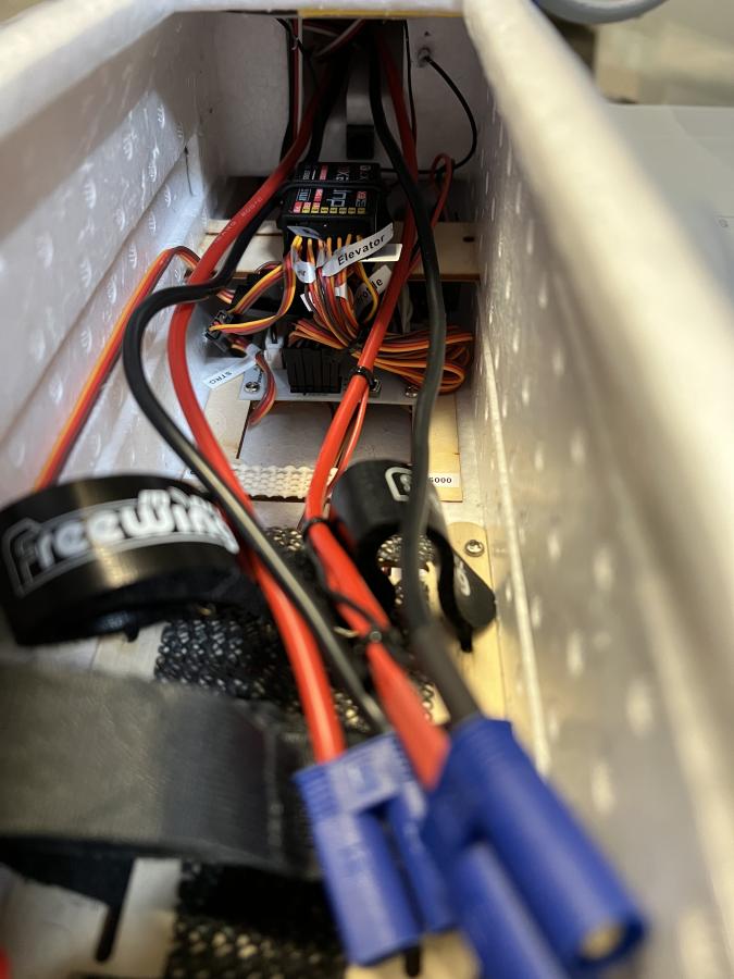

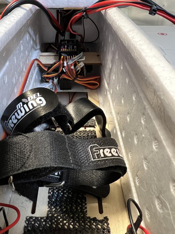

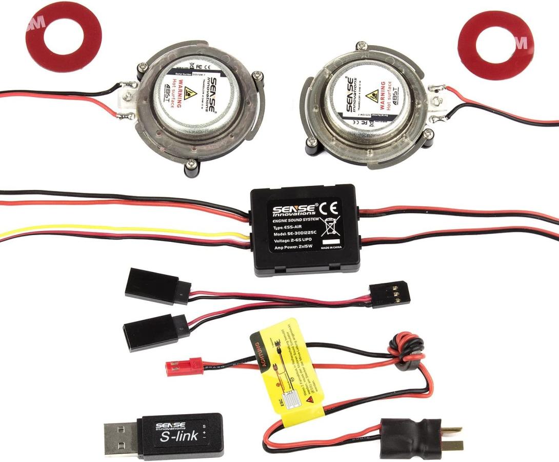

    • Very nice setup, Tolga! I'm digging the clean wiring of the sound system, receiver, and ESC. Giving me ideas
      • Originally posted by Dougcarr73 View Post
        Thanks Doug. It really worth the effort aesthetically and makes battery installation a lot easier.

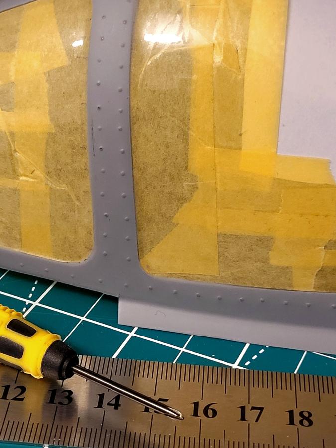

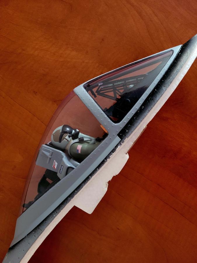

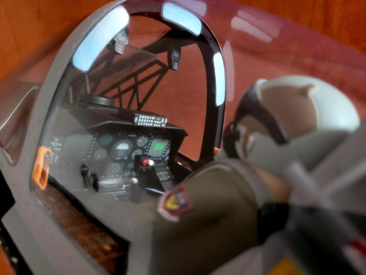

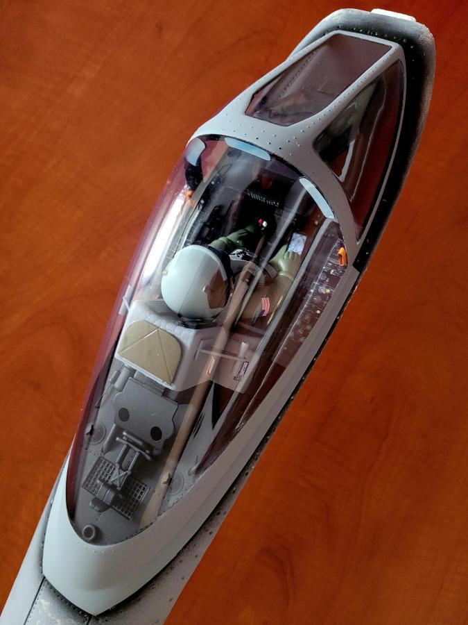

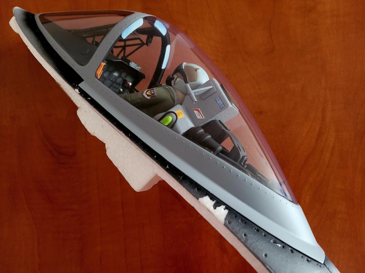

        • Cockpit is finished.
          Now it's time for the assembly of the sound simulator.​
          • Originally posted by RAFALR30 View Post
            Cockpit is finished....
            RF, stunning work, Bravo Zulu. Sir. Best, LB
