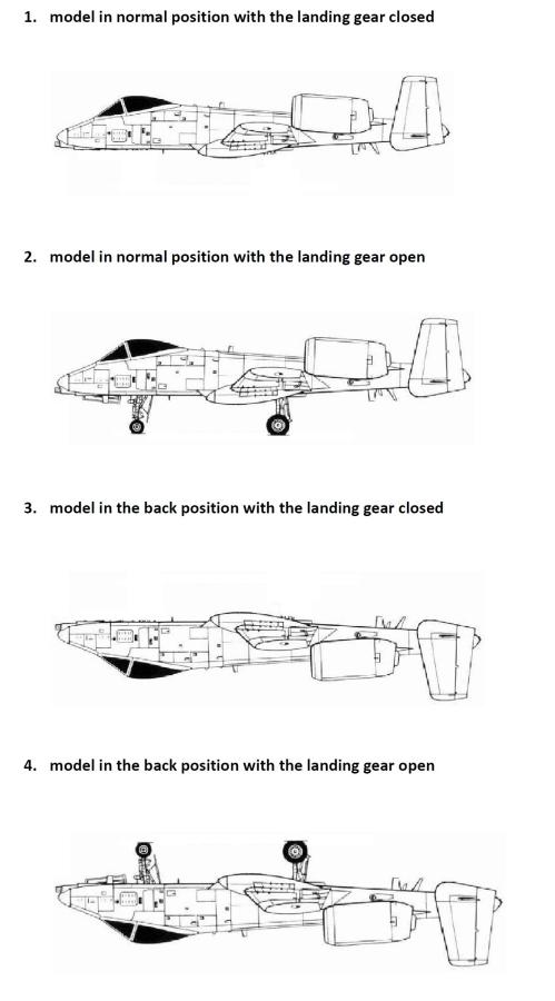

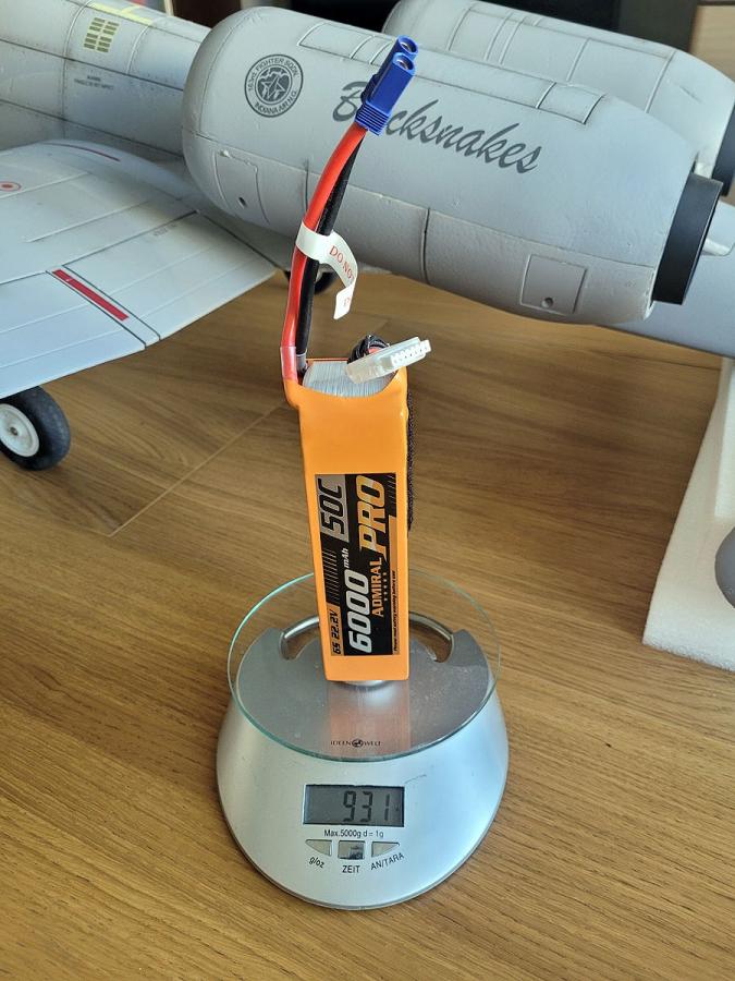

                I have big and heavy batteries (Admira Pro 6s, 6000mAh - 930g each) so I had to make new battery holders for a good CG (center of gravity).
                How do you measure the CG:
                1. model in normal position with the landing gear closed
                2. model in normal position with the landing gear open
                3. model in the back position with the landing gear closed
                4. model in the back position with the landing gear open
                I noticed that opening the landing gear made it necessary to move the battery forward almost 2cm.
                How is it in your models?

                  Nice Battery Trays, well done! First off, I assume you had a misprint in the weight of the Admiral 6000 Pros, instead of 930g each, mine weighed in at 836g each but don't use them anymore. I'm exclusively using SMC 6200's at 814g each, but that's a different story and not relevant to your question. I always balance my aircraft upside down, gear down (assume that's #4 of your options referred to as "back" position, no?), but others measure gear up (and right side up) so that's a personal preference. I do it with gear down because IMO, that's when you are flying the slowest and want to "know" how it flies during take-off and landing and inverted it is much more "sensitive" on the balance poles so you can really determine the exact mm you're at.
                  With that said, I balanced mine at 92mm instead of the recommended 78mm (is that right, 78mm per the manual, or am I remembering some other EDF-either way I do remember that I'm at least 15mm further aft from recommended), which I felt was way too nose heavy and made it difficult to make nice slow landings with the nose up eliminating the possibility of the nose gear hitting first causing the dreaded "bucking bronco" that many have suffered causing a lot of damage. In doing the in-flight 45 degree test (full throttle at an up angle of 45 degrees, then go inverted and it should slowly fall back down) that's the point where it fit that profile (at 78mm fell off way too quick). Don't forget that the jet thrust on the A-10 goes directly over the horizontal stabs, so if you have it too nose heavy, which requires more up trim, the jet wash exaggerates that up pressure with more throttle and at lower throttle settings, less up effect, causing this EDF to rise and fall dependent on your throttle setting, unlike any other EDF. For me, at 92mm gear down, trimmed for level flight, it stays level at full throttle or even when cutting the throttle, which tells me it's relatively neutrally balance. At least that's my personal belief, but then I still believe in Santa, the Easter Bunny and honest politicians! :lying_face:

                      Thank you for your practical advice. The battery weight given on the manufacturer's website is 910 g and my weight showed 931 g. For full understanding, I am posting a graphic about CG.

                        For low wing aircraft, use #4. For high wing, use #2. You always want to measure CG in landing configuration as that is when your model is most sensitive to small changes.
                        As for the CG of this model, most of us have found that 85-90mm is much better.

                          Checking balance on the ground is a reference point. You should adjust the CG forward or back depending on how it flies. MY WAY, and there is no right or wrong no matter how opinionated people are, is to do a low wing upside down and a high wing right side up. I do it with gear extended but that's a hold over from wet fuel days.
                          That said I usually do a quick check once the balance point has been determined in flight by either a quick lift with it sitting on the bench right side up and on it's gear or, on some planes, a tail sit test.
                            OK then, I'm referring to #4. And that is so strange about the battery weight, I have/had 16 of the Admiral 6000 Pros and they all weighed between 830-836 gr. They must have changed their chemistry in the last year and you are correct, the website lists it closer to 910 g. Noticed the 5000's also went in weight from 702 g to 746 g. Thanks for pointing that out. But I still have to say that at 931 g each for the 6000's, that's way too heavy for that mah of a battery. The SMC 6200's are 814 g each and I guarantee you the IR values are at least as low if not lower than the Admirals. For the A-10 (and my Mig29), that's an extra 234 g of weight, not acceptable IMO.

                              I have been using RT 6250's (label says 35C) in my A10 for several years and they are 800gms each. I also have some HRB 6000's (label 50C) that weight 830gms each. Both brands test at around 30C and they perform almost identically.
                              I moved the trays back to balance at around 90, the plane flies great and I can hold the nose up easily during landing.
                              I balance gear down because I want the plane to fly correctly during takeoff and landing. The CG may change slightly when the gear retracts but it has little affect with the A10. (IMO) I balance all of my planes in this way....
                              The weight of the batteries is important (also the performance). The more weight you load into any RC plane, the harder the motors have to work and the less flight time you'll have (all things being equal). Light flies better!
                              Your Admiral 6000's are adding more than half a pound compared to what I am using- My advice is to search for batteries with the highest real (tested) C rating with the lowest weight. The holy grail. SMC's are excellent!
