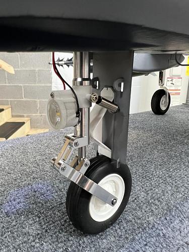

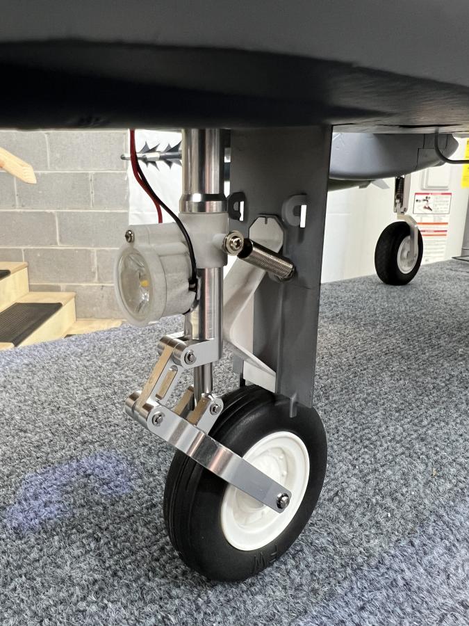

                                Hey fella’s. So I installed the trailing link nose gear and I’m noticing the wheel will easily contact the gear door. Did I miss something or install it backwards? Here’s a pic of what it looks like when I push down on it.
                                Thanks,
                                Jay​
                                Click image for larger version  Name:	20BB3881-4A26-4AEF-A2DD-045DD689A2E4.jpg Views:	0 Size:	122.1 KB ID:	358331
                                  • 8835
                                  #11237
                                  I think that's the way it goes. It's a "give and take" sort of thing. You have a couple of choices. One is to stiffen up the spring in the strut so it doesn't compress quite so much when it runs along a bumpy surface. Two is to stretch the spring on the door so the spring holds the door a bit away from the strut, yet still be short enough to pull the door fully closed when the gear is retracted.
                                  PS. One more choice. After I smacked the gear on a rough landing, the whole door broke off. I just left it off.

                                    #11238
                                    Hey Viper, thanks for those suggestions. By changing this out, it solved 1 problem but created another :dizzy_face:.
                                    I wonder if I rotated it 180 degrees if it would effectively still work?
                                    Thanks,
                                    Jay

                                      #11239
                                      Thanks,
                                      Jay
                                      It's possible. The suspension will still work but look at the way the tire is behind the vertical line of the strut. If you turn it around, the tire will be in front of the vertical line and you may find ground steering to be very twitchy. You may simply turn your plane into a "wandering minstrel". Easy enough to try. Oh, and the tire may hit the top of the wheel well if turn around. See how much clearance you've got as is and decide if there's enough if the tire was turned over.

                                        #11240
                                        Ok sounds good. I'll take a look a the clearance in the wheel well. Wonder if I should just put the stock gear back on and take my chances on my grass runway. Hmmm...
