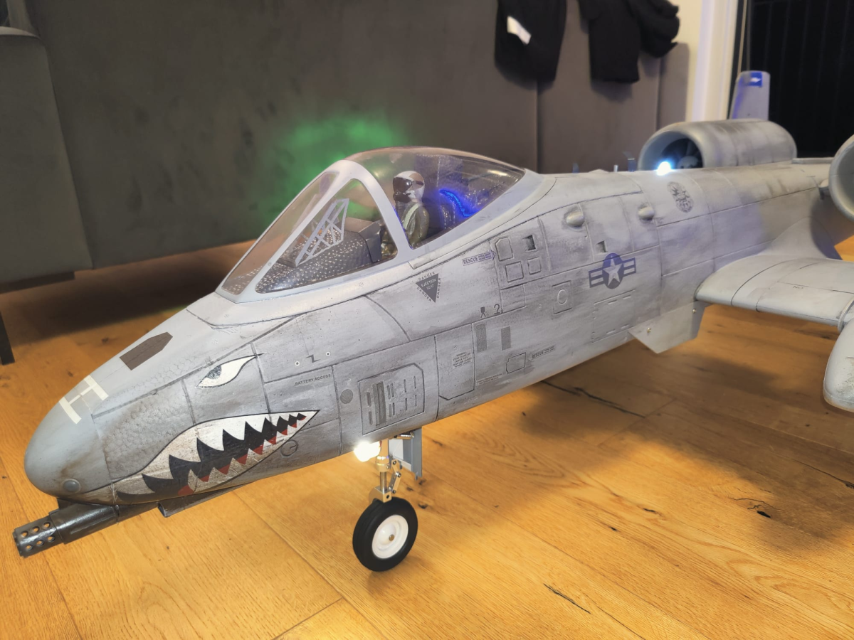

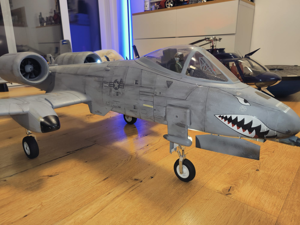

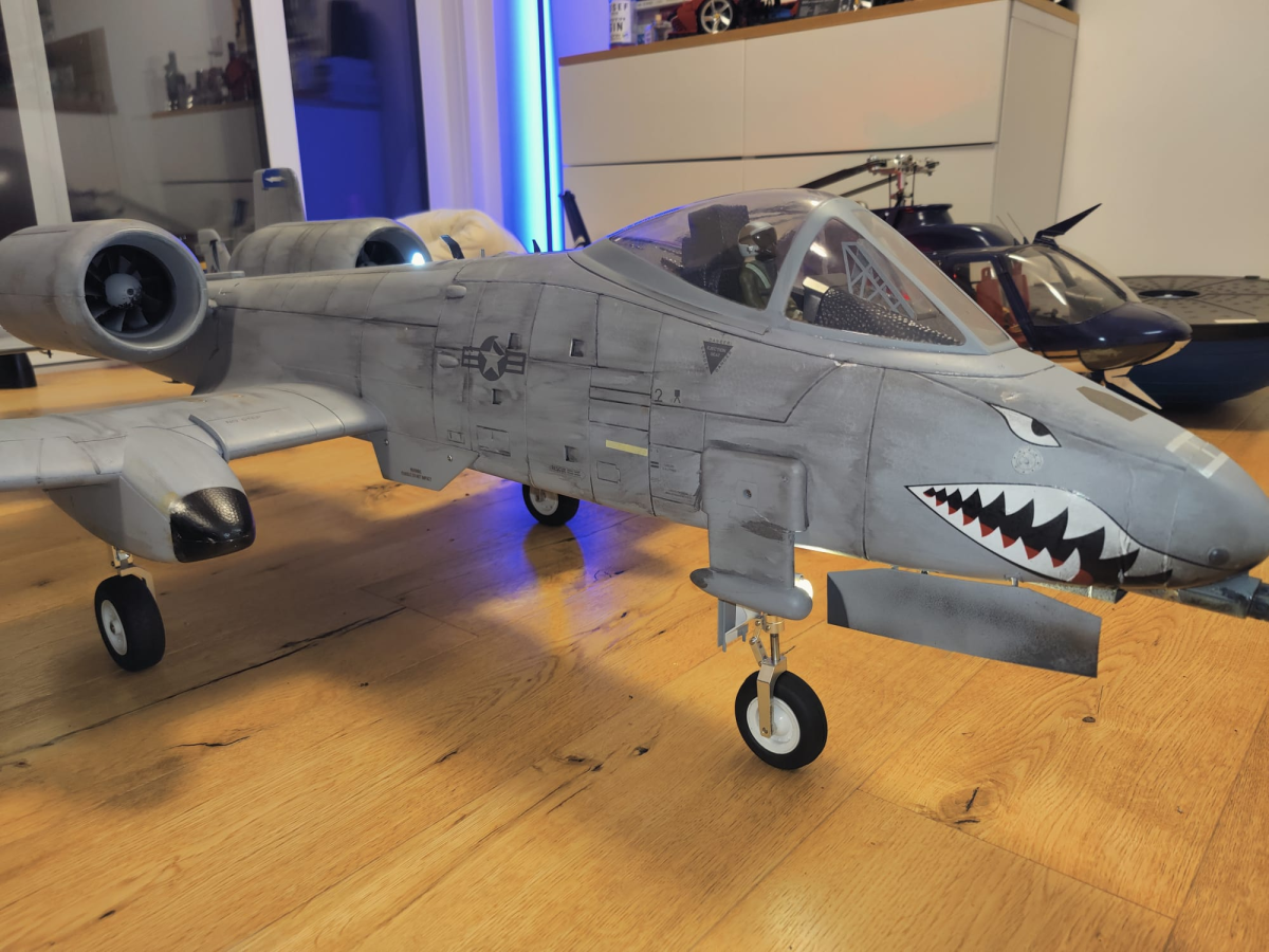

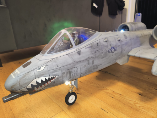

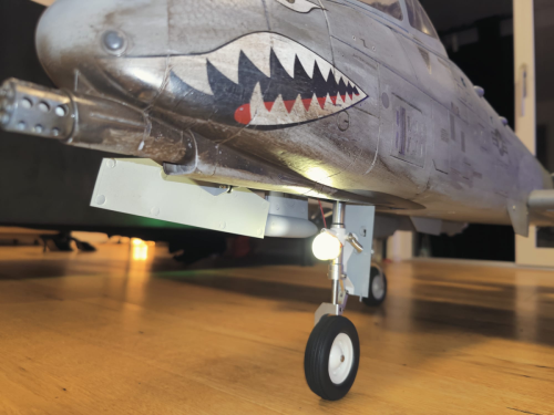

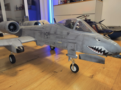

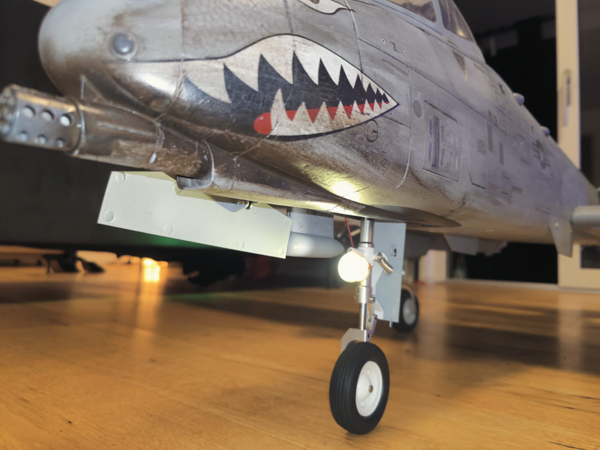

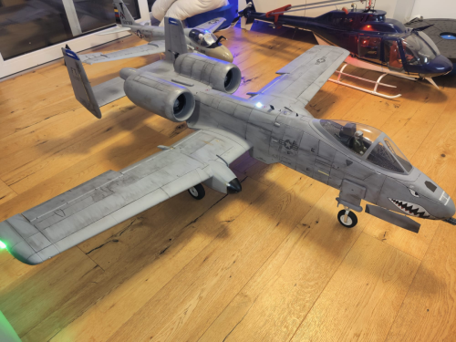

                                • Finally after flying this model for a while and being comfortable with it got around and did the weathering.
                                  Now in the process of 3D printing in LW-ASA some high quality armament for the baby :)
                                  I love doing a nice wide turn into a long final approach maintaining a nice flare for a perfect landing :D
                                  Question: Did anybody manage to replace the led's on the model?
                                  On my scale helicopter builds and composite plane builds I am using a UniLight light system with very strong leds that are even well visible at daytime and look Fabolous in the evening.
                                  I am wondering how much effort would be to redo the leds?

                                  • Originally posted by mkudzia View Post
                                    which ones are LED ones and if they are on seperate ground?​​​
                                    MK, First, may I say Welcome to "The Squawk". Great to have you onboard, Sir.
                                    Secondly, It has been a while since I had mine apart, but if you'll look at the wing root, there's a plastic connector for the wing to fuselage electrics.
                                    It will unscrew from the plastic holder. Remove the Plastic holder and look at the Connectors.
                                    Any two (2) wire lead that is connected is an LED light.
                                    Hope this helps.
                                    Best, LB

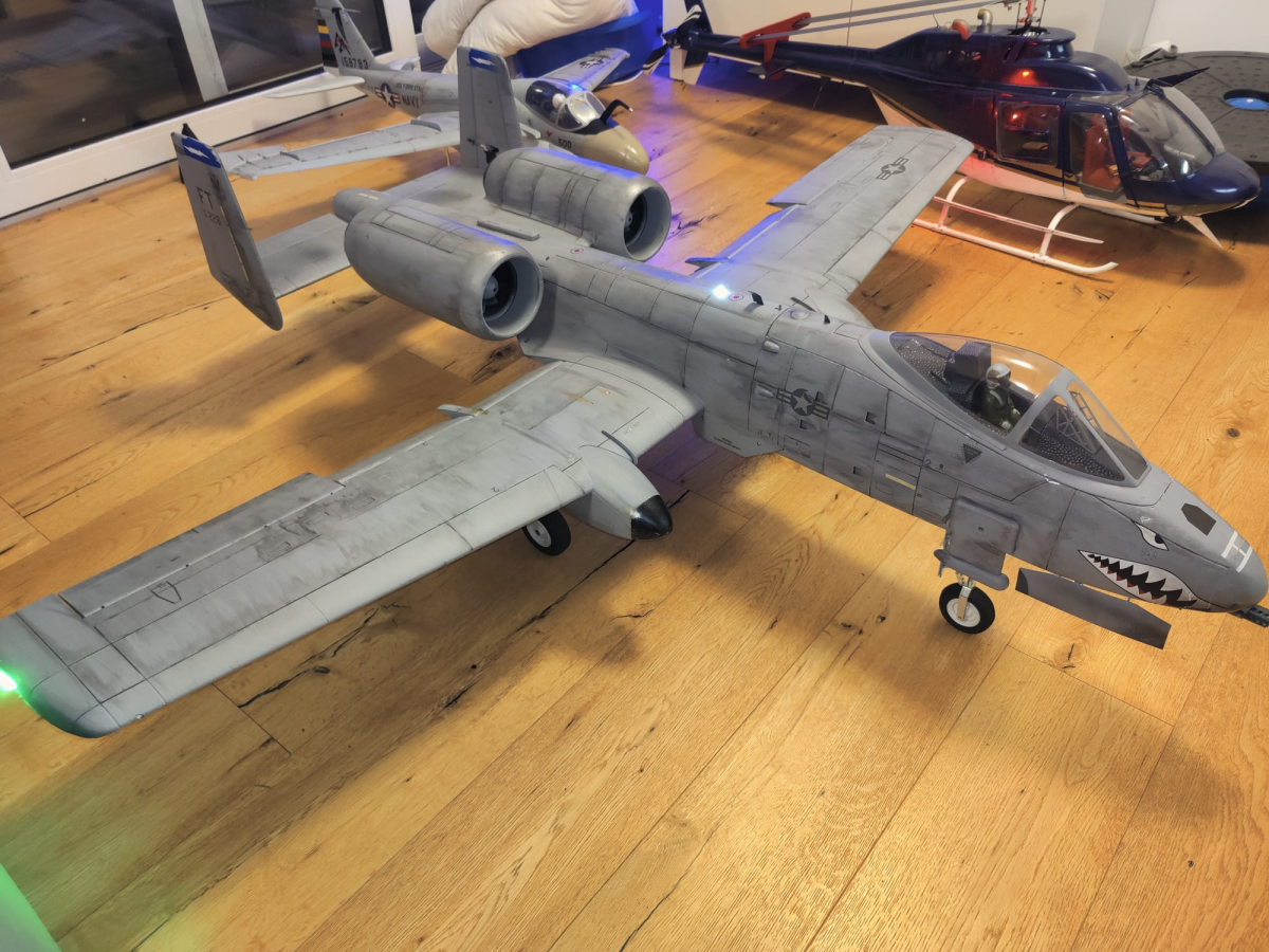

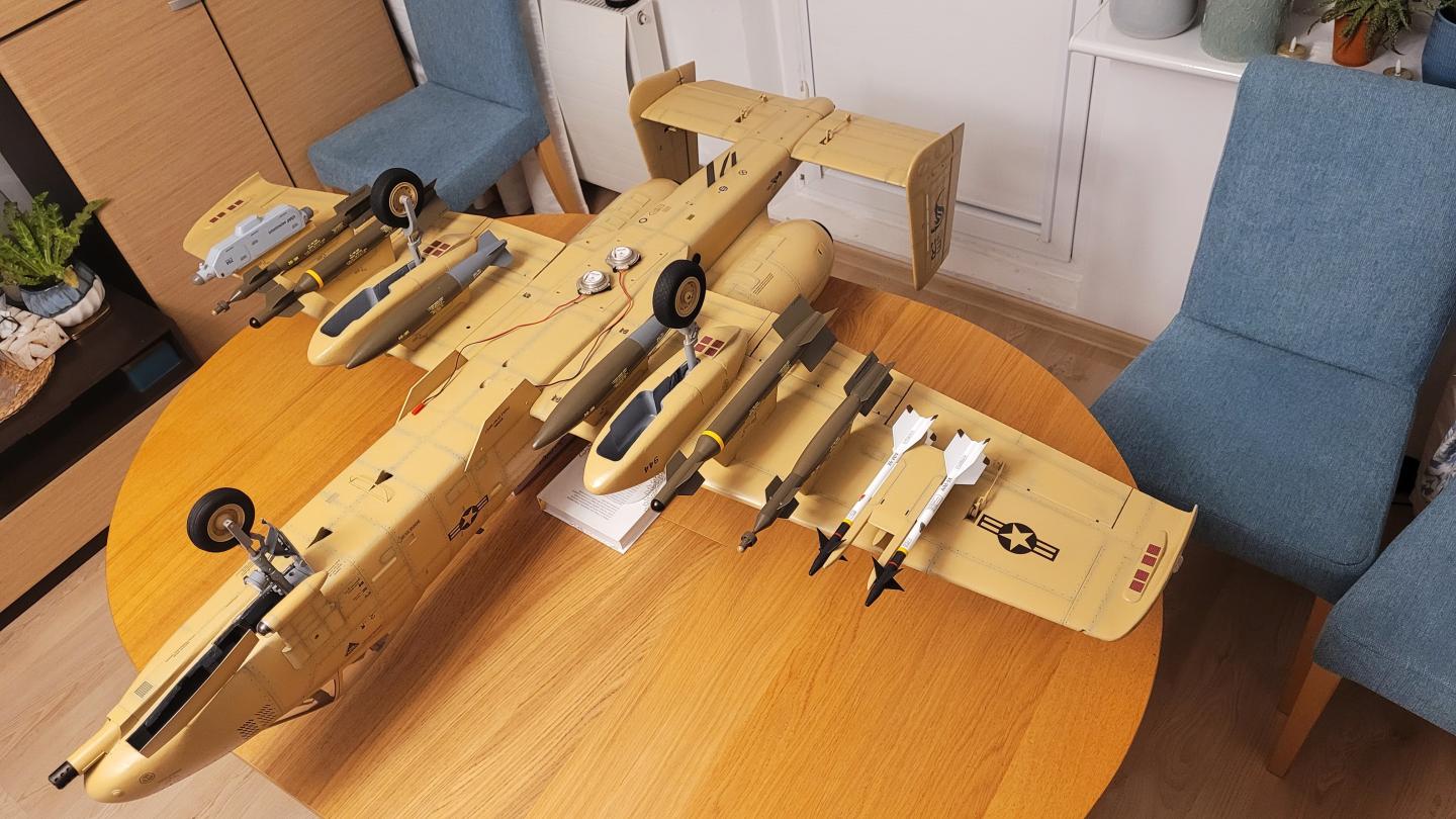

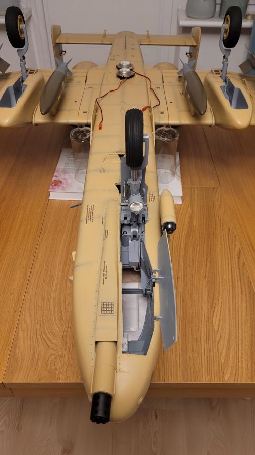

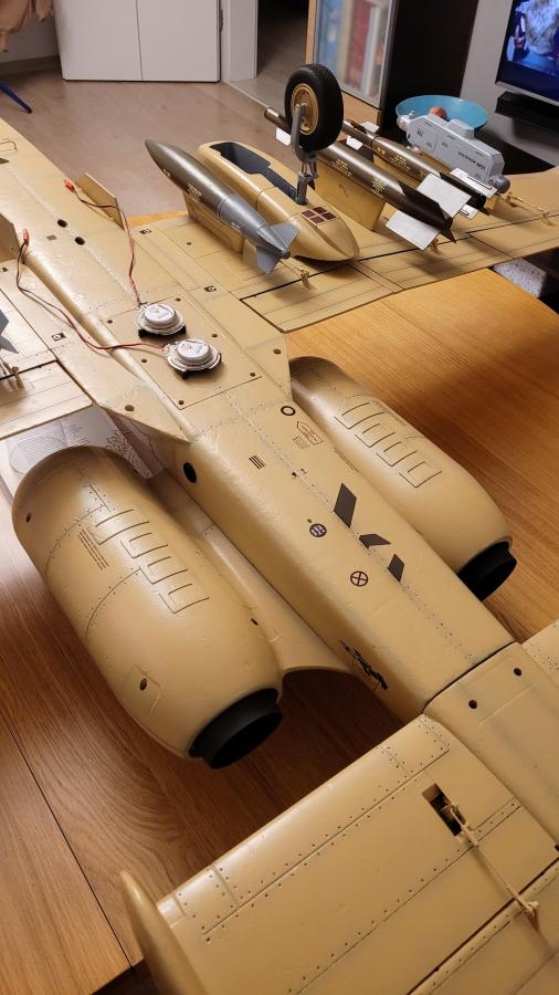

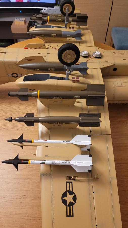

                                    • Time to balance the model - to mount the speakers in the right place. Imagine that after disassembling the armament, the CG remains in the same place - applause for the manufacturer for the thoughtful placement of the pylons. There will be the sound of engines and cannon brrrttt :-)
                                      • RAFALR30, Outstanding work, SIr. Beautiful paint and realistic ordinance. Best, LB
                                        • Work completed .
                                          RTF weight 7kg - 7.4kg depending on weapon (3D print) configuration.​
