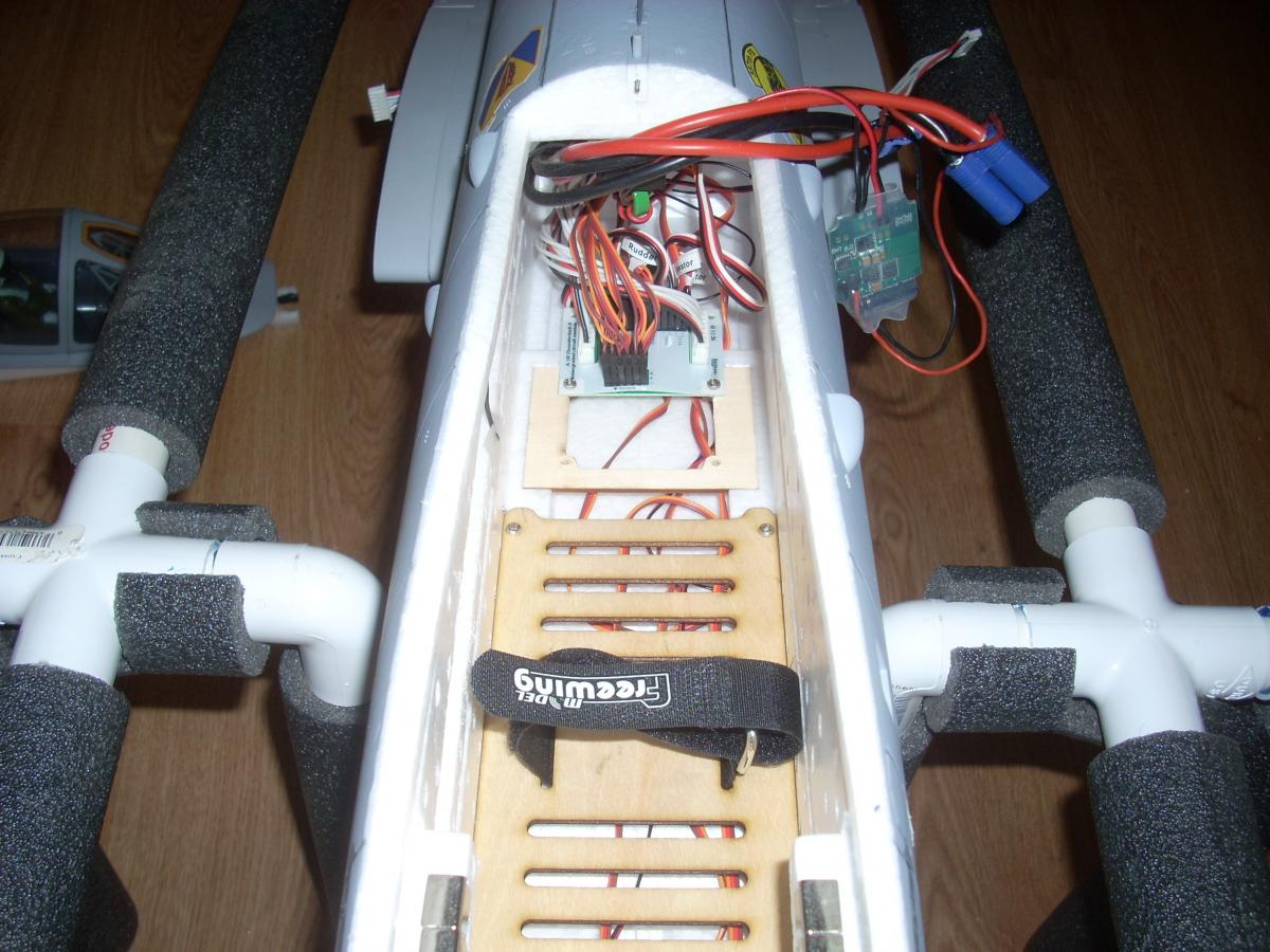

                              Given that I'm still a bit green, I'm trying to keep things as simple as possible by having my aileron and elevator dual rate linked on the same switch. I'm running an ix12. I hear you that the ail throws are insane. I've measured them and set them per the manual, so I was thinking of setting my base/standard setting for ail/ele to 60/90. I'm going on the assumption here that this big bird needs all the elevator throws you can give it. Then my higher rate will be 75/100 for the second switch position. I will take-off, trim, and land in the base 60/90 throws to start with. Does this seem solid/reasonable? Did you need to mix in any elevator with the flaps deployed at either half or full?
                              Would also appreciate if someone with the HRB 6000 batteries could post a picture showing how you have your batteries set. I can't really get the canopy closed no matter what I try. Did you carve foam?

                                I have the opposite experience than you regarding the rates on the AIL and ELE. On my A-10, I find I need much higher throws on the AIL to make it roll easily due it being such a big, heavy plane. I also find that the ELE is very sensitive, especially during landing that I need to use a very low throw or it becomes a roller coaster ride coming in. However, I do need a higher ELE throw to rotate on take off.
                                I can't say about the HRB 6000. If it's anything like my 5000mah Turnigy Heavy Duty or ChinaHobby Line or Revolectrix (all about the same size), I cannot close the canopy. I would have to auger out quite a bit of foam in order to close it. Hence, I don't use those batteries in favour of the much smaller Gens Ace 5000's and the first gen of Admiral 5000's. The new gen of Admiral come in a much different shape so I can't say if they'll go in and allow the canopy to close.
                                  Oh, great. I had bought them based on some people in this thread recommending them. hah. Hope someone else chimes in that has 2 large batteries in there. Someone was talking about using 8000's, so there's gotta be a way! In regard to the ail/ele, that was directed at the poster above that said the ailerons were insanely touchy. Now I'm not really sure how to set the rates. I might just leave them at 100 and chop them to 65% for the lower rates.

                                        Those 8000's are the "HobbyStars" purchased off Amazon. They are exceptionally small in dimension and weight for their claimed mah. If you go to each of those batteries' webpage, you will see the dimensions for them. The HD dimensions are 146 x 51 x 57mm (51mm being the limiting height).Those 6000 HRBs are 155x48x54mm (48mm being the limiting height). I know for a fact that the HD will not allow the canopy to close if placed on the front battery tray (over the nose retract). Since there's only a 3mm difference (and 50g difference), I can see that the HRB won't allow the canopy to close either. Now, if somehow you can place the front battery on the main floor (lower) and get the rear battery far enough to the rear, you may be able to balance, but I think that may be a trick. I've tried that with the smaller Gen Ace 5000's, with the control box unscrewed and moved way back to the rear wall and the plane is still quite tail heavy. It just seems to need one battery on the front upper tray to balance. You may have better luck than me. Of course, you can carve out a bit of foam and still have a solid canopy.
                                        Well, I was able to finagle the HRB's just so and get the canopy to close. The issue is, I may be trying to CG the plane incorrectly. Even going by the book CG, placing my to pointer fingers under the wing where that CG point is, the plane tanks HARD towards the nose. Am I supposed to CG it upside down; does it matter? Going by the stated 85-90mmCG point, the plane still drops to the nose. On a big bird like this, what's your CG checking trick? I feel like I'm not doing it right if i have those 2 giant HRB's in there pushed back as far as they can possibly go (rear battery is touching wires on control board) and it's still very nose heavy.
                                          #10400
                                          Upside down, gear extended. You want to be close to the 85-86mm mark, not the 78mm called for in the book. Also, move the wire junction board back to the two rear mounting holes so that you can shift the batteries aft a little more.
                                          Click image for larger version  Name:	DSCN5456.JPG Views:	0 Size:	143.0 KB ID:	269235
