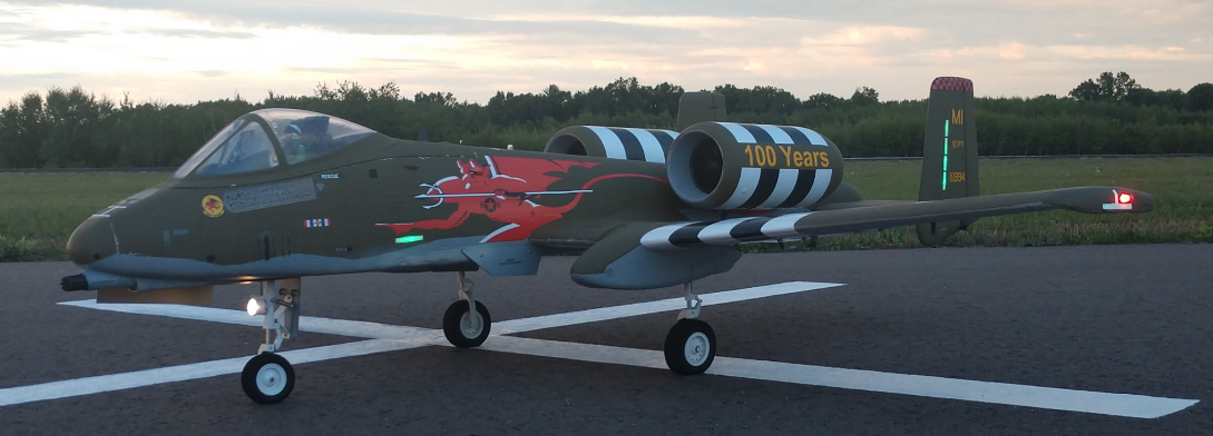

    By the way my A-10 comes in at 14lbs with all the extras. Click image for larger version
