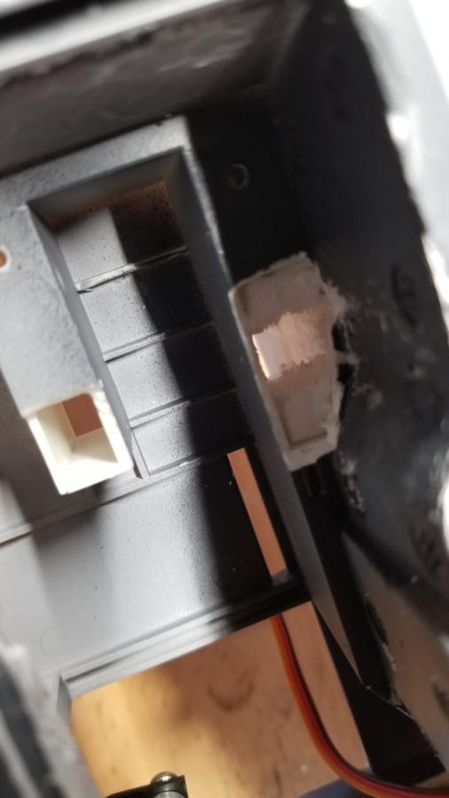

                #10487
                Well I think my first flights and landings were beginner's luck. Took her out for an early morning flight, took her a bit to get trimmed out for some reason because of the ordnance but after my timer went off I dirtied her up and brought her around for a landing. Everything looked good, speed was slow with full flaps and she settled in with my brain concentrating on the flare. Well she bounced and everything went slow motion, I said "bronco" out loud I believe and then she hit and the nose gear collapsed. Damage seems minimal, but the mounting inside the nose as well as the nose gear itself is bent. I already pulled everything out and I'm looking at replacement parts. Ugh.

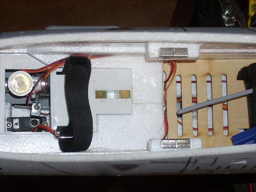

                  #10488
                  Sorry to see that Splat. We've all been there at one time or another. Just so you know, you will never get the plastic landing gear mount out of the plane to replace it. It has a lip that gets sandwiched between the foam on one side during assembly. So what you do it get some hardwood and cut it down so that it fits inside the cavities of the mount and glue it into place (insert them from the top of the mount as shown in the pic). Then you can take some longer wood screws and secure the nose retract back in. That's for the left side when looking at the mount from the bottom. If you've broken plastic on the right side, you may need to carve some of it out and glue in some more hardwood like 1/4" ply.
                  Also, take a good look at the retract housing (the black plastic of the retract unit) and make sure there are no cracks. If there are you need to replace it.

                      #10490
                      So I bought a whole new nose gear strut and retract set because this one is cracked and broke all around the mounting area so I was like um yeah a new one is needed. I also bought a whole new nose gear door set and the landing gear mounts. I was curious as how hard it was going to be to swap out the nose mount...its broken on both sides. So no one has successfully performed surgery on the nose to swap that out? If I had to adapt with a little plywood thats no problem but I was hoping I could just swap it. I got a week before the new parts get here so I'll keep researching lol.

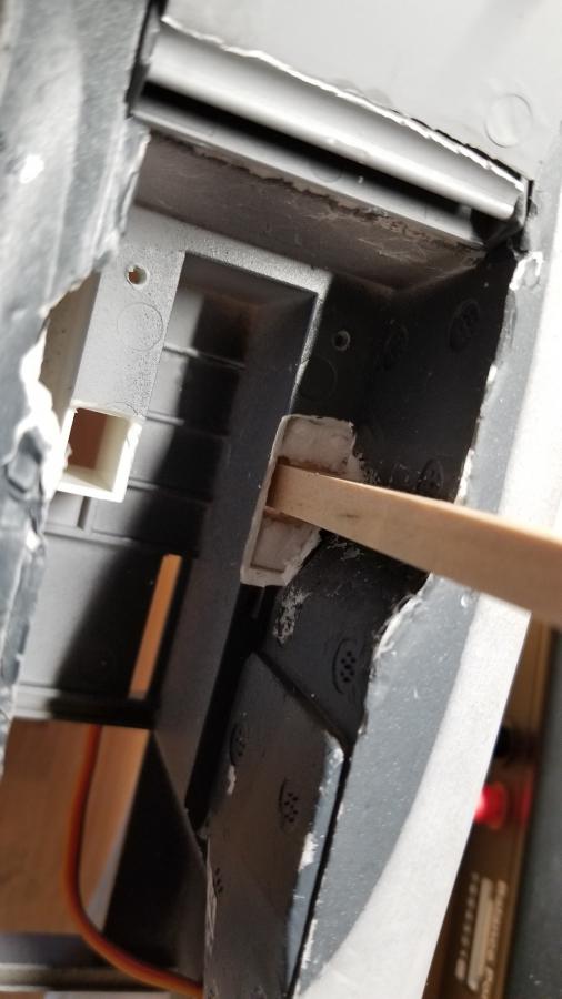

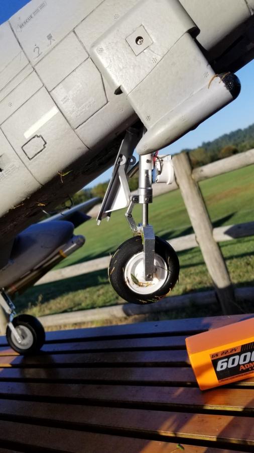

                        #10491

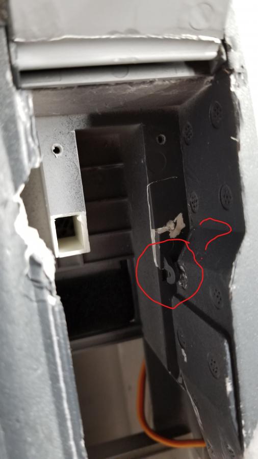

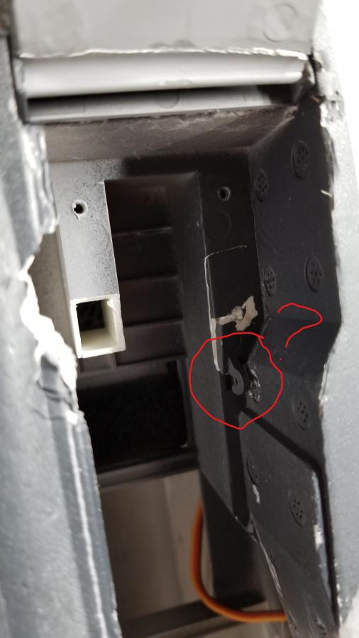

                        Spending more time looking at the damage to the nose wheel well and nose gear mounting point it doesn't look like the damage is all that severe and easily fixable if I do a little surgery. One question...anyone know what this is for? The circled part forward of the mounting screw holes.

                              #10494
                              You may be able to fix that one side. Shove some epoxy in there and push it back into place. Tap a new hole for the mount screw.
                              As for the circled hook, that was probably a spring attachment point in one phase of the design, but is not used in the production version. You can ignore it.
                              As for the landing gear plate, trust me, you won't get it out.

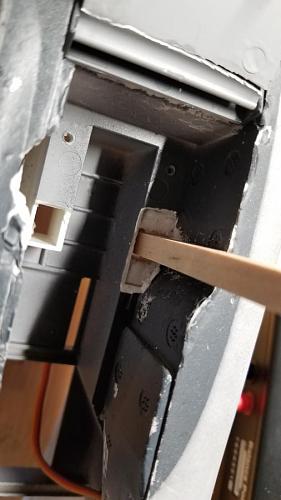

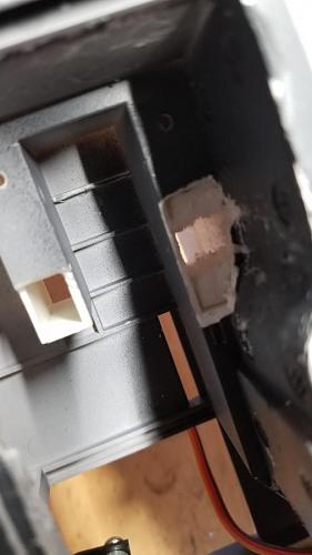

                                      #10498

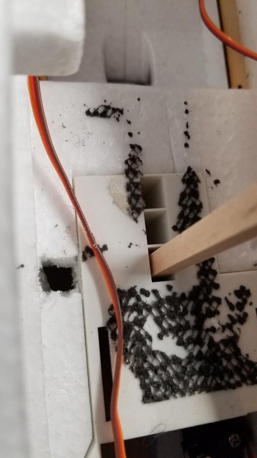

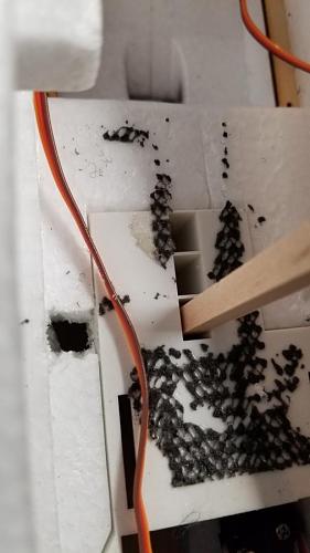

                                      She's on the O.R. table and I've started a little surgery. I'm going with Pats advice and going to epoxy two wood struts where the plastic mounts were. Will cut to size and then epoxy them in.

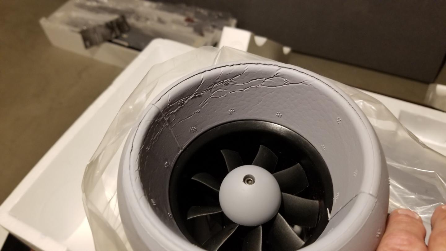

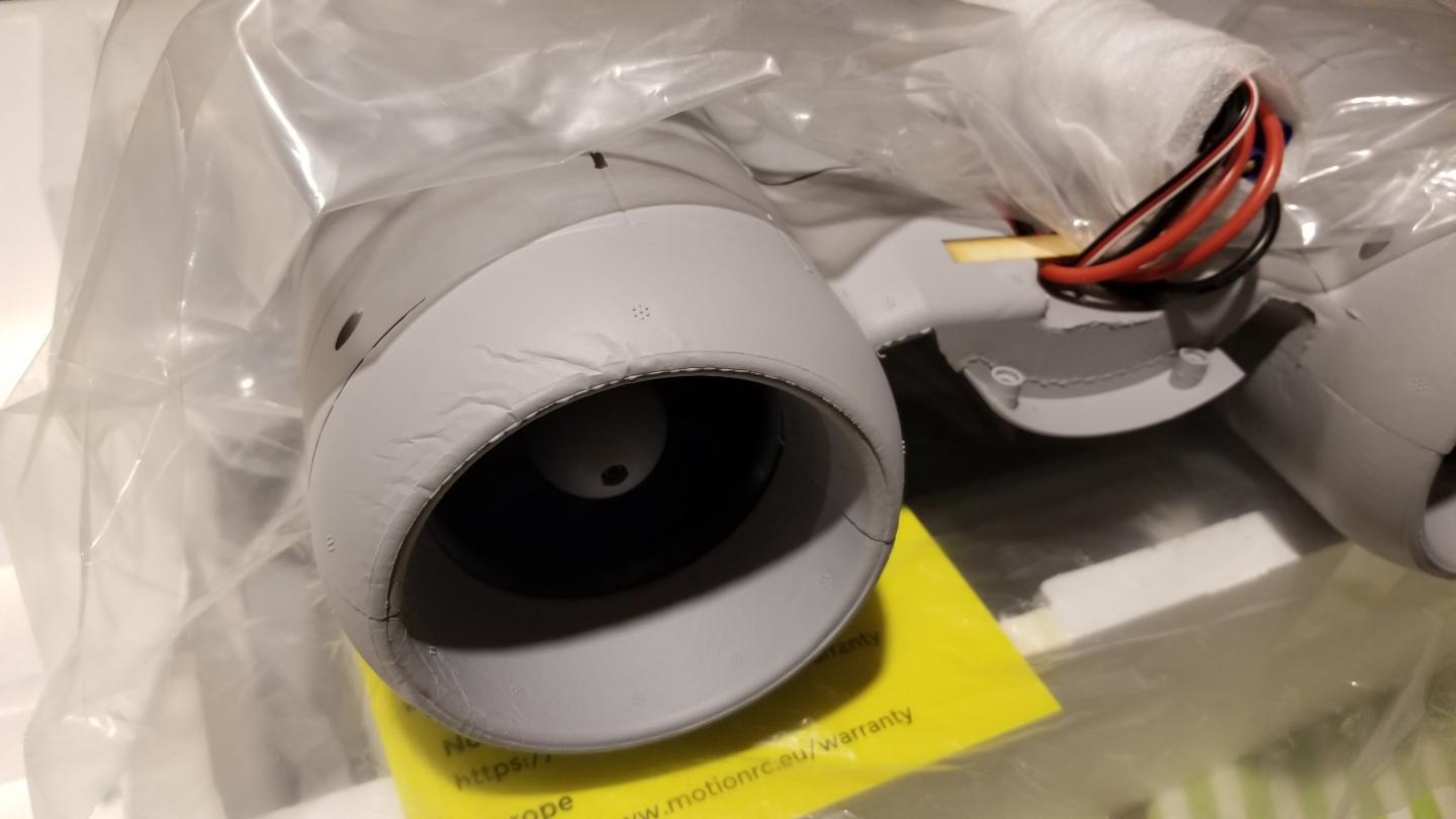

                                      • RC30Flyer
                                        • Aug 2013
                                        • 60
                                        #10499
                                        Just received my first A-10... wow she's big!!! Couple questions for the pros in here. First off, has anyone "not" glued the tail section and just used the motor pods to hold it together? The tail section goes in so tight, I was just wondering... also, I'm a little bummed, I inspected the whole aircraft before removing some items from the box to start assembly, and I noticed that the motor pods have some packing/shipping damage. Please look at photos and give me your opinion about opening a ticket with Motion to try and get this resolved. Thanks guys!!!

                                          #10500
                                          Oof that's bad. I'd be getting those replaced.
