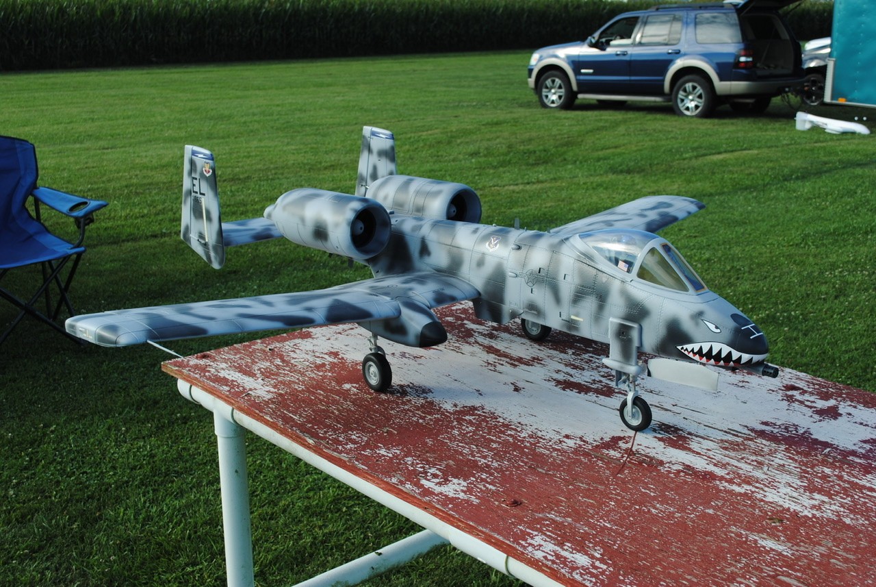

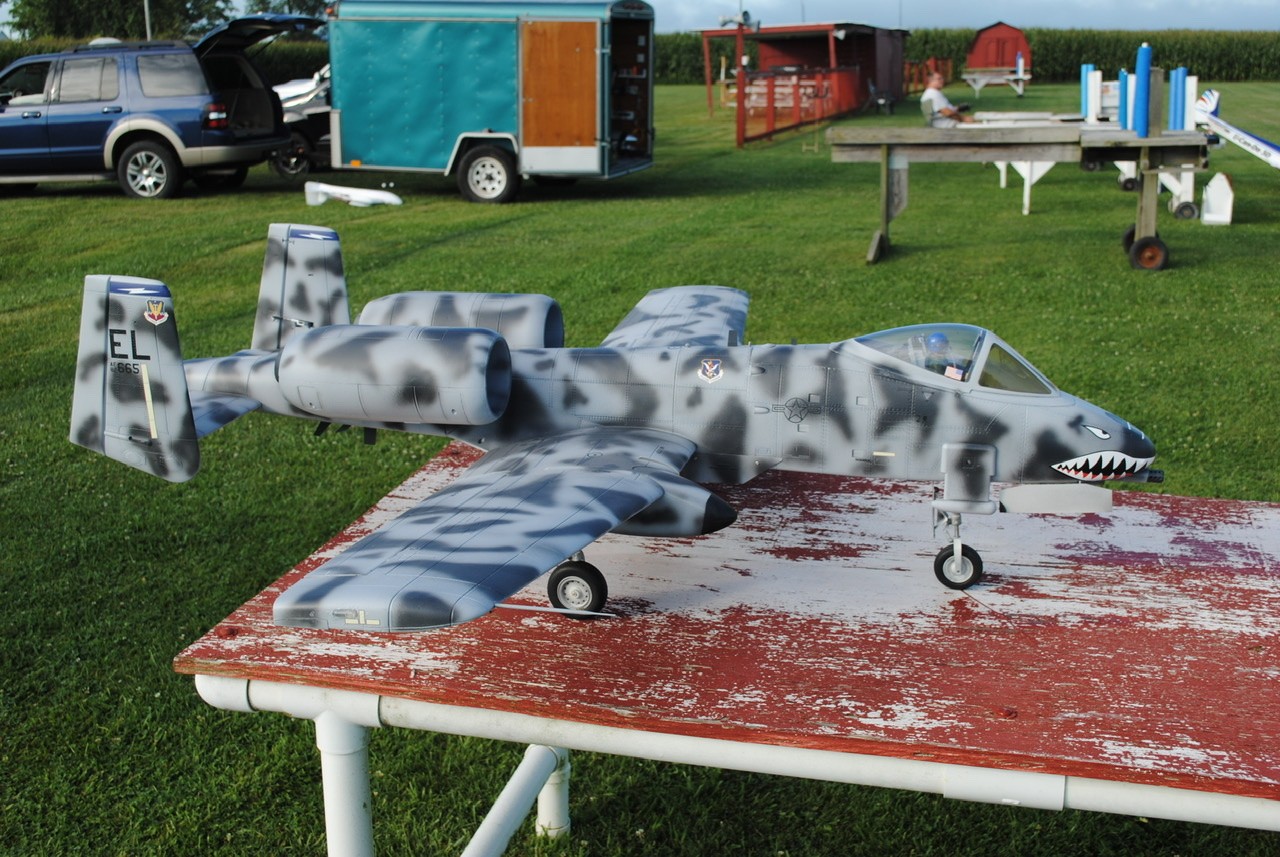

          Successful maiden today, she flew great. I had to put in 4 clicks of down trim and 5-6 clicks of aileron trim to get straight and level flight.
          I put 3 flights on it today and the landing were nice and smooth. It slowed down nicely for the landings with full flaps and settled on the mains and had a short rollout on the grass runway.
          A guy in the club shot video for me but it is pretty much useless.
          Thanks for all the tips!!
          Anthony

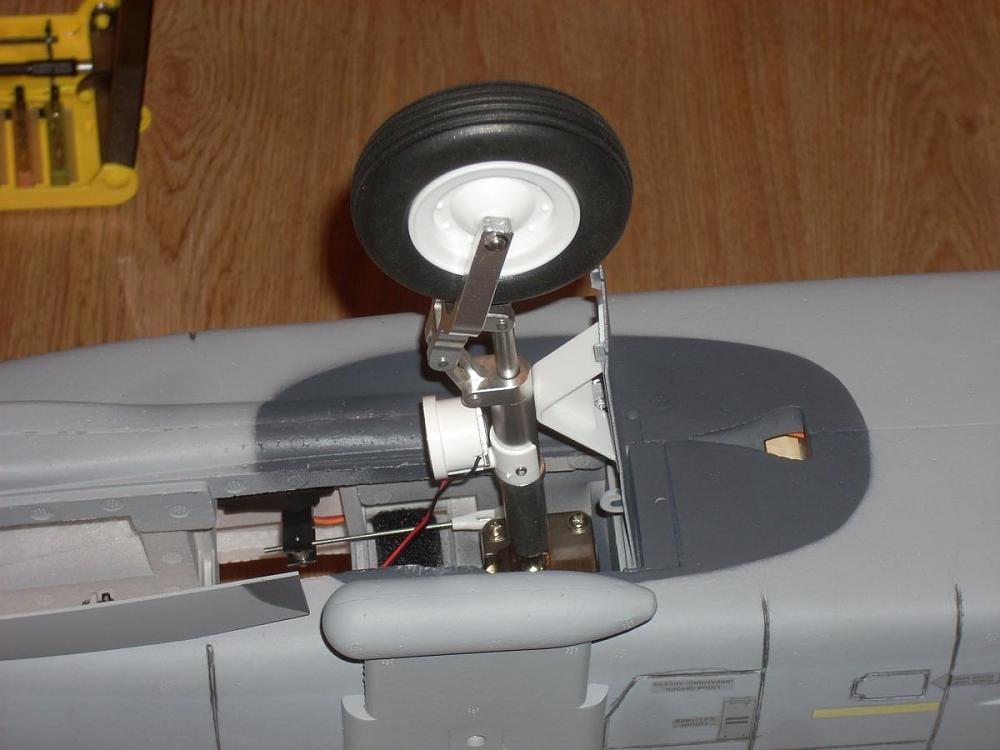

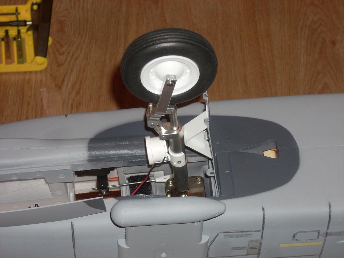

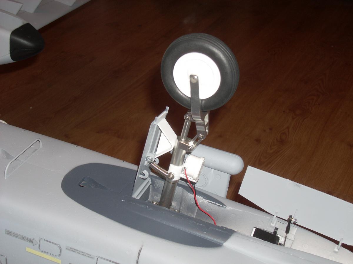

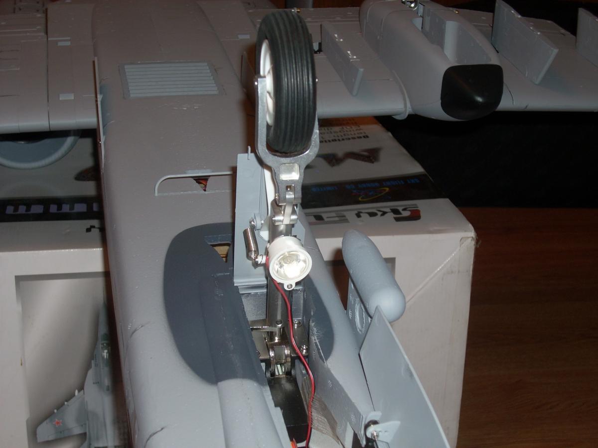

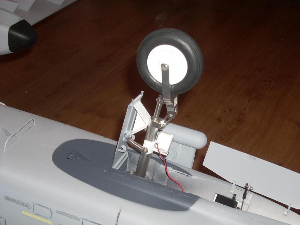

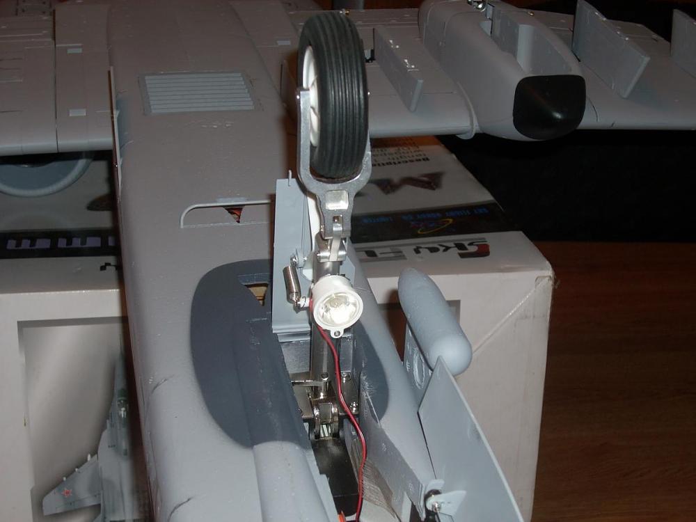

                                Has someone done a guide on replacing the nose gear? I'm stuck on the steering collar. The manual is absolutely terrible for trying to see how it is set up.
                                  #10476
                                  The important parts:
                                  1. The steering arm goes on the retract pin first. There is a set screw on only one side of it, and if you look at the pin there'll be a flat area cut into it. Slide the arm on the pin and pull the pin out as far as it will go, then tighten the set screw.
                                  2. Put the strut on the pin. It has set screws on either side. The back side of the strut aligns with the set screw on the steering arm. Tighten that set screw first, then do the one on the front.
                                  3. When you put the retract unit back onto the mount, the steering arm should be oriented to the left side of the plane (right side when upside down). The steering control rod then slides into the round metal quick link on the steering servo.
                                  4. Make sure the wire for the landing light has enough play so that when the gear is extended it doesn't bind.
                                  Hope that helps.

                                    Or maybe a picture might help?
                                    https://www.motionrc.com/products/fr...e-landing-gear
                                      #10478
                                      Forgot that I have some pics of my nose gear from when I replaced the stock strut with the upgraded trailing link one. Hope these help.
