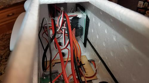

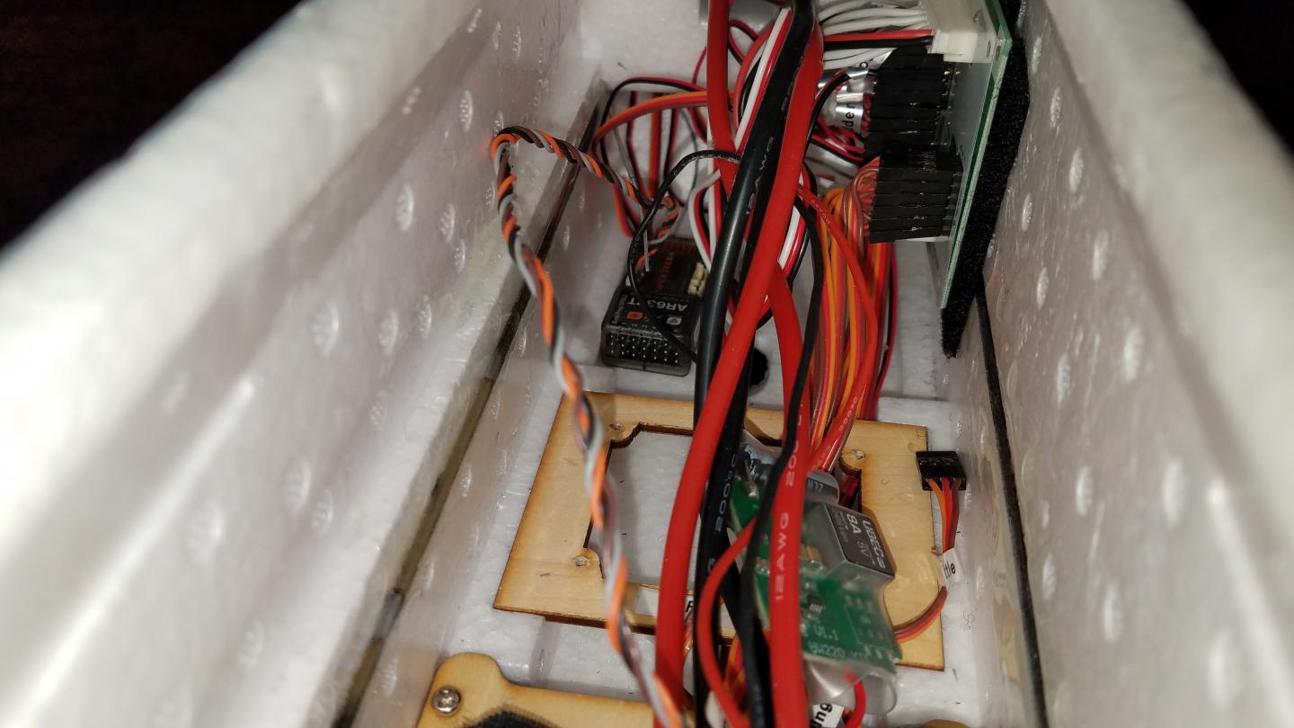

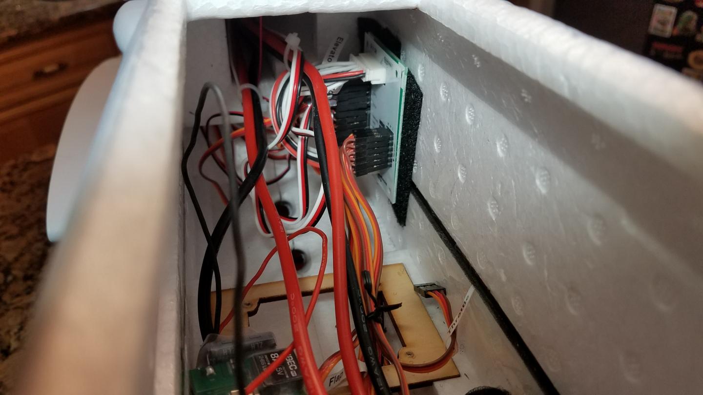

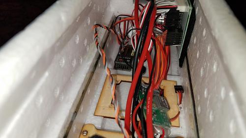

                                      Finally got my A-10 assembled to check everything out before the 30 day warranty expired. I'm sure someone (or maybe many) have posted on the what a good starting point is for elevator compensation with 32 mm and 50 mm flap deflection, but couldn't find it in reviewing some 10,000 posts a couple of times. Any help would be appreciated.
                                      I also changed the nose gear to the trailing link (I fly off grass mainly), attached RF chokes near the ESC (as recommended in the F-4 thread by GliderGuy who also lost a signal in his A-10 until he added them) and added a couple of carbon fiber tubes in the battery bay running the entire length up to the nose (as I think a few have recommended here). Also moved the circuit board and put it on the port side wall (doubt anyone else tried this and I'm sure there is a reason not to, but darned if I can think of one) to give more room for the RX and in case I need the space to move the batteries back (see photo). I installed an AR637T AS3X and satellite, first one I've tried after using nothing but the AR636 in everything I have. The only problem was getting 3 flight modes on the RX since I tie it to the flap channel. I like to use moderate gains for fly around, slightly more for take-off flaps and a ton for landing flaps, no heading hold or safe. In order to get all 3 modes, the servo must move a certain distance (almost the entire distance). It works at 100/0/-100 but that doesn't get the flap deflection I needed (too much take-off and landing flap deflection). It took a while to figure out the distances needed on the AR636, but the AR 637T is slightly different. Finally got it to work at -100/10/90 (anything else and you lose one of the flight modes). The AR 636 will do it at 60/-20/-60, but this new RX needs more travel before it switches FM's. Then I moved the control rods into a more inner hole on the servo to lessen the travel, and got the deflections I needed.
                                      Did have a heck of a time calibrating the ESC's however. This is my first twin (other than the SU-30, but it has only 1 power lead and calibrated like a single EDF). I followed xviper method to calibrate them (thanks again for the info), but somehow I kept messing it up (not unusual for me to take something simple and screw it up). Got the ESC without the UBEC programmed correctly, but ended up with the other continuously beeping until I reduced the trim to -100. Well that would be a disaster, each EDF at a completely different speed. After plugging and unplugging each wire, and trying it many times (at one point I even thought maybe the ESC or EDF was faulty), it finally worked, but don't ask me what I did right, or wrong. Maybe I had the wrong throttle wire plugged in several times, or maybe I didn't wait long enough for the programming beeps, or waited too long, but whatever I finally did, I got it. :hugging: So it's true, even a blind squirrel can find a nut occasionally! Probably should have maidened it before repainting, but the weather hasn't been great and I have no patience and want to get on with it.
                                      I've removed everything I could including the EDF's now for final painting to the Arctic scheme and am just finishing up with some hand painted "primer" coats of clear gloss spar urethane so my trim tape is less likely to remove the base factory paint, so sometime early next week (after the urethane gets perfectly dry), I'll be working on the painting and redoing the 3D cockpit (I bought a 2nd cockpit to work on while painting the jet and using a stock cockpit). Can't wait, there's a lot of my favorite swear words I haven't used lately (since doing the F-18 Canadian) so they're primed and ready to come flowing out! :face_vomiting:

                                          ... Did have a heck of a time calibrating the ESC's however ...
                                          If you mean throttle range, I did this the same way you do on single engine, it was quick and easy. Turn on Tx, set throttle high, plug in both main batteries, the ESC will make a couple beeps, and then you move throttle low, and they make a long beep, and you are done.
                                          The only "challenge" is pretty easy to overcome. The ESC's don't both come up at exactly the same time because you plug in one then the other. So the tones are out of sync. With just two it is not hard to hear, though. It gets a little confusing with a B-24, but with the A-10 I could easily hear each one. And if you leave one plugged in too long, it will enter programming mode instead of throttle calibration mode. But that takes about 5 seconds. You can easily plug in two EC5's within 1 second of each other, that gives you plenty of time to move the throttle low and calibrate the ESC's. I find this far simpler than trying to do them one at a time, but to each his own.
