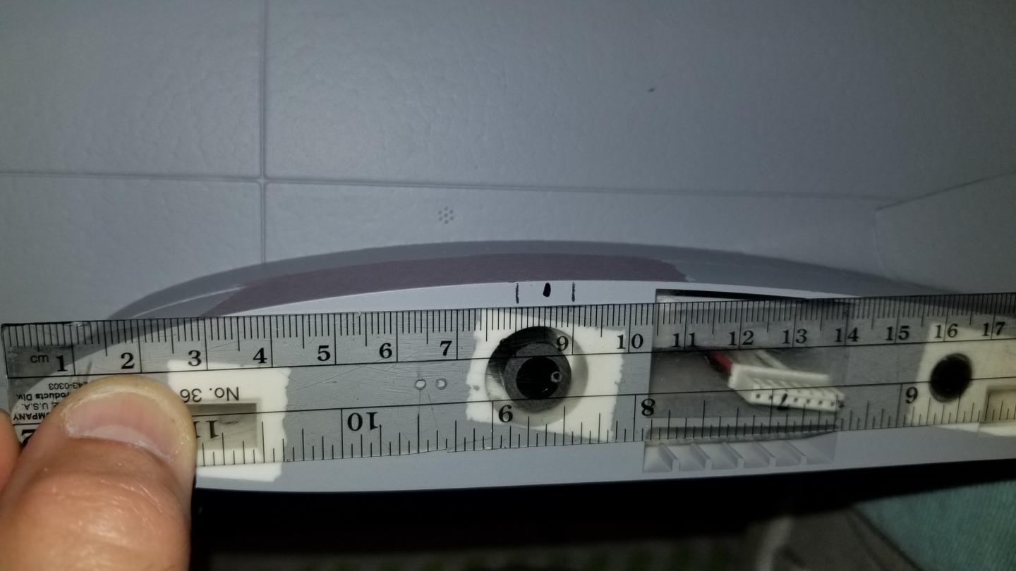

                    #10609
                    So, I know alot of guys "eyeball" CG spots... but seems when i eyeball it from the top of the wing with it installed, i get about to the 80mm mark pictured here. However, if I measure with wing removed, my 85mm mark is the center mark pictured. Picture shows 80-85-90 respectively. Gimme your thoughts guys... I'm also having to stack my Admiral Carbons to get this CG, is anyone doing this?

                      #10610

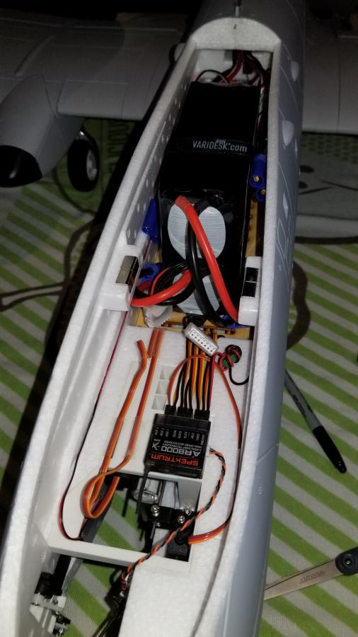

                      About the measuring of the CG point. It shouldn't have to be such a guessing game nor should you have to "eyeball" it. If you choose XXmm from the leading edge of the wing at the root, it's XXmm no matter how you measure it. Use a box butted up against the leading edge of the wing and measure from the vertical face of the box and straight back (at 90 degrees). Don't let the curve to of the top of the wing distract you. Once you see where XXmm is, drop vertically down to the wing surface and make a mark. If that's too close to the fuse, then use a right angle triangle (from a geometry set) to move the mark further out on the wing (perpendicular to the fuse). Plant your mark there and that's where you put your fingers to hold it for balancing. Repeat for the other wing.
                      Regarding the batteries: You also shouldn't have to stack them. Why aren't you shoving one battery down on the rear battery tray (after you've released the blue box and moved it way to the rear of that compartment) as far as it'll go. The second battery can then go in front of the first one and can be moved around a bit to make it balance right.
                        • 2716

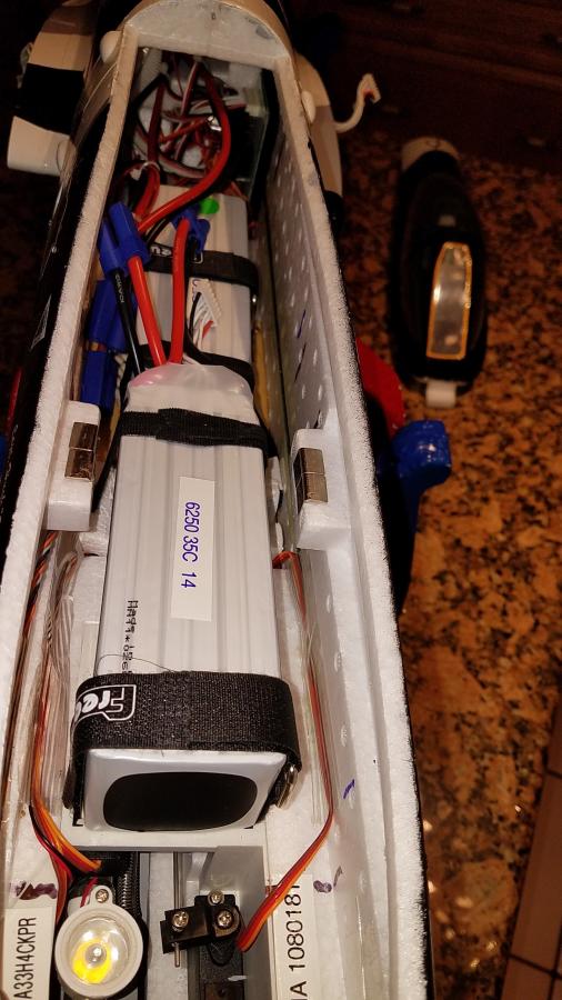

                        #10611
                        Agree with xviper . I removed the circuit board and stuck it to the port fuselage wall, also to help in receiver placement, then moved the batteries back to get to 90 mm. Added some extra straps for them as well. No need to stack them. Of course the front battery location affects the CG much more than the aft battery.
                        Click image for larger version  Name:	20200926_152819.jpg Views:	0 Size:	76.7 KB ID:	276892

                          #10612
                          Thank you xviper, I will rebalance with the CG mark as I measured to the 85mm mark. Your explanation makes more sense, and I was way overthinking this. 🙄 I'm stacking my batteries because they are the Admiral Carbon 5100mah 70C, and the size and weight doesn't really fit in the front location without carving a bunch of foam from the canopy. Also I wanted a free and clear area for my receivers, away from the large batteries, to try and keep from getting shadowing effect from them. Plus I'm a little OCD with my setup😉 I can hit all the CG marks, and they fit beautifully.
