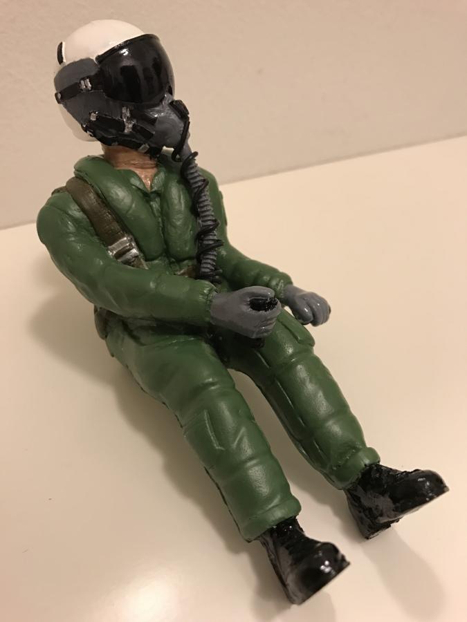

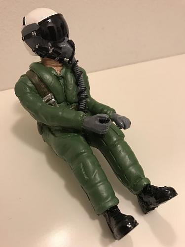

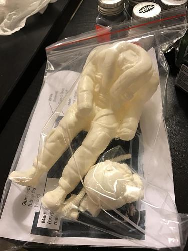

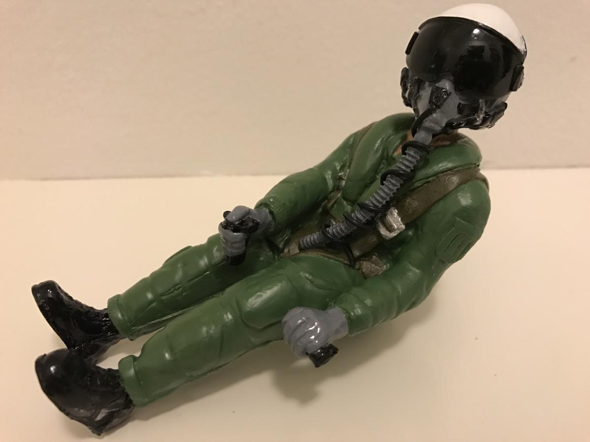

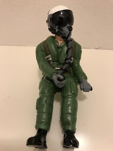

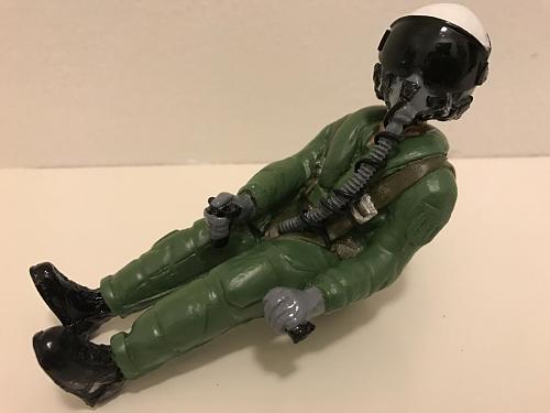

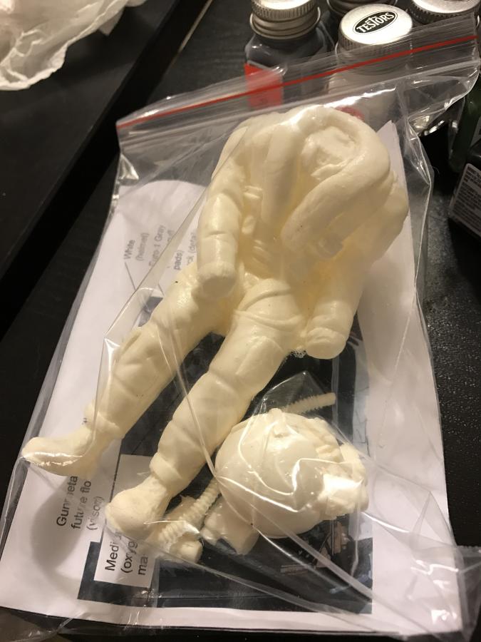

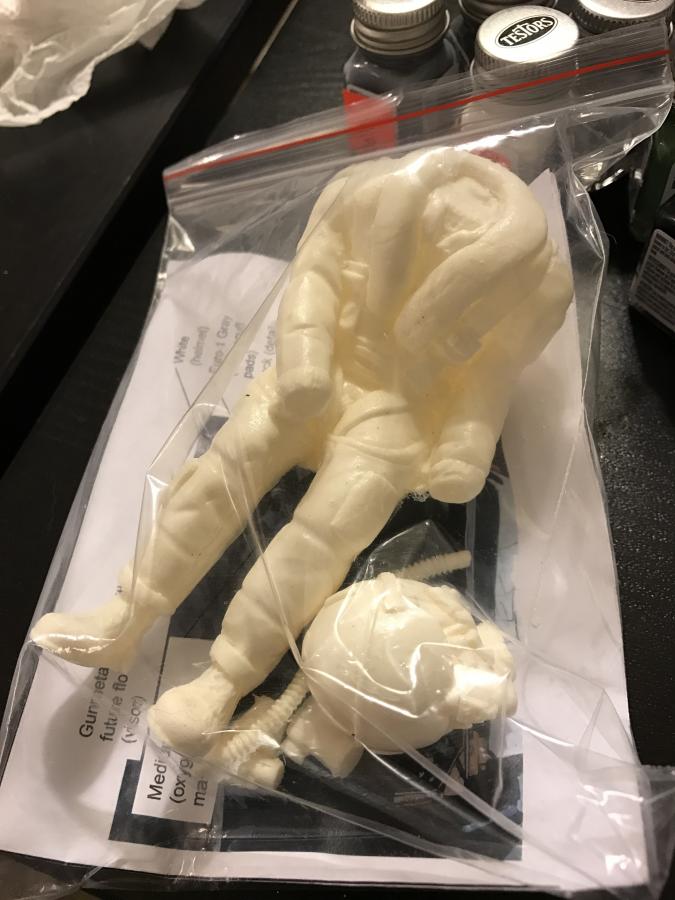

                      Bad to the bone, Alpha! I have a JetHangar 1/10 full bodied pilot I purchased last month that I painted up and ready to go. I'll be adding the audio/communication wiring as well to the mask.
                      For others to see how the pilot comes, first it's unpainted, and the head, hands, and oxygen cord has to be glued on. A light layer of 5-min epoxy or CA gel works well. Purchase some detail brushes of a variety of brush widths to ensure you can paint either larger or smaller areas of surfaces whether you want/need fine detailing or large surface paint cover. Choose the colors you'd like to apply for whatever look you're going for. I used Testors paints, as well as my wife's nail polish ;) :) (it works amazing for various parts depending on the color you choose and dries quickly, yet very durable, and often times cheaper for a larger amount of paint). Take your time, shake the bottle of paint well before use, and add layers until the desired look is completed. Patience goes a long way here, and you'll be shocked at how realistic it will look once done. The pics above show the unpainted and unassembled pilot, then the completed painted job.

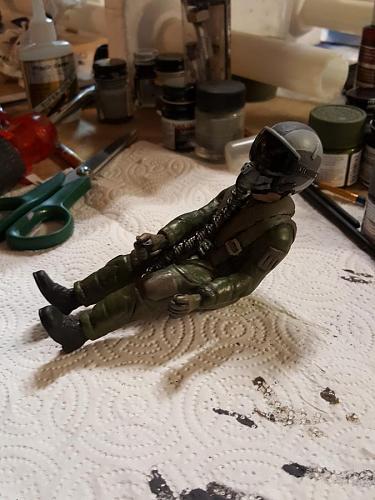

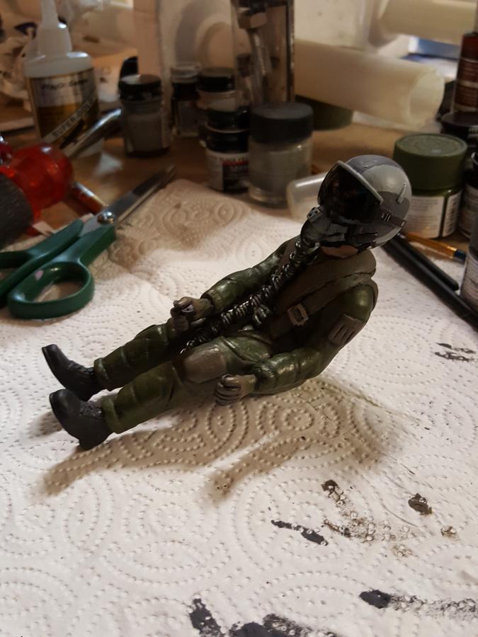

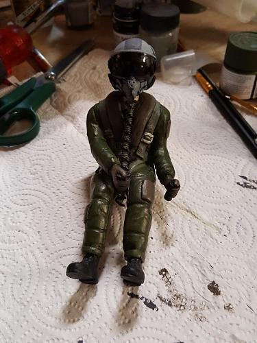

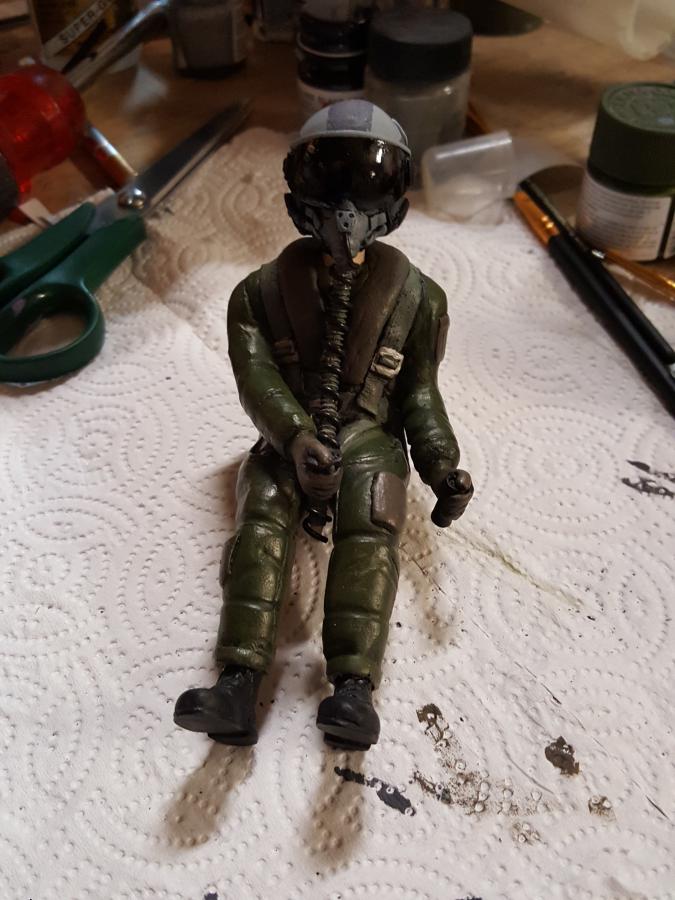

                        Thank you on both accounts. I got one of these pilot figures as well for the A-10. Glad to know I will be able to use him. :D

                            Nice to see some of us are planning ahead! Yes, Jet Hangar's 1/10 full body pilot figure fits into the Freewing A-10 nicely. I sliced a square area for each leg to fit under the instrument panel, cut off the boots for easier insertion (they're not visible anyway), and trimmed off part of his butt with a Dremel. Total work time less than two minutes, after about five minutes of planning. My pictures will make it very obvious where to cut. Everything else fits in nicely. Jet Mang was kind enough to send me a pilot figure so I could publish the conversion tutorial in advance of the A-10's delivery. He's had this pilot figure on the market for quite a while, and while technically it could stand to be 1mm smaller all around, for this A-10 overall it's the best detailed and closest scale modern jet pilot I've found. Plus, Jet Mang's casts are good quality and I like dealing with people I know personally and consider friends. #sharethelove
                            Good tip on the nail polish, T-Cat. Black high gloss nail polish is perfect for visors.
                                  It absolutely does work great, and cheap and quick too. High gloss black and a clear coat sealant works fantastic.
                                  We're all really looking forward to getting this jet.
                                  Excellent job RCjetdude!
                                  Thanks Aros! I think you'll really like the pilot mold. It has great detail and more than worth the price. It's also veryyyyyyyyyy light for the size.
