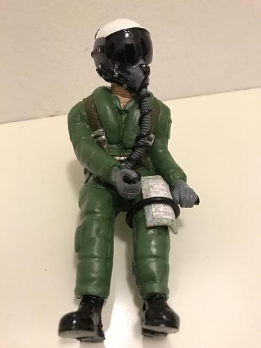

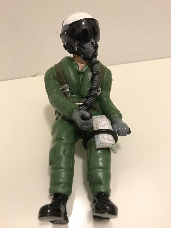

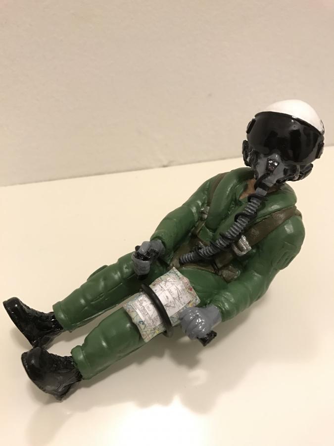

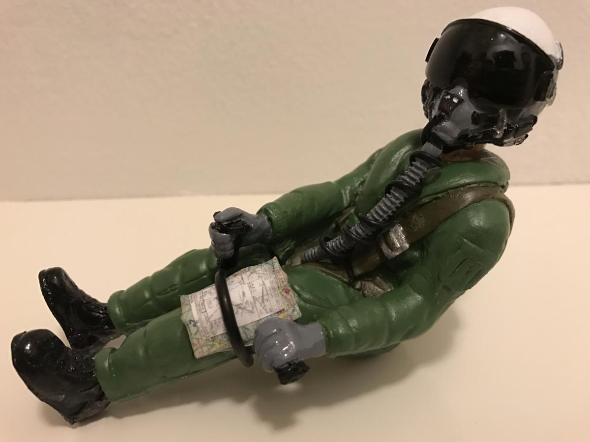

    Click image for larger version  Name:	IMG_0436.JPG Views:	1 Size:	36.5 KB ID:	61187Click image for larger version  Name:	IMG_0418.JPG Views:	1 Size:	65.5 KB ID:	61186Click image for larger version  Name:	IMG_0427.JPG Views:	1 Size:	37.8 KB ID:	61184Click image for larger version  Name:	IMG_0432.JPG Views:	1 Size:	39.6 KB ID:	61185 Well, I just had to keep adding some fun to this 1/10th pilot figure. I'll likely end up going with some Black Snakes decals, so I printed out a sectional chart (because they look cooler than some other charts ;), LOL) associated with the IN area where the Black Snakes squadron is located, and then printed out and scaled down an IFR approach plate, ILS/LOC RWY5. I folded up the chart larger than it would actually come in full scale just for easy visual reference of it as it lies under the approach plate. Ha-ha. I secured them on the pilot figure thigh with a prop saver. I'll look for some Velcro of some sort to make it more realistic soon. I also added more detail to the nose piece of the mask, and some other details. I'm having tons of fun with the realism of the figure. Thanks JHH for the incredible mold for us hobbyists to get a chance to own and paint these figures to our hearts content (don't raise the price, hahaha). Maybe after some more painting and detailing, the pilot figure will just get up and walk away trying to find his jet, Toy Story style LOL:Smug::Ghost:.
    Maybe the forum compresses pictures, but when I chose Medium size, the pictures degraded quality a lot and look blurry for some reason. It definitely doesn't look like that. Ha-ha

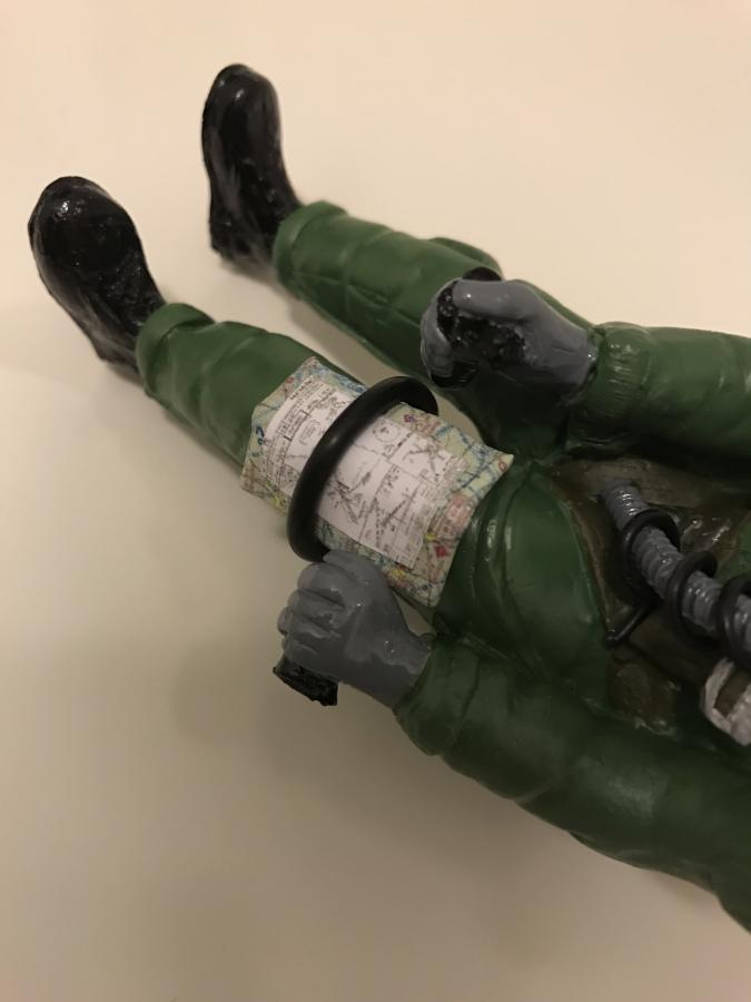

              As for cockpit detail, yes, this model has a big cockpit which is a detailer's dream. I've sheeted the cockpit of my pre-production test plane #04 with 0.5mm styrene and electrical tape to eliminate bubbling in the sun at the AEF event coming up next weekend. While I was in there, I took 90 minutes to quickly throw together a standoff scale ejection seat and assorted other features often seen in an A-10 office. I like your sectional chart, T-Cat! I haven't done that on mine, but instead I wrapped up some folded post-its notes with textured masking tape and painted it to simulate the stow bag often seen on the port side dashboard, where charts are often kept during a flight.
              I'll finish off the cockpit tomorrow night when I have more time, the send it to Freewing for any final adjustments to the instrument panel decals and other details. To keep cost down, we don't do plastic cockpits anymore, but again as with so many areas on this big Hog, the point is we hope models like this bring out the Modelers in all of us.

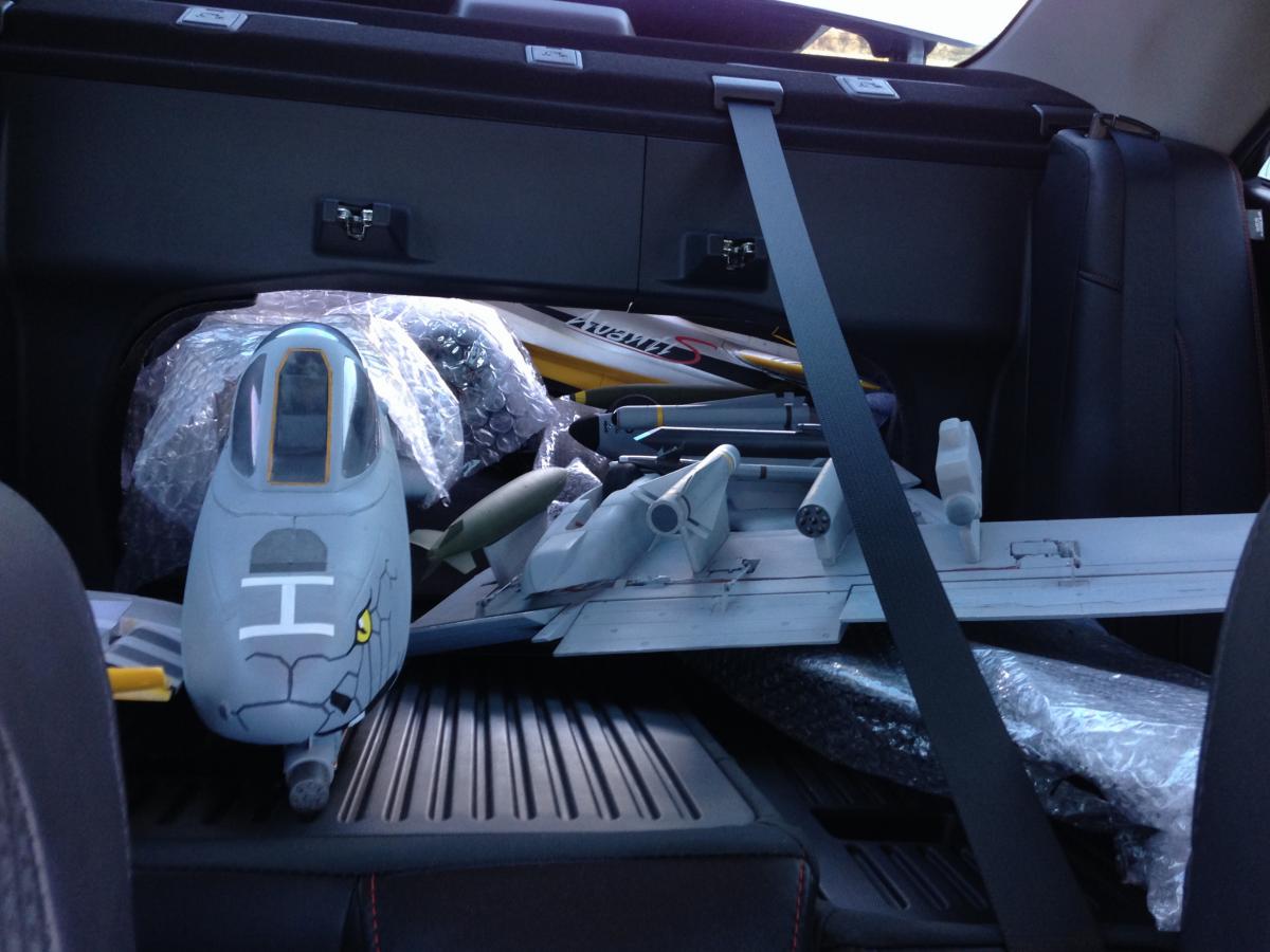

                              Twowingtj, the A-10's rudders are 580mm apart. I can fit this 1700mm wingspan A-10- 1600mm Spitfire, and 80mm Avanti all in a Toyota Camry, with room for a passenger and battery bag, camera bag. Tool box. Could have fit another plane width wise in the back seat if I needed to, just needed some pillows.
Name:	A-10 Spitfire and Avanti in Camry.jpeg

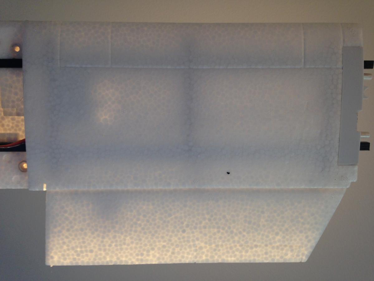

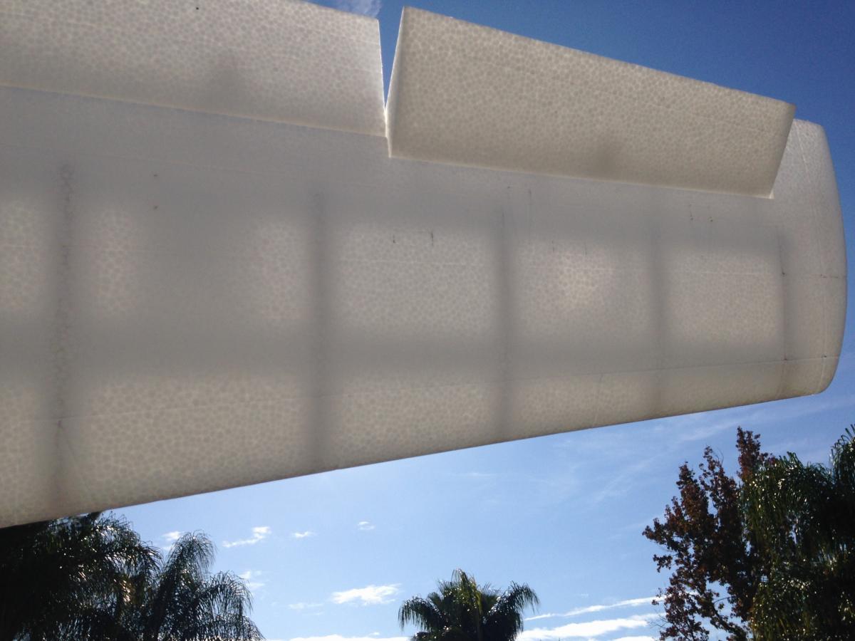

                                        I received some questions about the A-10's internal spar layout. Suffice to say we've logged over 400 flights on a variety of test aircraft and we're confident the A-10's flight surfaces can handle anything a responsible RC pilot will put the aircraft through.
                                        Short of posting screenshots of my CAD file, I do have photos of an unpainted A-10 held up to the light, with the internal spar arrangement visible inside the foam. For both the main wing and the horizontal stabilizer, we've used an interlocking rib and spar structure. Two carbon round rod spars are inserted through the fuselage, and the main wings slide over them from either side. The ends of these two through-fuselage spars rest in an aluminum machined knuckle above the main retract. This knuckle sets the dihedral for the outer wing section, and connects the through-fuselage spar with a square rod spar that itself goes out almost to the wingtip. The front spar and rear spar each go through a total of six plywood ribs, set in outlined hollow foam chambers, creating a framework that is rigid for strength but still slightly flexible to dampen the ride on this large aircraft as it maneuvers through a typical sport scale flight profile. The vertical stabilizers are screwed on, and a plastic plate with its own carbon square rod intersects with the horizontal stabilizer's strengthening plate.
                                        Main wing with internal carbon, aluminum, and plywood structure:
                                        The horizontal stabilizer uses all square rod:

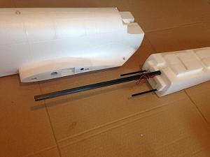

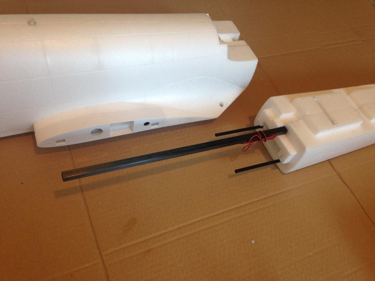

                                        The only structural joint that the user has to glue is the rear fuselage. The main spine is a large carbon square rod, with two carbon round rods for lateral support. A series of boxed keys molded into the foam makes alignment hassle free.

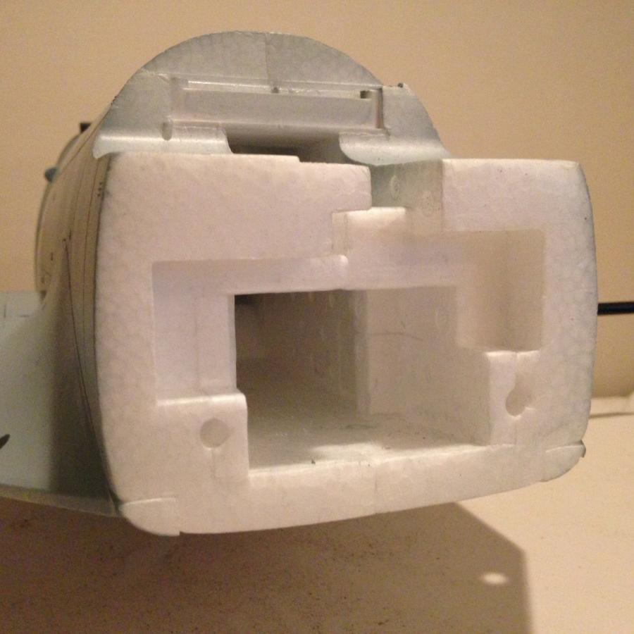

                                        The cavernous cavity visible in this picture makes fishing out wires easy to accomplish, if for whatever reason one of the tail's servos are being replaced. This spacious channel runs all the way forward to the battery compartment.
