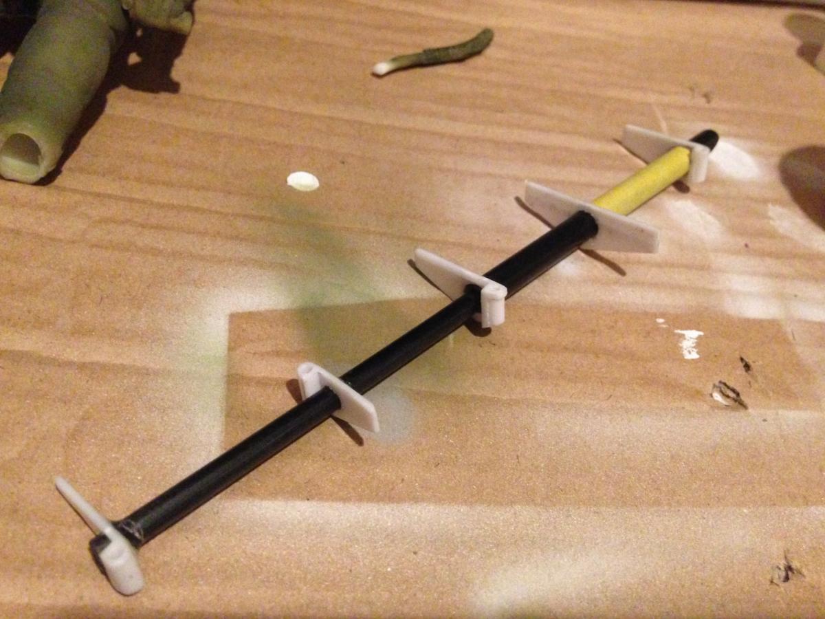

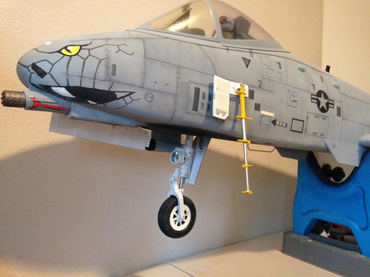

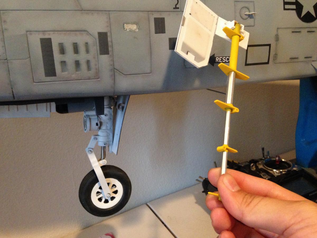

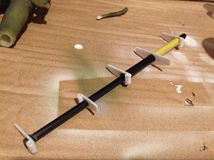

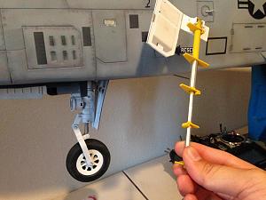

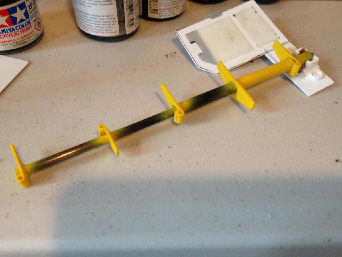

          Say Alpha, I'd like to know what materials you used to make those awsome steps for the Hawg. I'm guessing graduated aluminum tubing for the telescopic part but the actual steps have me stumped. Please advise, Brad
            #845
            Hi Brad, I fabricated the steps from 1mm styrene sheet, cut with scissors to shape, "drilled" with an x-acto to snuggly fit over the carbon telescoping tubes, then sanded to ensure each step's angles were flush with the other steps. After this photo was taken, a magnet embedded into the foam and later concealed under putty makes it easy to attach without marring the fuselage's appearance.

              From one modding modeler to another..................VERY IMPRESSIVE Alpha !!
              Of course you know that a lot of buyers are gonna want that as part of the base package. ;)
                #847
                +1 on the entry ladder. Very nice bit of work.
