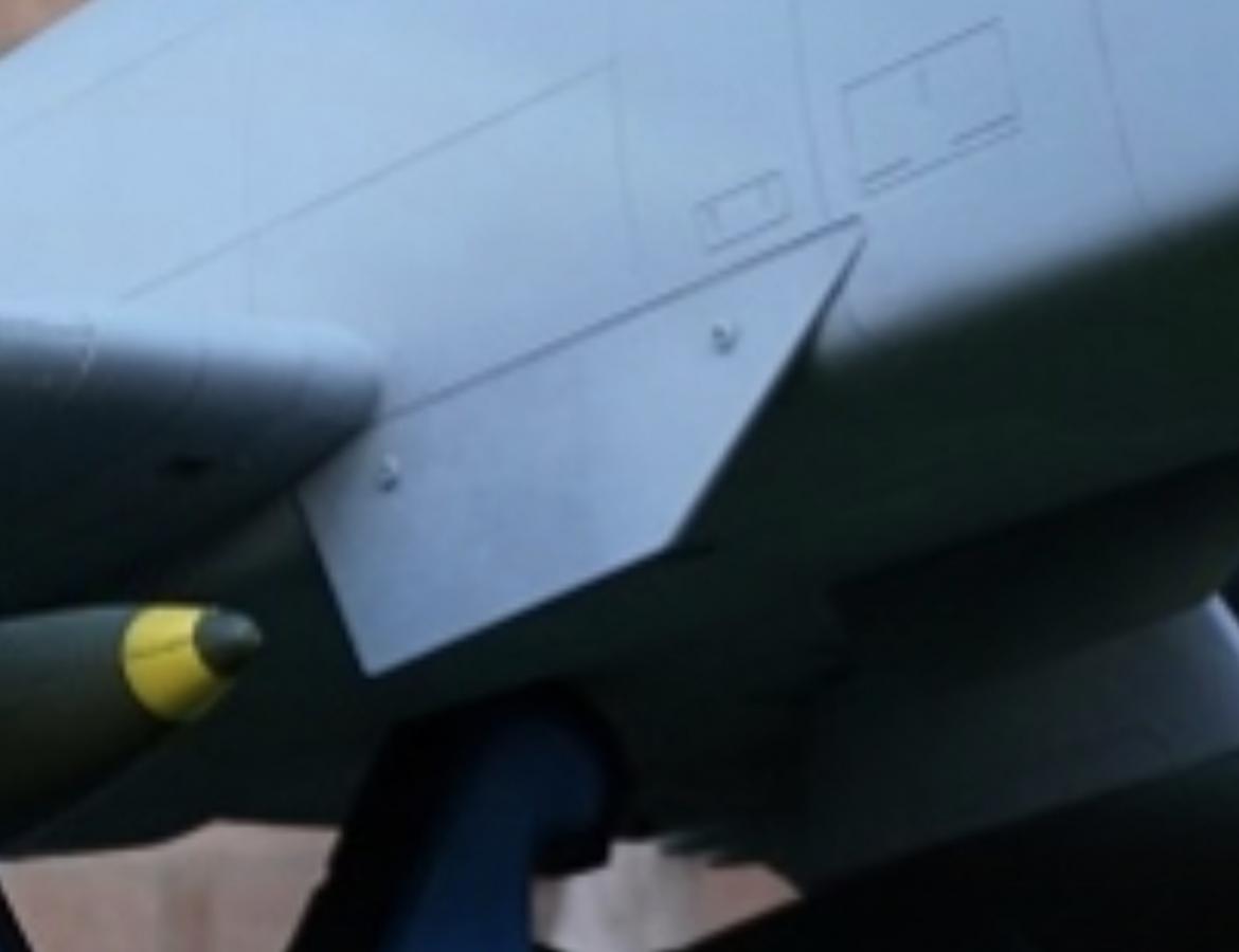

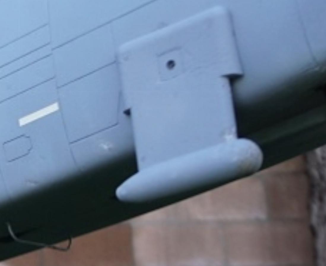

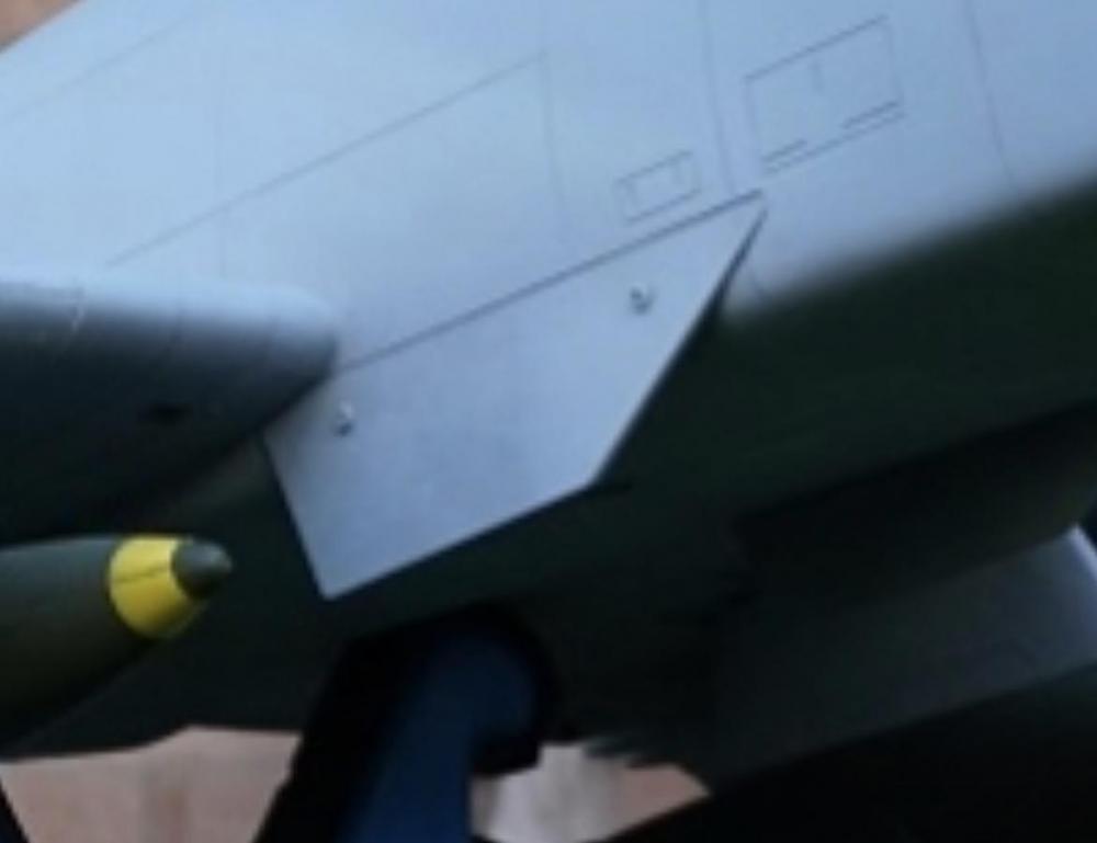

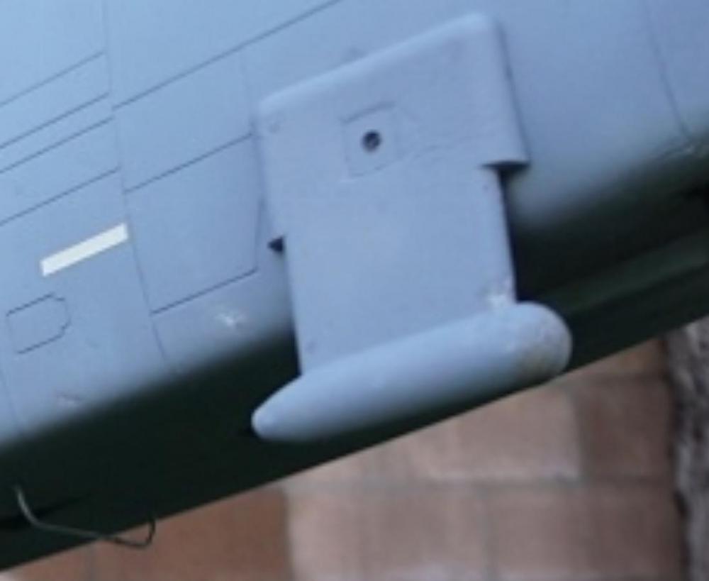

      On the production model is there plans to make the attachment hole(s) and screws less noticeable on the Pave Penny Pod pylon, and the lower mid fuselage fins?
      Maybe a rubber/plastic grommet/plug for the Pave Penny pod hole, and some slightly recessed wood holes for shallow countersunk screws for the fins would work, etc.
      • Hi T-Cat, I'll leave it to the modeler to tape and paint over the hole on the Pave Penny. I usually paint over the servos and control rods and clevises on my bigger planes, anyway, and at that point if the hole bothered me I'd point the airbrush at it, too. But we're not including a flush grommet because the idea is customers may unscrew the Pave Penny for transport, and a grommet would have to be dug out every time.
        The fins are glued on the 64mm Freewing and 70mm FMS version, but for this 80mm Freewing, the glue just doesn't hold as dependably. Because these fins bear the weight of the fuselage on a table/floor when the wings are off, we're using plywood and screws screwed into plastic receivers, for the most sturdy arrangement. The wood, however, is still too thin to be countersunk for a flush mounted screw. Here again it would be up to the modeler to customize if the screw head really bothers them.
        • Makes sense, thanks! I'm okay with modifying depending on the need.
          • I would have to also agree with that. Doesn't bother me. I like to do some of my own detailing and customizing....it's part of the fun of it all :)
