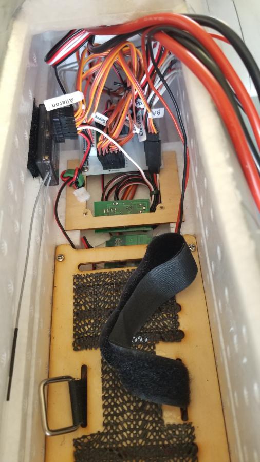

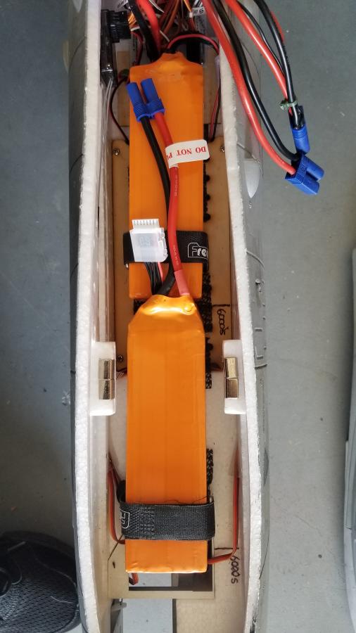

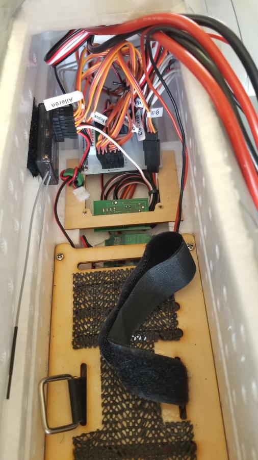

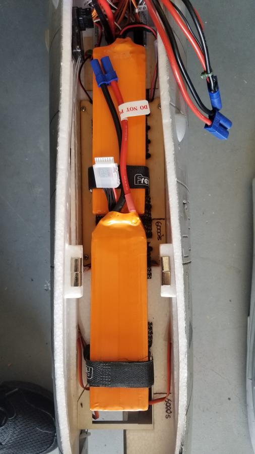

              Okay I step closer to the maiden, I think she's pretty much ready to go flying. I got the CG at about 80-83mm with the 6000's and have room to adjust as needed. I moved the circuit board back to the rear screws and tucked the UBEC under the battery boards along with the servo reducer for the flaps.
              Only thing left is to adjust the nose wheel because she doesn't exactly track straight when she rolls and we don't want that. Just have to figure out how to do it lol.

                Looks good Splat, but I would take one antenna and go up and back with it, just circle it around, not a tight cicle but just loop it around above the rx, scotch tape the gray part of the antenna right to the foam, this way both antennas are not hidden by the battery, or you could loop the bottom antenna back, it will probably be fine the way it is, I never had any trouble what so ever with my Futaba 617 antennas split up, but do what your comfortable with.
