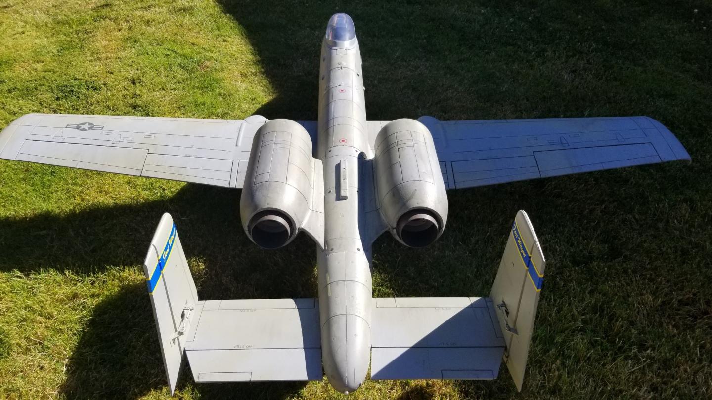

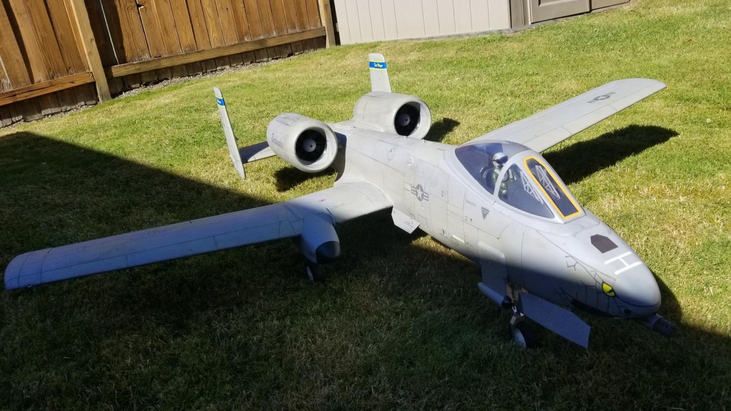

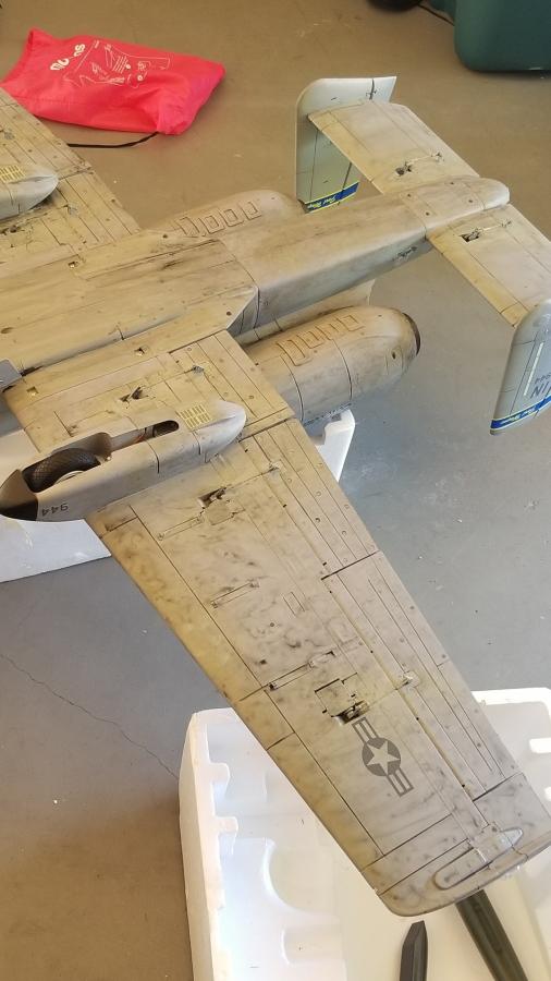

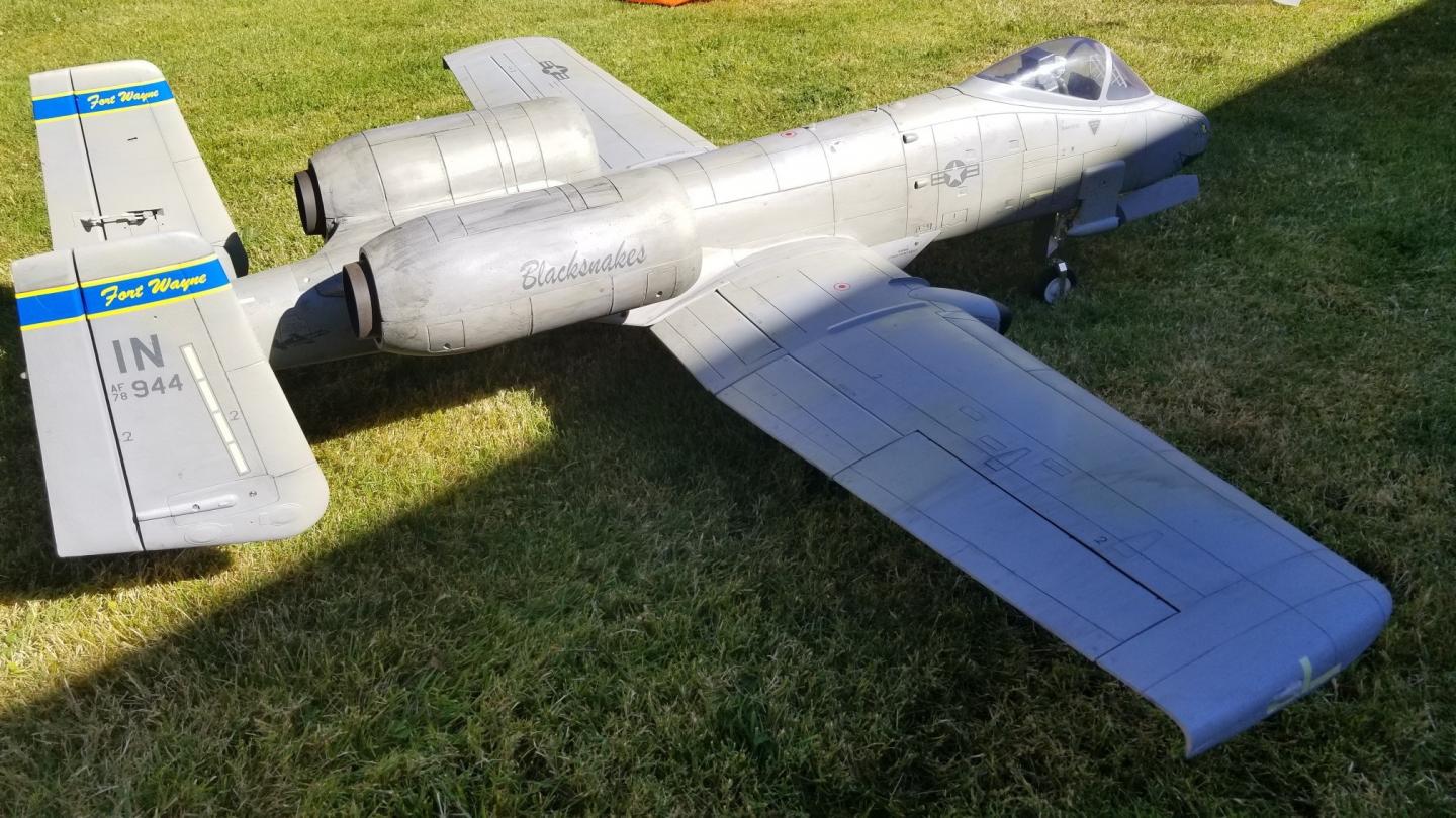

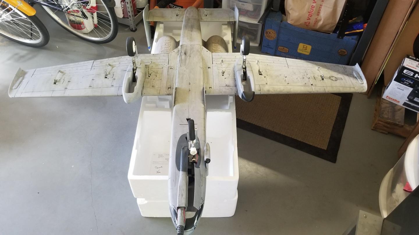

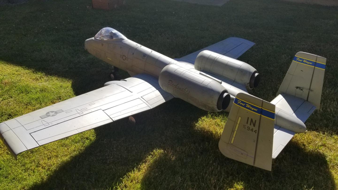

                              Well I think she's finished except for the ordnance...
ID:	267619Click image for larger version
ID:	267620Click image for larger version
ID:	267621Click image for larger version
ID:	267622Click image for larger version
ID:	267623Click image for larger version
ID:	267624Click image for larger version
ID:	267625Click image for larger version
ID:	267626Click image for larger version
ID:	267627Click image for larger version
                                Elbee commented
                                Editing a comment
                                Beautiful, simply beautiful. Bravo Zulu, Sir. Best, LB

                              Looks great splat, if you decide to go to a more scale front wheel, a main wheel from the Freewing 90mm F-16 looks great, you will need to shim the sides as it is a little thinner in width, but if your flying off grass you might want to keep the over size front wheel.

                                  Thanks Corsair and I will be flying off grass mainly so I'll keep the landing gear as is for right now.
