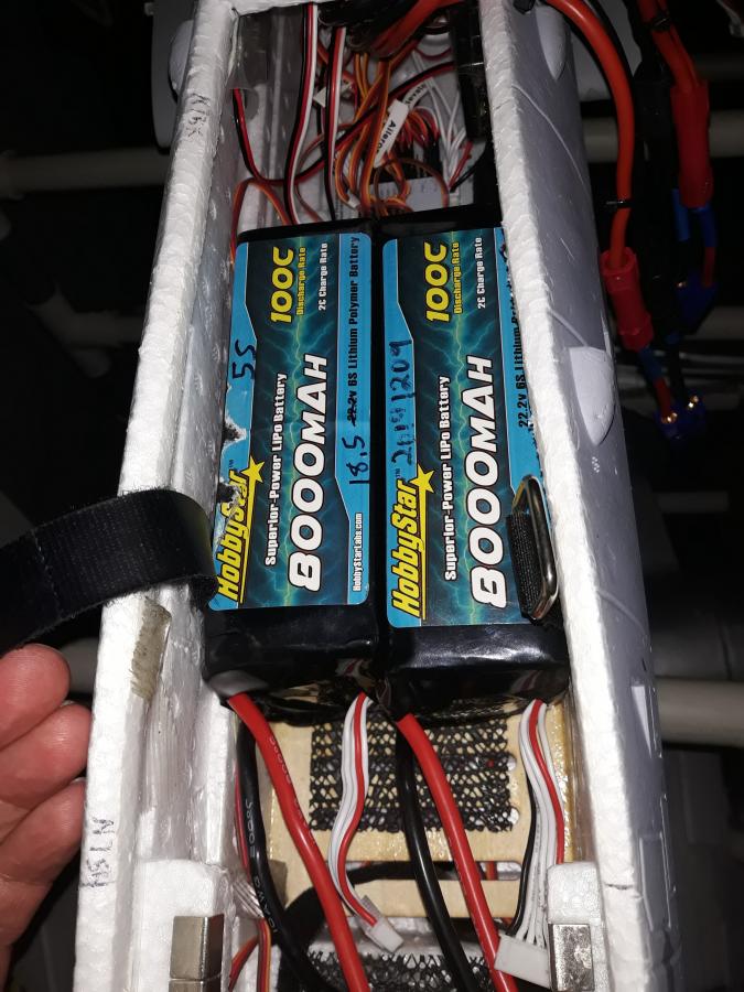

                                          #10100
                                          Originally posted by John Bergsmith
                                          Interesting, I wondered if those batteries would fit. Now if someone had them in stock.
                                          Fits like a glove, just put one in at a time to get past the narrow lip at the top and install a longer battery strap.
