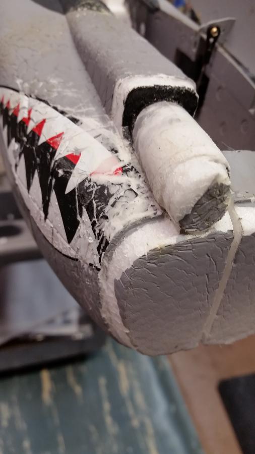

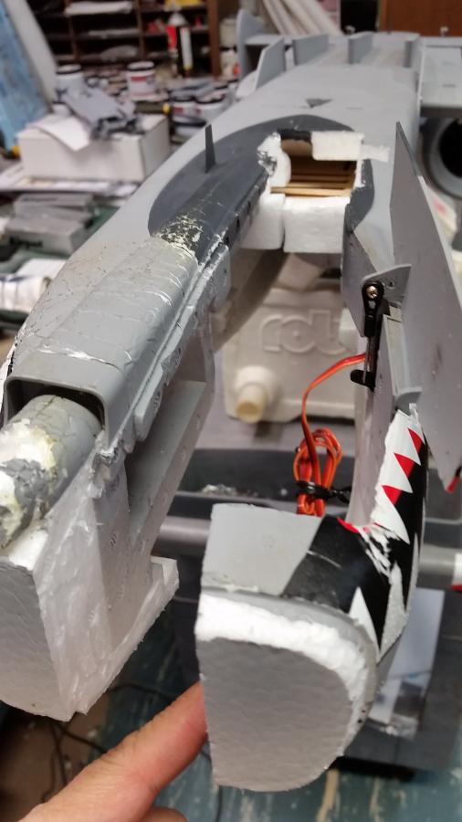

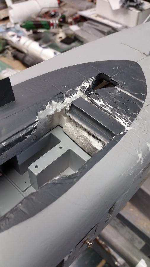

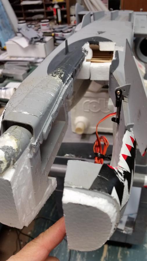

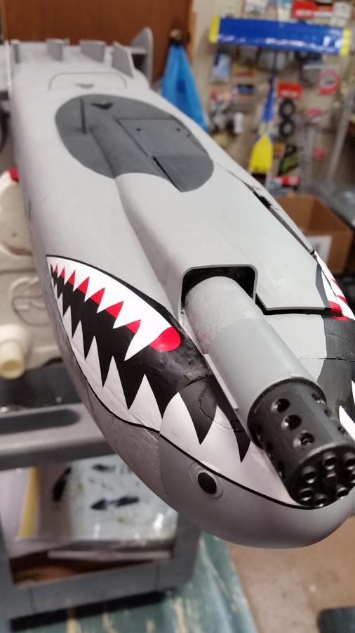

                            Hi there Kevin,
                            Several weeks go I was working on a friend's A10 that had crashed (pancaked) and the plastic nose gear mount was completely destroyed. This large piece of plastic is glued into place when the fuse halves are put together at the factory. By working very carefully I was able to split the fuselage in half along the seam. All you need to do is split it at the nose.
                            Take the nose gear, doors, and servos out... then remove the plastic nose cone/cannon (its glued on, you can pry it off. In my case, the nose cone was destroyed!). You must also break out all the remains of the original NG mount. I used a pair of pliers to pry everything out and break the plastic pieces out. Then use a sharp knife to cut through the mating line at the nose and you can carefully separate the left and right side of the fuselage. Its not a big cut!! Once its cut the two halves will easily spread apart to provide enough access so that you can pry out what remains of the plastic mount which is glued into the fuse sides. Once you get it all out, you'll be able to glue the brand new one in (epoxy) and put everything back together. Booyah!.
                            In the case of the plane I was working on, the nose gear ripped out a lot of structure behind the mount as well. (Third picture) I replaced the crushed sections, used a new door, used filler and got everything back into shape, then used color-matched paints to bring it back into shape. The model had lots of other damage as well, but the nose was the hardest part.
                            This is almost pornographic.... but here are a few pics to cry over.
                            Happy ending - the last pic shows the finished results (with a replacement nose cone and new decal)

                              themudduck, Great to see you making a post. That is some serious neuro-surgery. Looks new and great information, Sir. Best, LB

                                  #10056
                                  Yikes kind of what I was afraid of! Nice job themudduck.
                                  After looking mine over I may be able to avoid the surgery.
                                  Thanks for the info!
                                  The front two mounting bolts pulled out.
                                  The rest of the plastic mounting block is in tact, with no damage to the foam.
                                  On the left side (looking at the bottom) a hole all the way through to the inside is exposed.
                                  I will fill that with a hardwood block.
                                  On the right side I can epoxy the plastic back into place, or drill it out for a piece of hardwood.
                                  This should be and out patient fix in my case.
                                  If not I have the pieces on order to do the major surgery!
                                  Thanks again!

                                    Hey Kev,
                                    In my case the entire mount was destroyed. But if your mount is mostly OK, I agree with your plan, just epoxy in some hardwood blocks to provide a firm mount for the screws and it should be fine!
                                    The mount is simply a thin layer of plastic - so please replace that broken part with hardwood.
                                      #10058
                                      I filled mine with hardwood block too, then used long wood screws. Works great.
