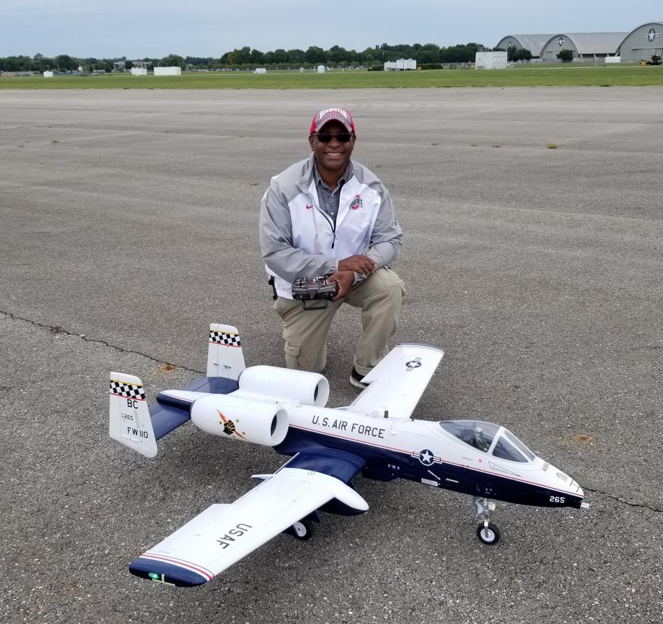

      Still flying my old faithful
        OV10 commented
        Editing a comment
        And still the only one in that beautiful livery

      OV10 , thankyou sir. But sad she is not the only one anymore. A guy copied the paint job and won best foam jet last month at Florida Jets.
        #9964
        t33jetman Those of us who know, know YOU were the originator! Being followed is a good sign you're leading from the front.

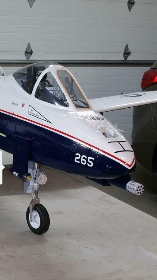

          Imitation is a form of flattery. Its a really cool scheme.
          The guy bought the 3D printed cockpit set I designed for the A-10, and recently shared his pictures with me. He even mentioned how he copied your scheme
            Congratulations, he did a very good job copying every detail.

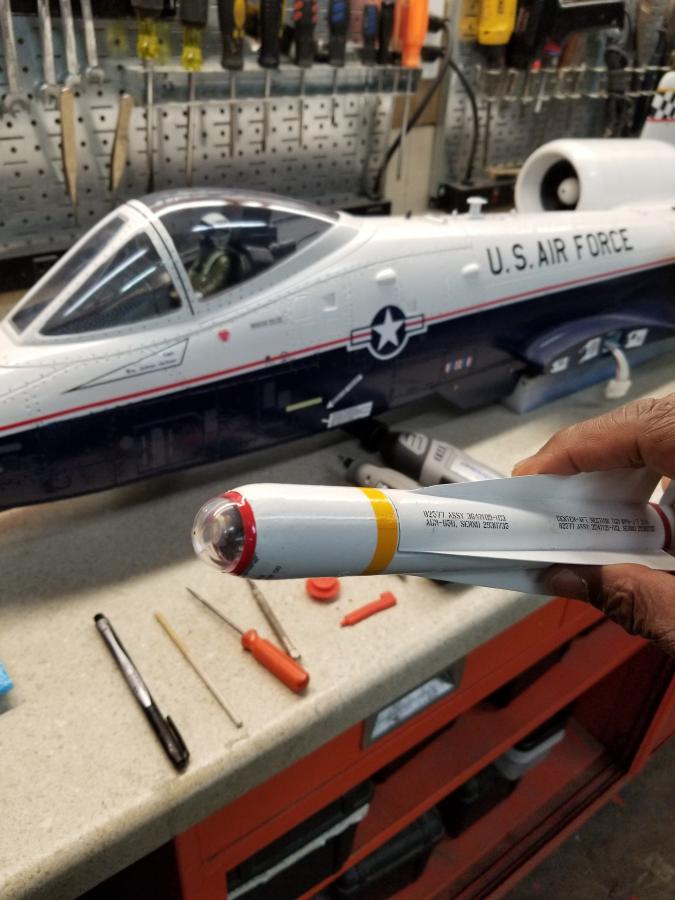

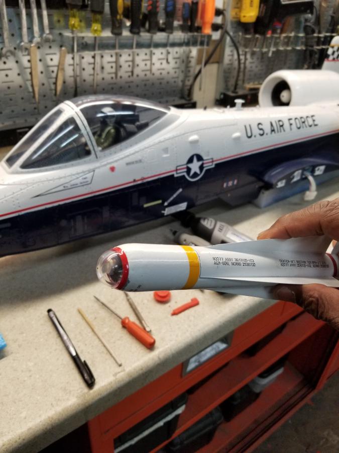

              T33jetman, love the scheme on yours, and imitation is the highest form of flattery! You both did a great job. Now I want to add a little more scale detail to the pave penny and Maverick missiles. Trying to find something to use as clear lenses for the front of each. Thinking those little plastic containers from gumball machines will work for the Mavericks but at a loss so far as for what to use for the pave penny, as it's a little small. Any suggestions would be appreciated.

                Do a search on Ebay, for clear half domes is what I did two years ago. Also added them to my Maverick missiles
                    For what it is worth, I found this place on the interwebs a while back for my 1/9th CGRC A-10 pave penny: https://kitkraft.com/t/categories/acrylic-domes
                    Measuring my FW A-10, it seems like the 3/4" outside diameter could work. Maybe a little fudging and filler here and there but pretty close.
                    Nice job on your Hog!

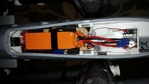

                                    I have the Admiral 6000's in mine as well. Control board and rx are behind the batteries, and the batteries are stacked are top of each other. Mine is balanced at 86mm, no lead in the tail. I did have to carve a little bit of foam on the bottom of the canopy to make it fit with the batteries stacked like this.
                                    Though it may not need done, I replaced the supplied BEC with a Castle Creations Pro BEC. I just didn't think the suppled BEC looked up to the task to run 12 servos and the retracts. Just my opinion. Anyway, that is behind the batteries as well as the brake controller. I used the BEC I took out of the A-10 and used it in my Avanti in runner version. Click image for larger version  Name:	20200412_221714.jpg Views:	0 Size:	127.9 KB ID:	248761

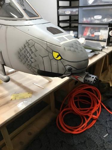

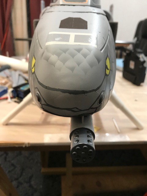

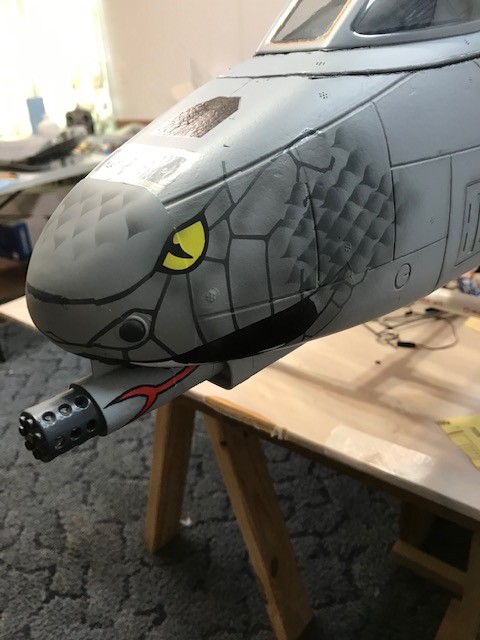

                                      Added some scales to my Blacksnake. Click image for larger version
Name:	black snake 1.jpg
ID:	248763Click image for larger version
Name:	black snake 3.jpg
ID:	248764Click image for larger version
Name:	black snake 2.jpg
                                        #9980
                                        Awesome!
