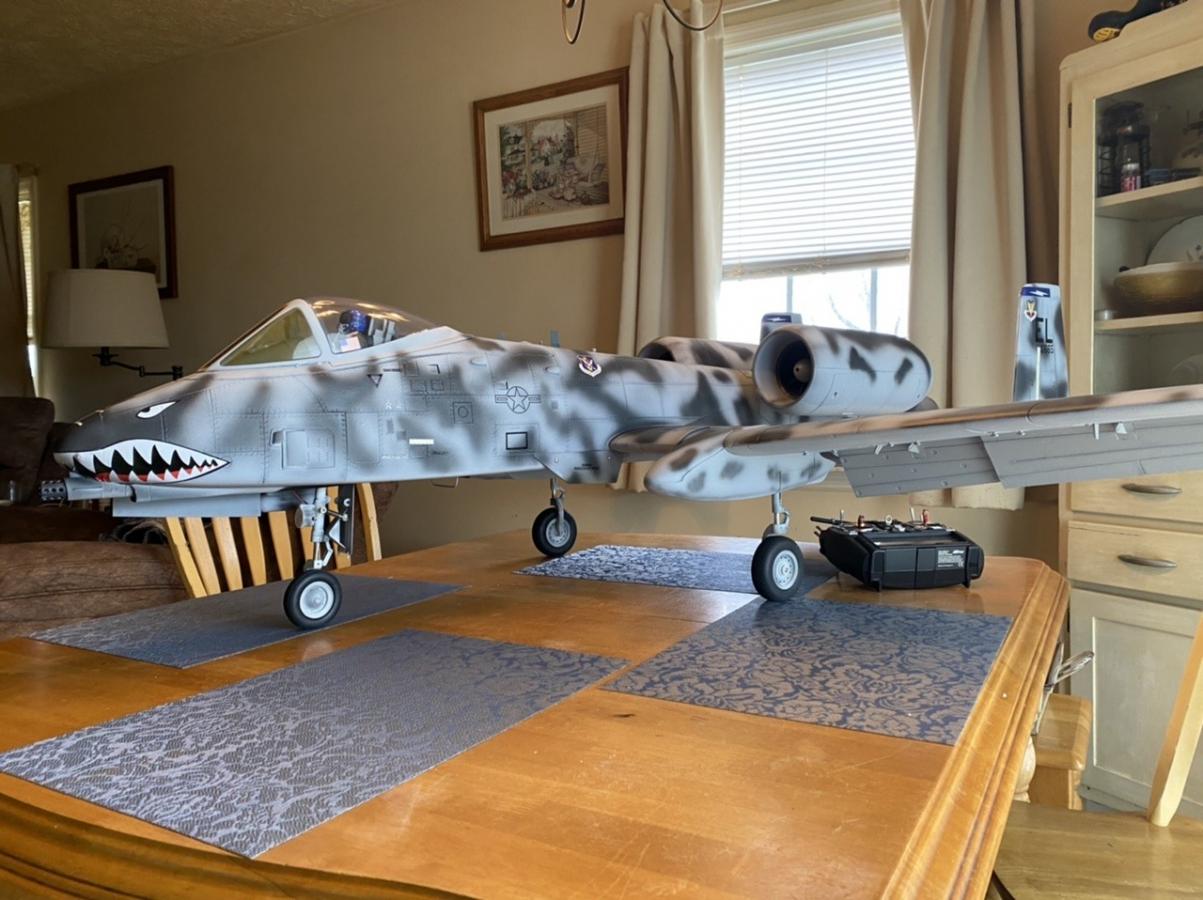

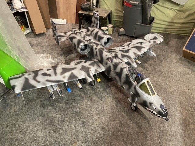

                          #9892
                          Hi guys,
                          I almost forgot, I added a total of 8 Nerf whistles to my A-10. There are 4 in the engine nacelles and 1 each in the M-84 bombs and 1 each in the AGM-65 missiles.
                          The whistles in the ordinance should work trough the entire flight envelope( I hope).
                          Later!!
                          Anthony

                            #9893
                            Waconut , She's a looker. Well done. Best, LB

                              #9894
                              Originally posted by Waconut
                              Hi guys,
                              Later!!
                              Anthony
                              That's a LOT of whistles! Please do a video to show off what it sounds like taxiing and in the air! Great job on the pain scheme.

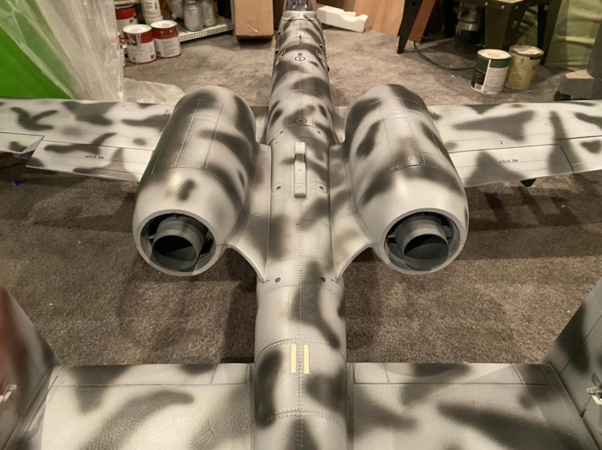

                                #9895
                                I finally got around to installing the scale exhaust tubes from Dirty Dee. They make a huge difference in the looks.
                                  • 4875
                                  #9896
                                  Waconut, Looking very Cool and the DD nozzles really help to finish the nacelles. Best, LB
