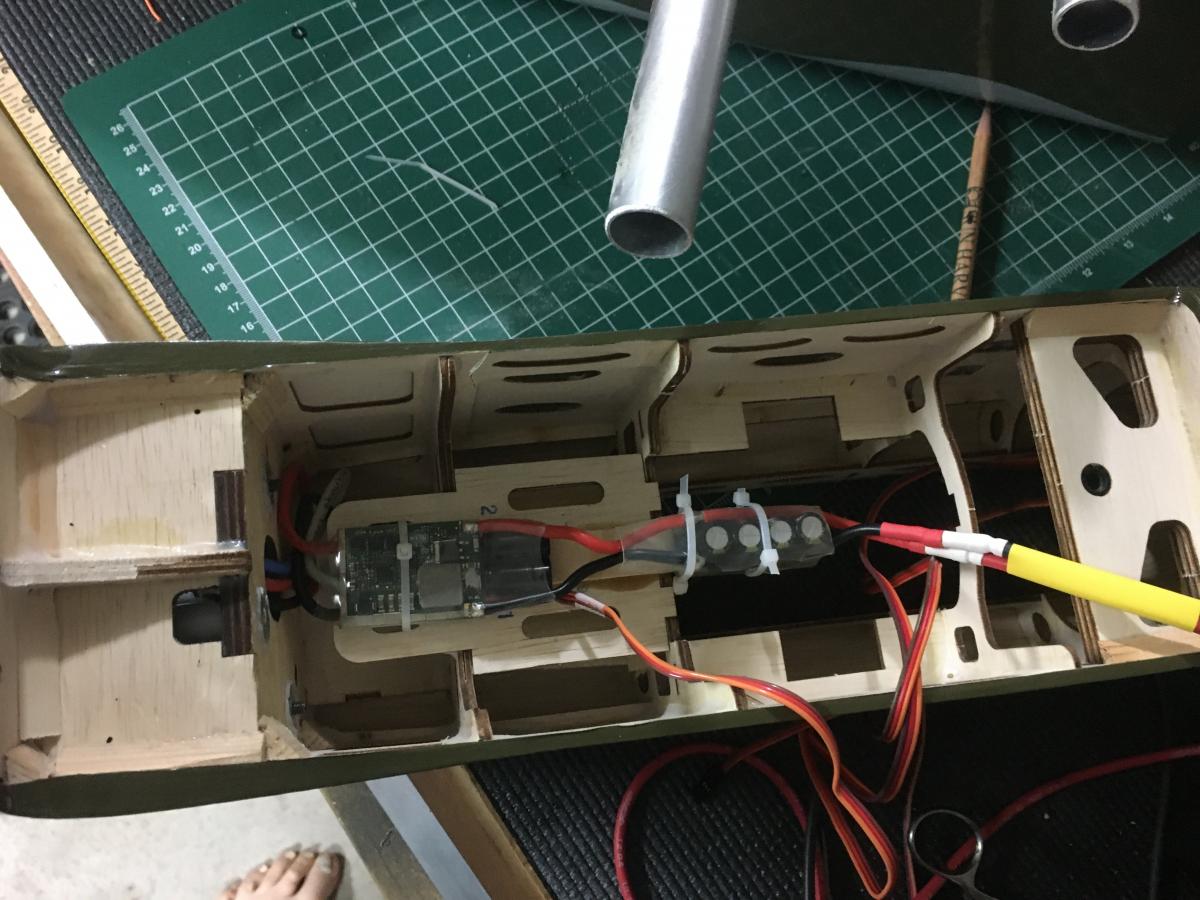

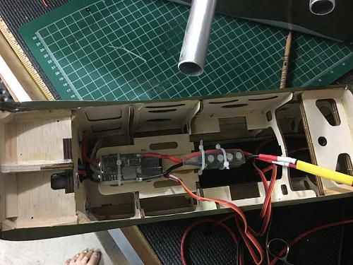

                    Question for anyone who has purchased the ARF Plus version and put in their own power system.
                    ? How critical is it to use additional capacitors to the esc's? I see that the stock setup had a 4 cap bank added to the esc's for the 80mm fan setup.
                    I plan on using a 80mm edf units along with 150amp esc's that have two 35V470uF caps already installed on each esc. Was thinking the long wire runs up to the batterys might need this mod..not sure..
                    Any advice would be greatly appreciated....Thanks in advance.
                      . Click image for larger version
                      I think with a wire run that long it would be a wise thing to do. I installed them n my ProFly OV-10 build for that reason..
                      Mike

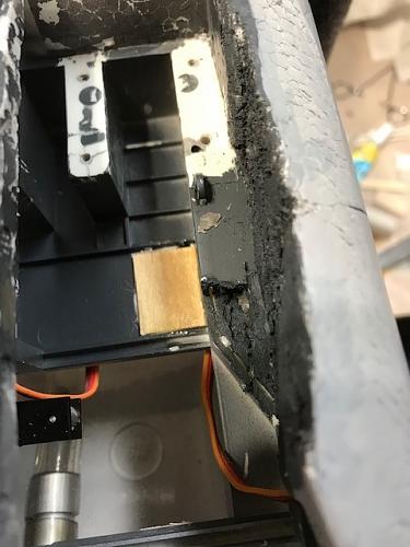

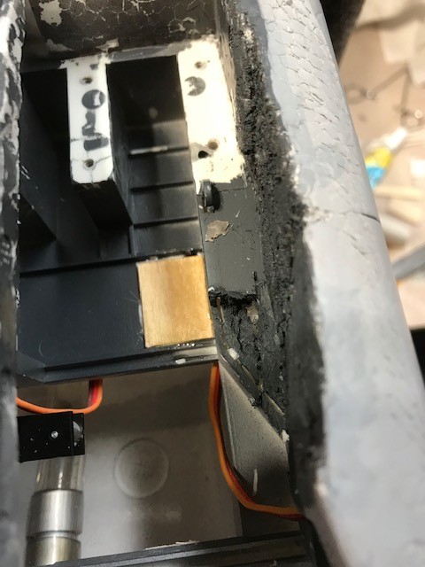

                        Well,, when my nose gear broke, as usual the plastic housing cracked both screw flanges off. I got to looking at it and came up with this idea. When the gear gets force back, it pulls the motor housing of the gear down and away from the plastic mounting box. So I am going to use some very strong double sided servo mount tape to connect the motor housing to the mount box. That way the impact force will have to first break loose the tape before it can break the flanges off of the gear housing. I'll put the tape on that little piece of 1/16 plywood I glued in the mount box. I know it won't solve the problem in a real bad hit, but it should make it a little stronger. You could glue the motor housing in instead of the tape, but I just want to be able to remove the gear easier. Click image for larger version  Name:	Landing gear.jpg Views:	6 Size:	67.3 KB ID:	250229

                          #10012
                          Thanks for your response to my question in the above post Mike T.
                          It looks like you added a "Castle Creations Cap Pack" to your esc's battery leads.....I was planning on doing exactly that.
                          I was at my field yesterday and talked to another Freewing A-10 owner and his setup is "stock" and didn't have this mod and his aircraft flies great....I think this is good insurance to add the cap pack.
                          I am not the guy who mods stuff on airplanes just to do it, but I think this makes sense.
                          Thanks again.

                            Thanks. I went right to Castle and asked about it. I found their answer made sense so went with it. Simple to do.
                            Mike
