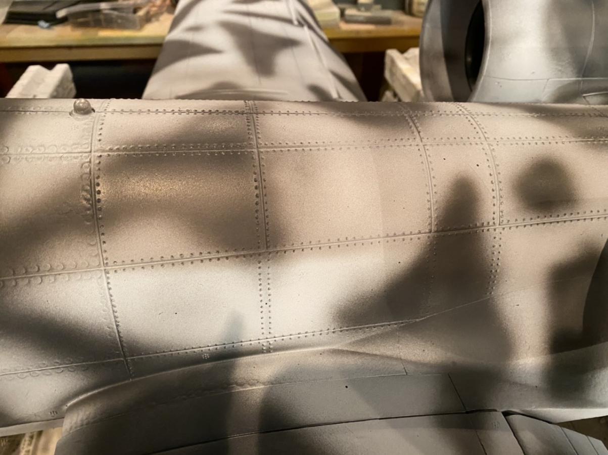

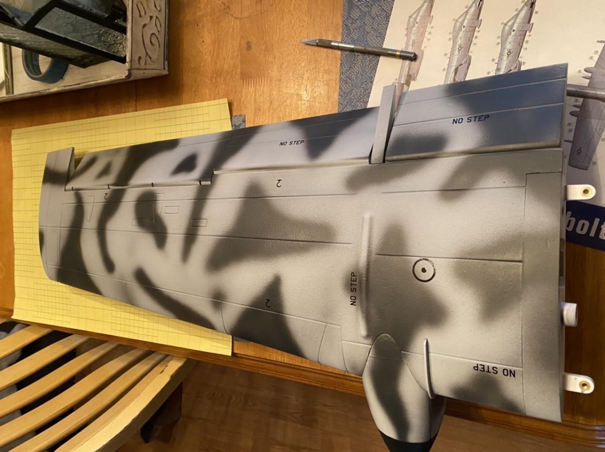

        I painted the top side yesterday and today I went over all the panel lines and rivets with a black mixture in the airbrush. After that was dry I went back over those areas with the base color. I like the effect, it is somewhat subtle. I still need to do the same treatment to the bottom.

          Looking sweet so far. There's a fine line between not enough, and overdone.

            This is so true and cannot be overstated enough. I see so many weathering jobs that are unrealistic because they didn't know they crossed that line of overdone before it was too late. It's very easy to do. But with weathering, if scale realism is what you are after, I always tell people "less is more."

              Last month I attended the e jet fest in Mulberry, Florida hoping to take home best static scale jet with my 70mm F16. There were 2 top gun judges inspecting our planes. One of them said that a lot of the planes at top gun are way overdone. Anyway, I was told that some of those guys at top gun could take lessons from my weathering job, so I felt good about that ! However, I missed the mark on details, and walked away with runner up. No matter how good the weathering job is, it's only a portion of the total score. I'll do better next year.

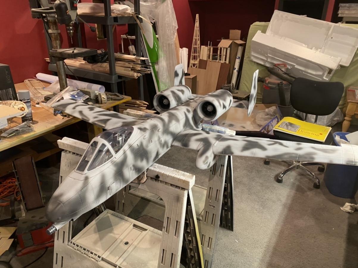

                    I painted the camo pattern on the A-10 today. It didn’t turn out like I had envisioned or planned but I will take it. It should still look Bad A$$ once the weathering is complete and the decals are applied.

                      WN, Looks 'Outstanding' from here, Sir. Best, LB

                        I like it !

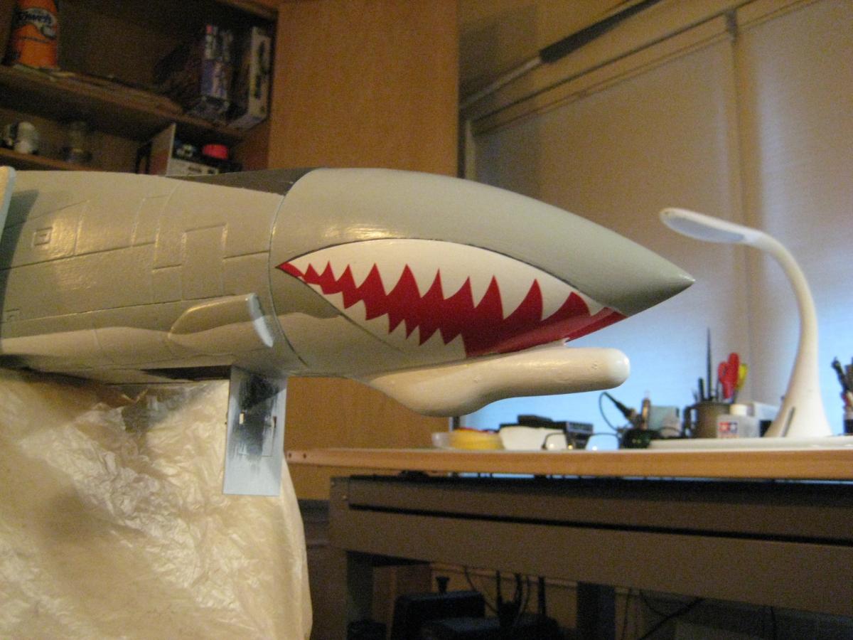

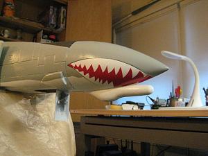

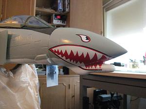

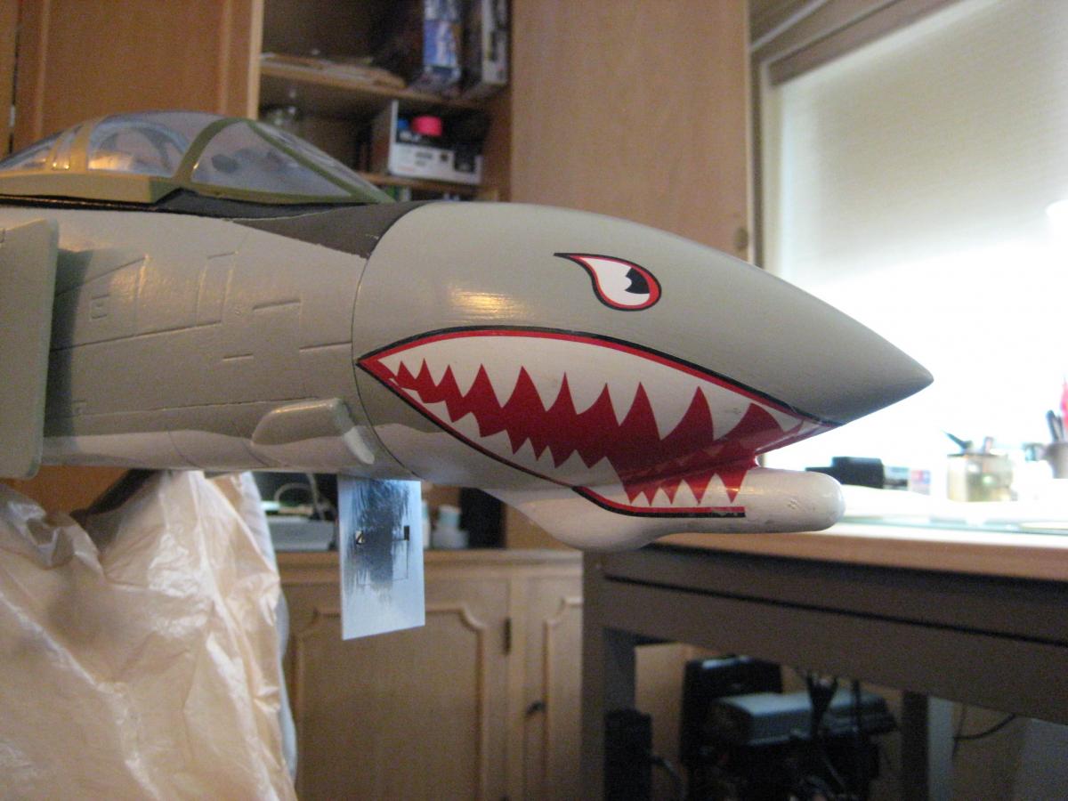

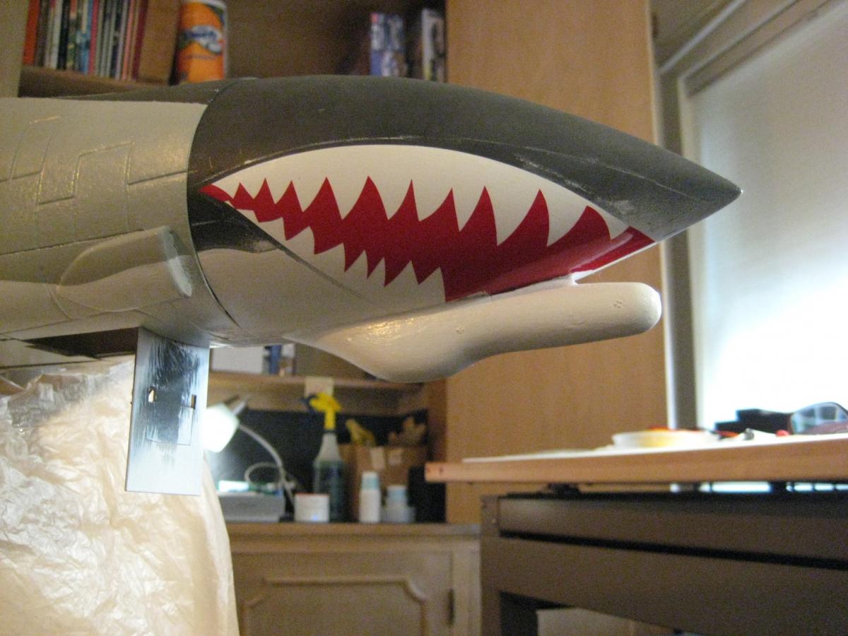

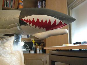

                            WN, did you have Callie Graphics supply you with the 'Sharks Mouth"? I ask only as I had her do the Shark's Mouth for my Freewing F-4 in 2 sets of each different color and used some for 'outline templates' and others then for application. Worked well using the White paint for the large compound curved area and then the Red graphics and striping for the other colors. Best, LB

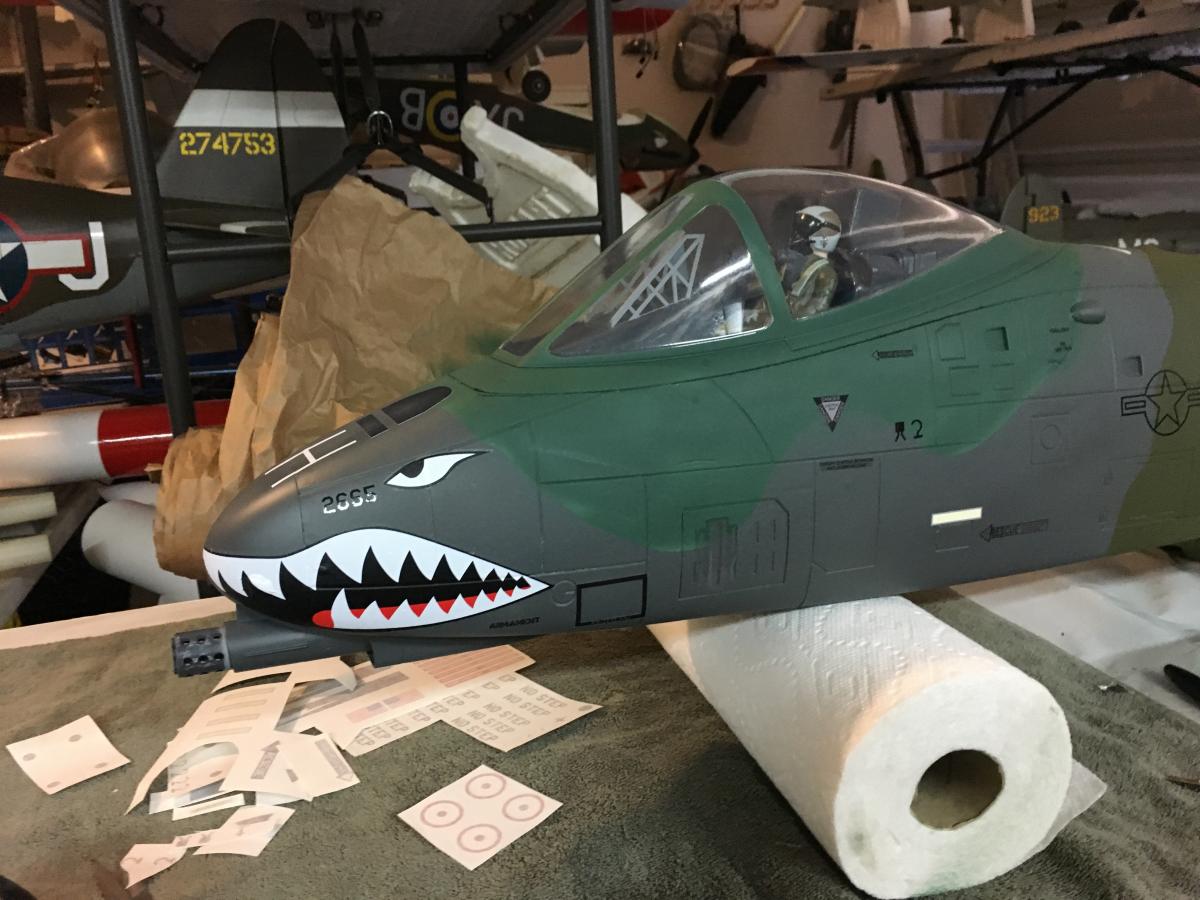

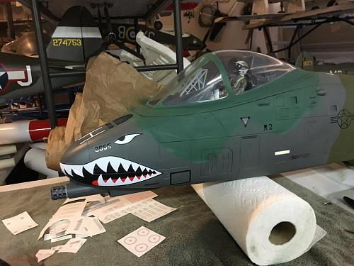

                              Originally posted by Waconut
                              Hi guys,
                              I started applying the graphics that I received from Callies and I must say they are great. Anyhow has anyone used her graphics and applied the Sharks mouth? Any pointers would be appreciated I would hate to screw them up.

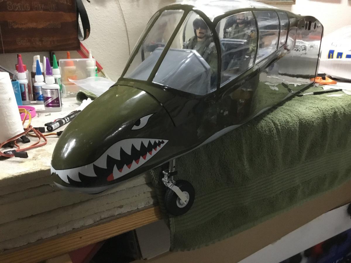

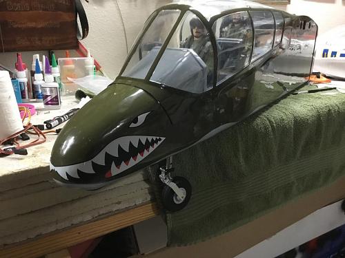

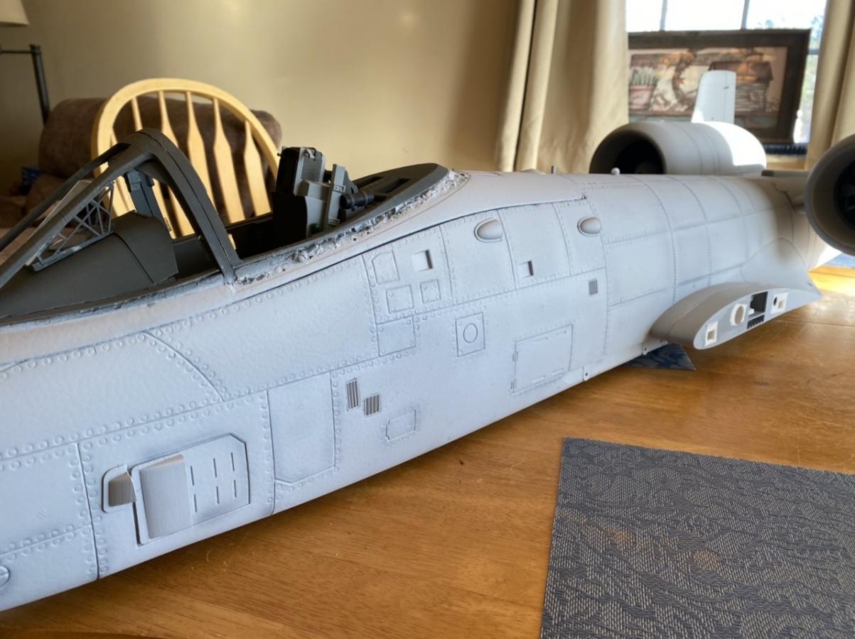

                              It's water-slide. take your time. I found that Micro -Sol and Set made a huge difference on how the decal set down. Worked great.
                              Mike

                                LB,
                                Yes Callie supplied the Sharks Mouth.
                                Mike,
                                I am using vinyl graphics supplied by Callies Graphics. I am not using the stick water slide decals.
                                Thanks!!
                                Anthony

                                  Use the watersilde that came with the A-10 from Motion. I used most of Callie's stuff but not the vinyl shark mouth.
                                  Mike

                                    I will try the vinyl first. I hate water slide decals.

                                        As much as I dislike waterslide decals, at least for a curvy surface and a relatively large decal, they go on better, can be slid around and can conform to odd lumps and bumps better. If it doesn't work out, don't completely blot out all the water and you can soak it all down more and it comes off fairly well. Vinyl, on the other hand, once it makes contact and sticks (even mildly on a small spot), is a bugger to lift off and relocate. Lifting off a vinyl decal can sometimes take paint with it. Callie Graphic decals are high quality but they have really good "stickem" and the vinyl is much thicker than a waterslide due to the backing on the top side.
