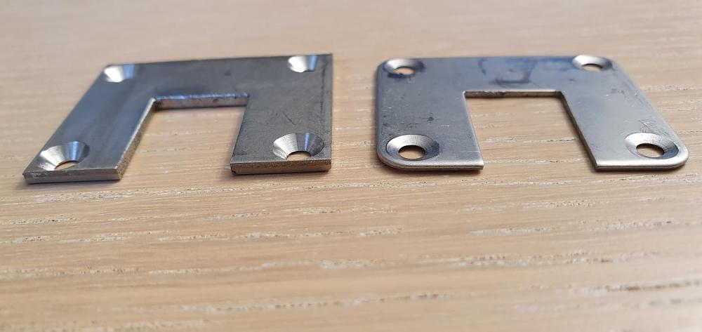

          Hi Pilots,
          Since I distroyed the black plastic part of many gear mechanics I'll exchange the metal plate by a thicker one. The new ones are made of steel. Wonder how that works… Of course I could also improve my landing skills...That would't be a bad idea either.
          • thisguy65
            • 509
            #9685
            Does a magnet stick to it?
            Planes
            • Wobisch
              • 83
              • Merenschwand, Switzerland
              #9686
              probably yes. would that be a problem for the gear mechanics?:worried:
              • t33jetman
                • 515
                #9687
                  #9688
                  I don't foresee a problem with the steel plates impeding the retract motor's operation, or the other ferrous elements of the retract.
                  • Wobisch
                    • 83
                    #9689
                    Thx. I'll gonna test it then.

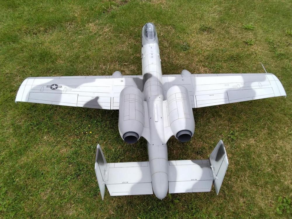

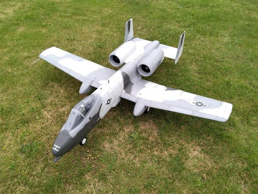

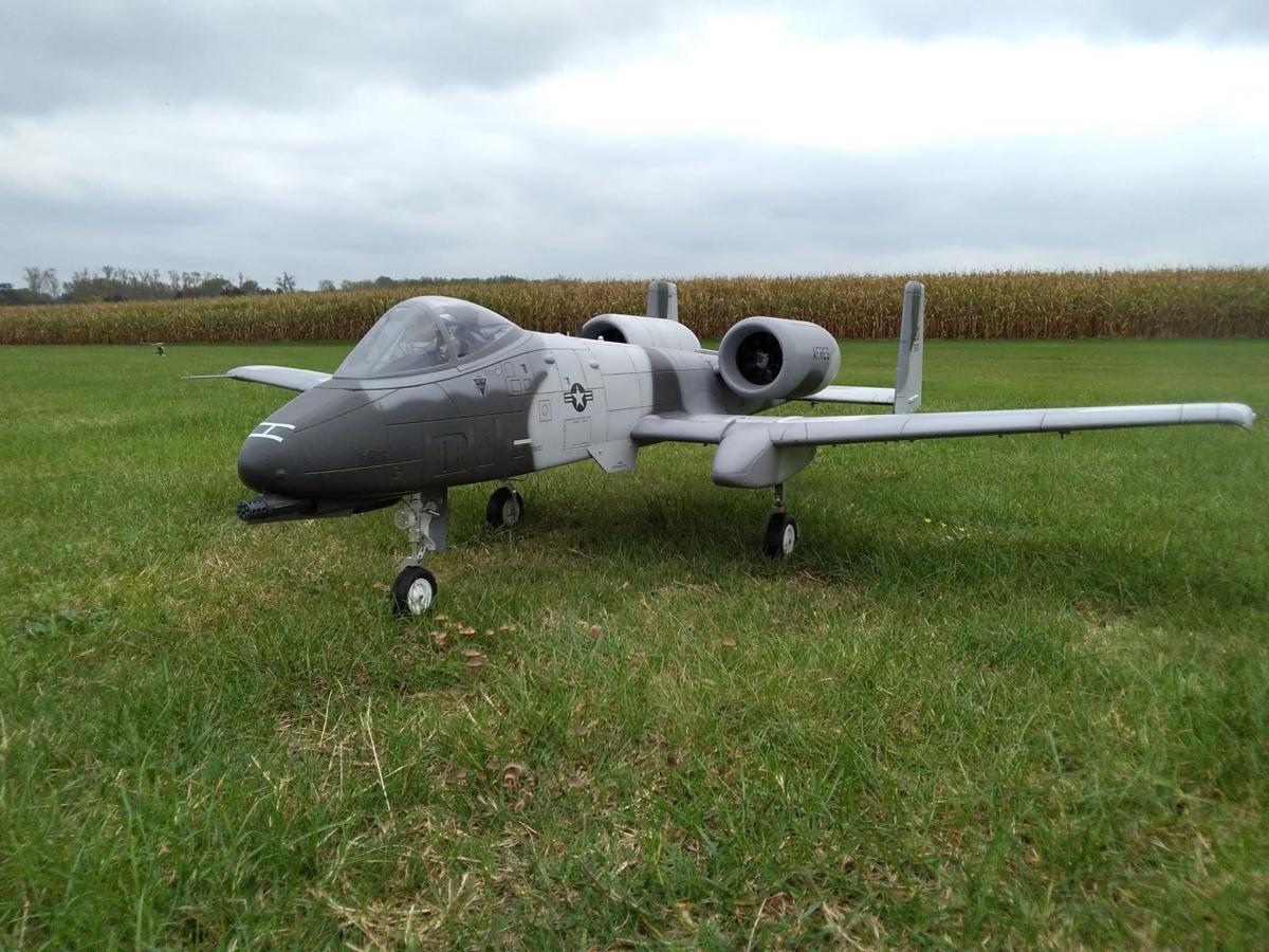

                              Hi all,
                              I'd like to share some photo's of my A 10 in the JAWS sceme, it kind'a special...you like it or hate it...
                              it took a serious amount of airbrush time...
ID:	217792Click image for larger version
ID:	217793Click image for larger version
                              Enjoy!
                              Didier
                                • 4837
                                #9695
                                Originally posted by didier n
                                Hi all, I'd like to share some photo's of my A 10 in the JAWS sceme, it kind'a special...you like it or hate it...Didier
                                D, Bravo Zulu, Sir. Just outstanding work. Best, LB
                                  Hi all,
                                  Enjoy!
                                  Didier
                                  I LOVE IT
                                    #9697
                                    Second that!!! Awesome stuff!!!

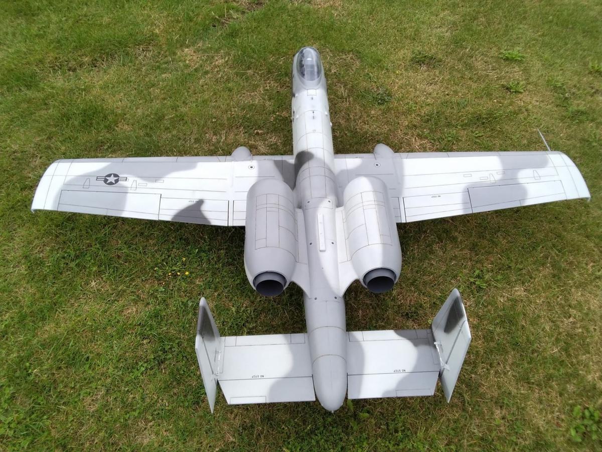

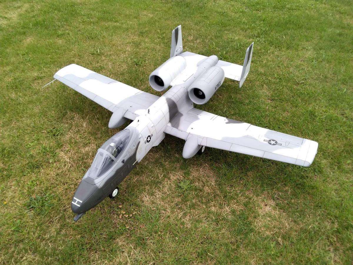

                                      #9698
                                      Thank you all for the nice comments! The A 10 is a great jet and a joy to fly...
                                      Therefore i made a second one.... this time the grey flipper sceme...
                                      Click image for larger version  Name:	74209775_446796169526983_6008226791141933056_n.jpg Views:	0 Size:	165.3 KB ID:	217904
                                      Click image for larger version  Name:	71638548_525202724719524_7678991072403390464_n.jpg Views:	0 Size:	218.1 KB ID:	217900
                                      Click image for larger version  Name:	75262296_800880313678459_8787823260248047616_n.jpg Views:	0 Size:	243.1 KB ID:	217901
                                      enough A 10's for now... still got a freewing F 18 to finish
                                      Regards,
                                      Didier
