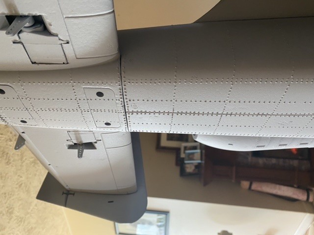

                #9807
                I painted the light gray on the bottom of the A-10 today, really made the rivets pop. I will wait until the cockpit kit is installed to paint the top side.
                Can’t anyone tell me the correct paint color for the cockpit?
                Thanks!!
                Anthony

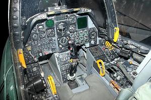

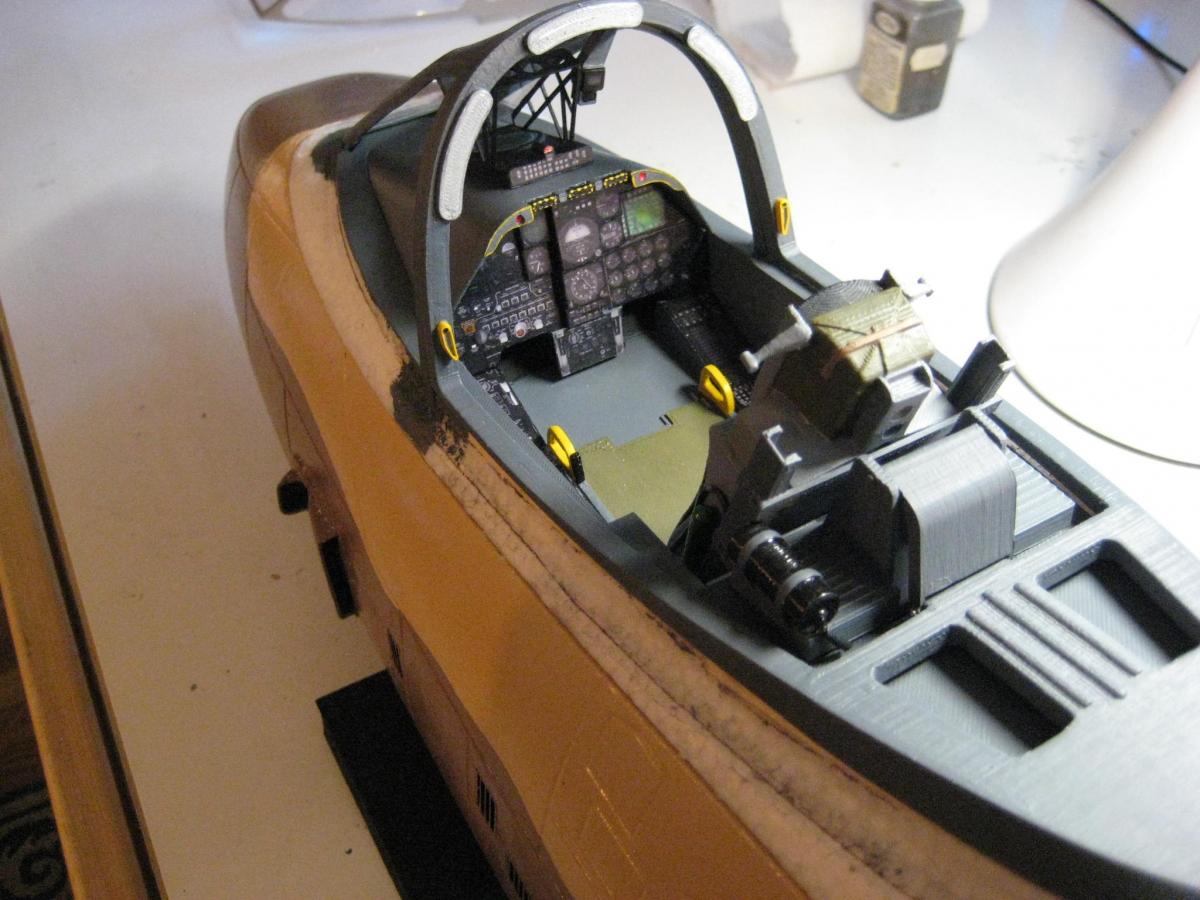

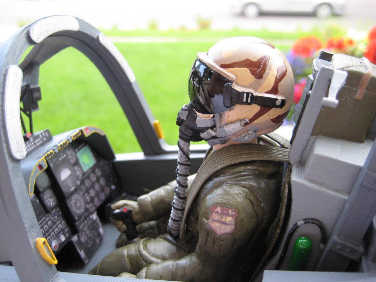

                  Thanks!!
                  Anthony

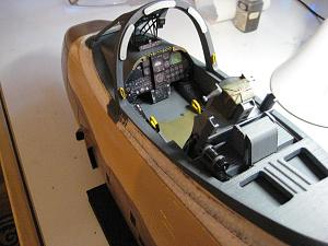

                  Don't have the FS Numbers for you, but in this case on mine, I used Lt Gull Gray for the cockpit sides and bottom and Extra Dark Sea Gray for all things black. Best, LB

                    Waconut, would you mind sharing what are you using to make the domed rivets ? Excellent work btw.
                    • Waconut
                      • Feb 2020
                      • 310
                      • Cincinnati, Ohio
                      #9810
                      Thanks!!
                      I am using Titebond wood glue drops applied with a syringe. I blunt the end of the needle and deburr it. It doesn’t take much practice to get the hang of applying the rivets but you will go cross eyed after a couple hours. I think I have between 6-8 hours over several evenings applying the domed and flush rivets.
                      The syringes I am using are 22ga. You can pick them up really cheap on Amazon.

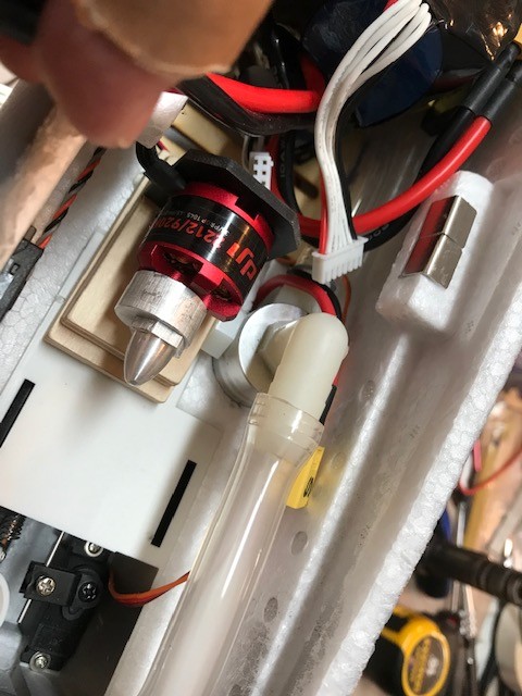

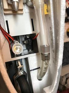

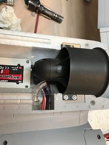

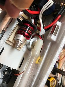

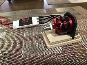

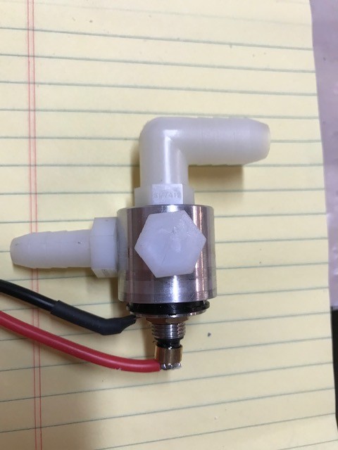

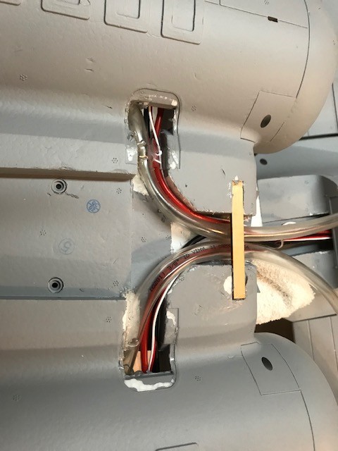

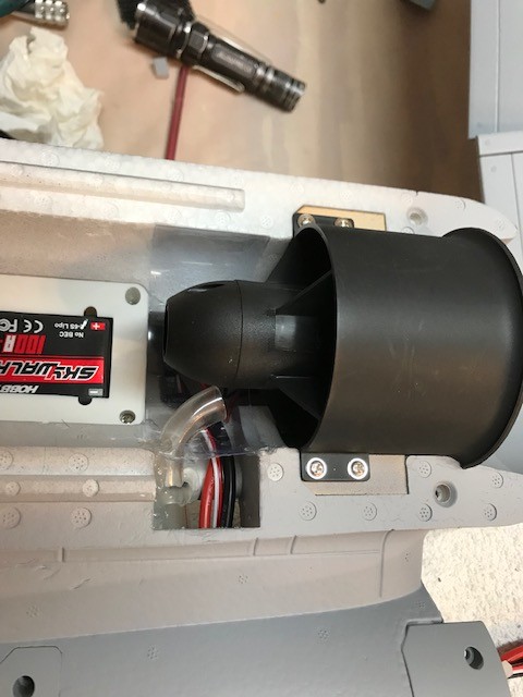

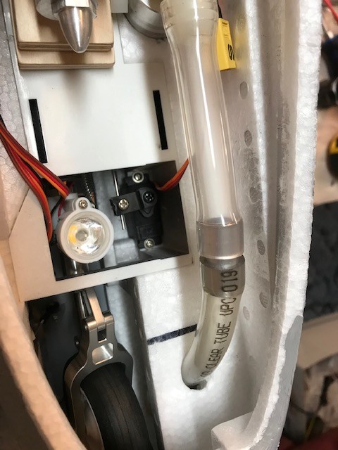

ID:	239964 Just ordered my cockpit kit. Been working on the smoke cannon and gun sound. Smoke is forced to the gun nose by EDF flow. E-cigarette heating coils. Sound is made by spinning an offset (off balance) motor. Vibrates the whole fuselage! I'll video the first test and post it. This is FUN!!! LOL https://www.youtube.com/watch?v=imGfA3SF30c
                        Click image for larger version  Name:	A-10 smoke 2.jpg Views:	0 Size:	60.6 KB ID:	239876Click image for larger version  Name:	A-10 gun sound.jpg Views:	0 Size:	126.6 KB ID:	239875Click image for larger version  Name:	A-10 smoke 1.jpg Views:	0 Size:	60.1 KB ID:	239874
                          Elbee commented
                          Editing a comment
                          Great work. That's a lot of 'vapor'. Now I know what to do with all my old coils. Also, logical/clever to use the EDF for power. Bravo Zulu. Best, LB

                        WOW! That looks so cool, I thought the pilot was going to climb out and walk away!
                          • 4816
                          #9813
                          He did after the initial check ride, but I promised him no more rolls on take-off and an extra week of vacation. Thanks for the compliment. Did you order your cockpit from Dirty Dee? Also, I misspoke about painting all the black with Extra Dark Sea Gray. I used Tamiya's Rubber Black on the IP and then sprayed a matte clear to soften the color some. Best, LB

                              I have to ask, does the vap smell like spent gun powder?

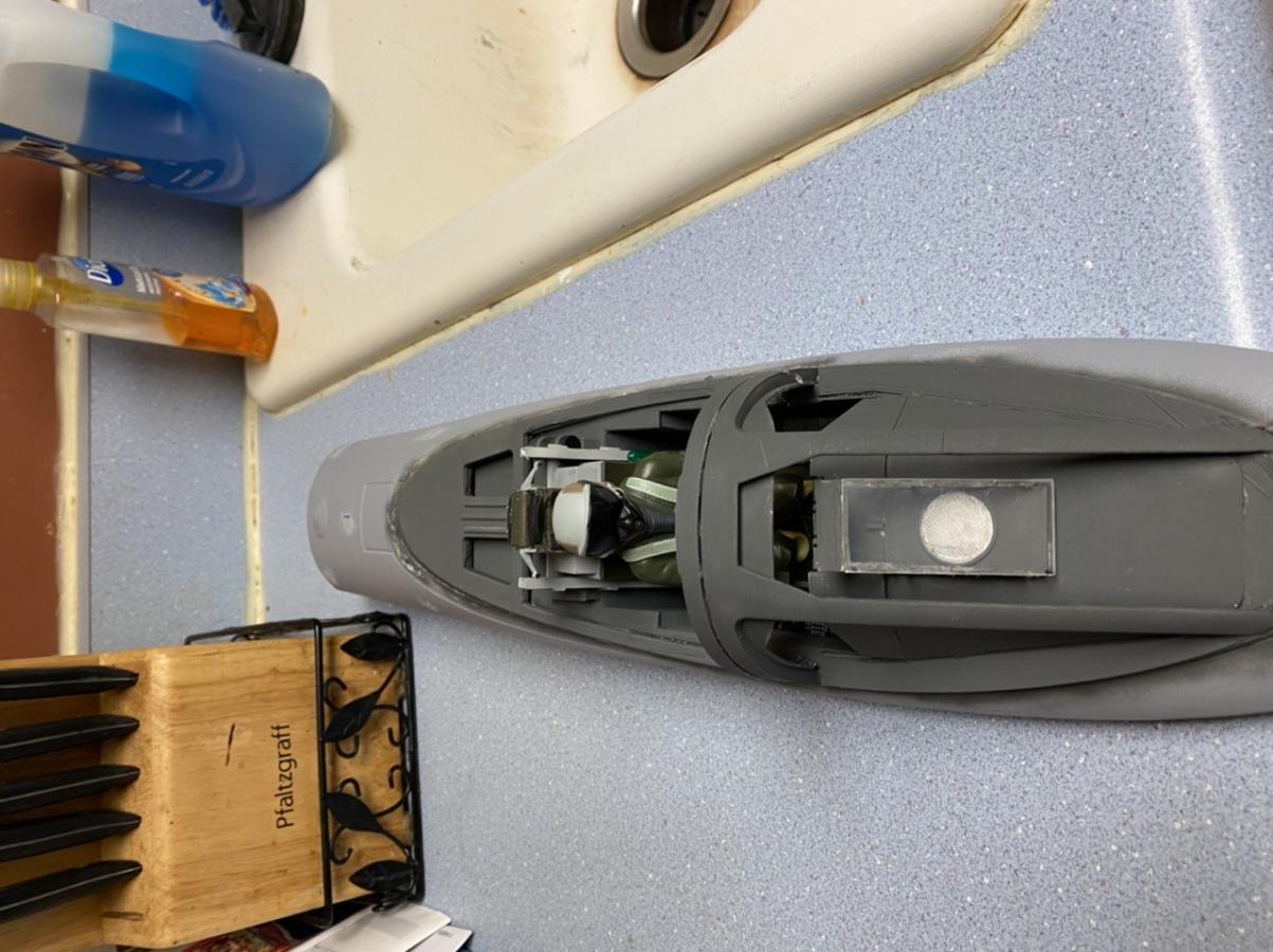

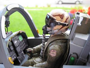

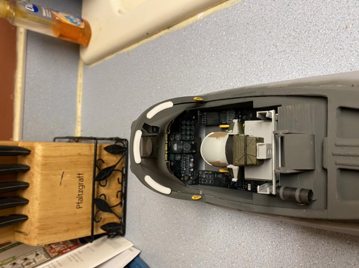

                                I received my cockpit kit from Dirty Dee on Monday. It sure does make a world of difference when finished. My JHH 1/10 scale pilot will not ship until next week. I set the stock pilot in just to see how it looks.

                                  #9817
                                  Warthog-
                                  Brilliant work on the cannon, seriously. Some questions: Where is the vape oil stored and what battery is used to heat the coils? Speaking of batteries, it looks from your pics like its getting crowded up front where the 6s flight batteries normally reside with the cannon motor and plumbing. Can I ask what your plan is for those? Inquiring minds and all....
                                  Thanks!
                                    WN, WOW, Looking great. Very nice work, Sir. Best, LB

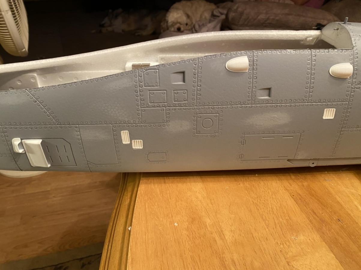

                                      I installed the fuselage vents today. Not as tough of a job as I figured. The large dome vents are functional. The smaller inlet vents are not.
                                      I found out today I am going to have back surgery, I really would like to get the top painted before that happens. I may need to just mask off the cockpit area and get it done.

                                        Originally posted by gravity tester
                                        Warthog-
                                        Thanks!
                                        I'm just finishing things up. I'll post more photos very soon. One tip, if your going to use the EDF flow for the power. You only need one line from one EDF. I found out the hard way that one works way better than two!
                                        I use a 2S LiPo to power the e-cigarette coils. There is no oil tank. Just soak the cotton real good before you fly. I stacked the 6S's and the CG is about dead on!
