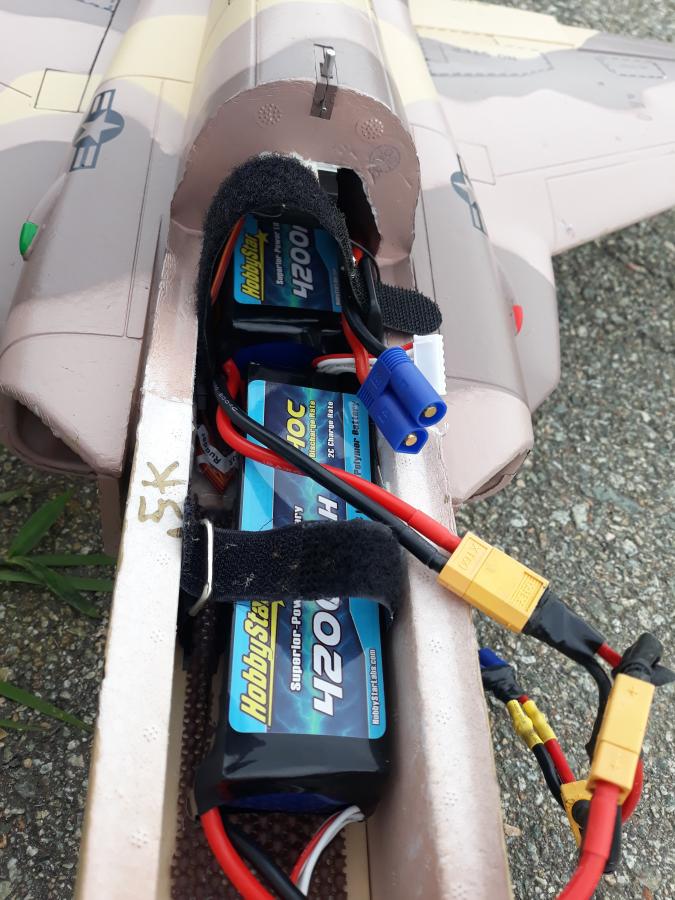

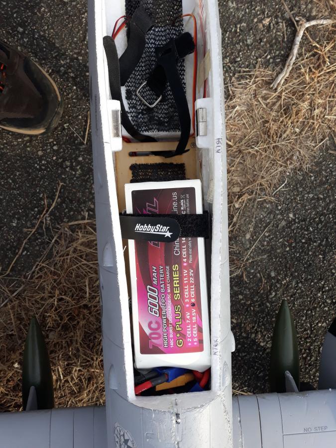

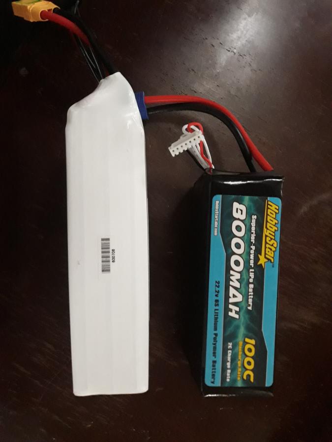

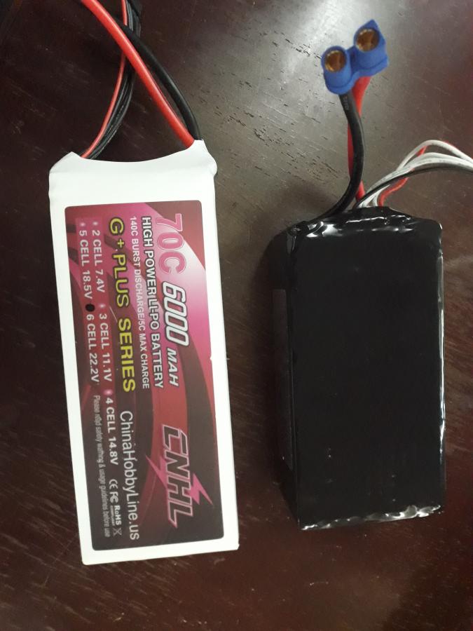

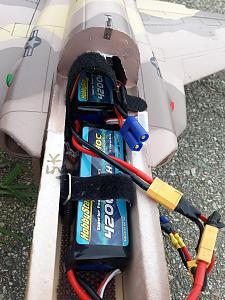

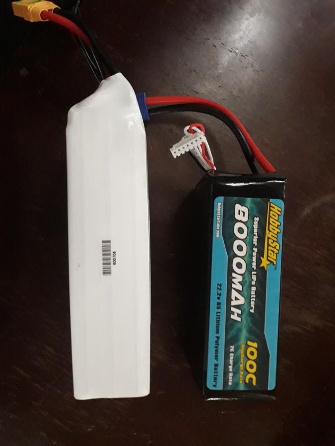

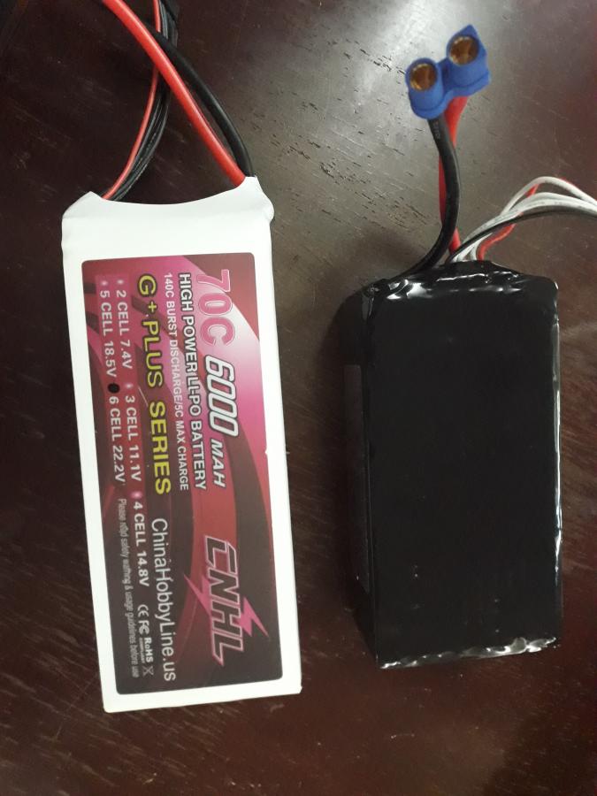

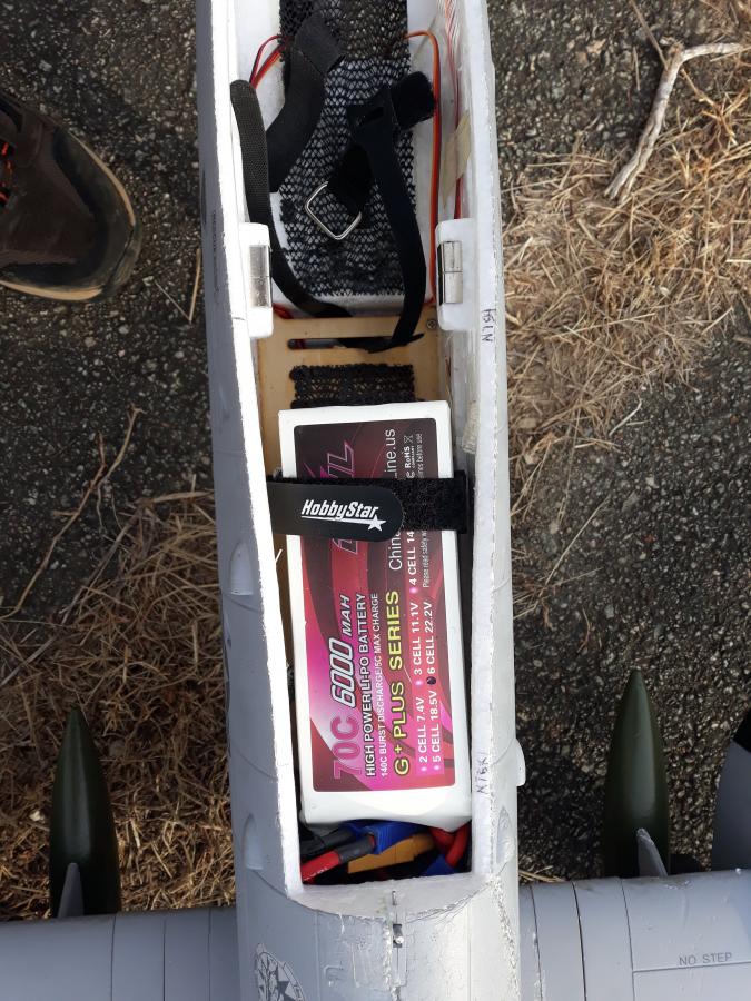

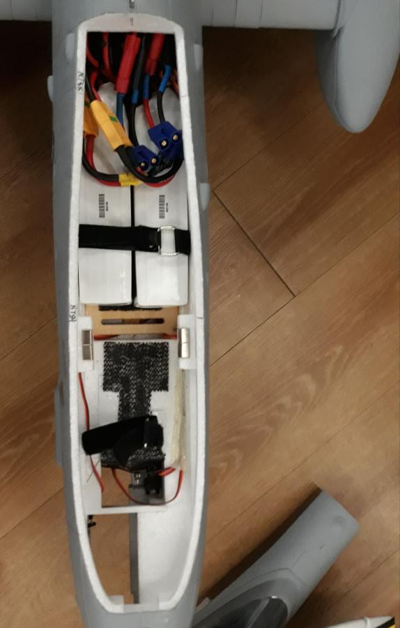

        6 plus minute flight times easily, I don't use anymore throttle than I would with a pair of 5000mah packs in there. I use the RC Juice Hobbystar 8000mah 6s 100C packs. The aircraft couldn't care less about the extra weight, the only change I notice, and it is a slight change, I feel like I might get a little less vertical out of her. But I'm arguing/convincing myself about that half the time lol. I moved the CG way back and fly her gear down configuration at about 12 to 15mm back from what the book calls for. Once the gear swings for the CG moves slightly forward. But with this bird aft CG really benefits the landings.
        I fly her with 6000mah to 8400mah packs. My front battery strap hasn't been used since my 12th flight and I'm about 70 flights in now. With the added weight and the fact that she carries her energy so well I can go completely off the throttle for certain manuever much earlier and get back on the throttle much later. An example would be at the top of a loop. I can cut the throttle sooner, complete the rest of the loop throttle off and half enough energy to start my climb for my next maneuver and delay 2 additional seconds before I bring the power back on line. The A-10 is a fantastic bird to practice energy management with if your so inclined.
        I have moved the CG back on all my FW birds with positive results. I fly many with up to 8400mah even my F-5 see pic for placement. My 6000mah to 8000mah packs in the A-10 sit side by side towards the back of the battery compartment, again see pics.

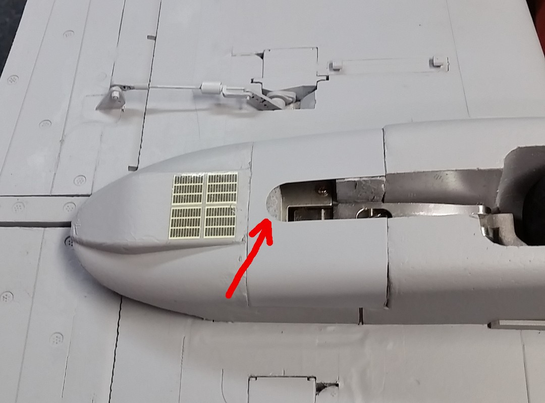

                • Hey guys, while we're on the subject of bashing landing gears.... (well that's what it reminded me about) let me share something I did.
                  I'm sure many of us have seen how over time, the LG struts seem to become loose or wobbly. This can happen when the set screws on the LG leg have become a bit loose (yes that happens and you need to Loctite those buggers), and it can also happen if the plastic retract unit becomes slightly worn from the metal trunnion (or in a bad case, the retract case can have a crack that you may not notice).
                  So especially on the nose gears on many FW planes, we have installed 3D-printed plastic braces to help stop the LG strut from being forced backwards. The brace helps protect the retract unit and also helps reduce the amount of "wobble".
                  Ok where am I going with this... my A10's main gear (stock) were quite wobbly so I took them out for service. First thing I did was tighten those set screws, which were loose, and that stopped most of the wobble but there was still some.
                  So then I was looking around in Thingiverse and unfortunately no one has made a 3D brace for the main gear.
                  So what I did was cut a square chunk of EPP foam and glued it in as a "backstop" using Foam-tac, in order to brace the strut.
                  Here is a picture showing the location of the foam on my bird. (The gear is retracted in the photo)
                  The plastic cover will peel off and can be easily re-installed with Foam-Tac. But you don't have to remove the cover to install the piece of foam.
                  Its a very simple thing which stops the wobble and will also help protect the retract unit in a hard landing.

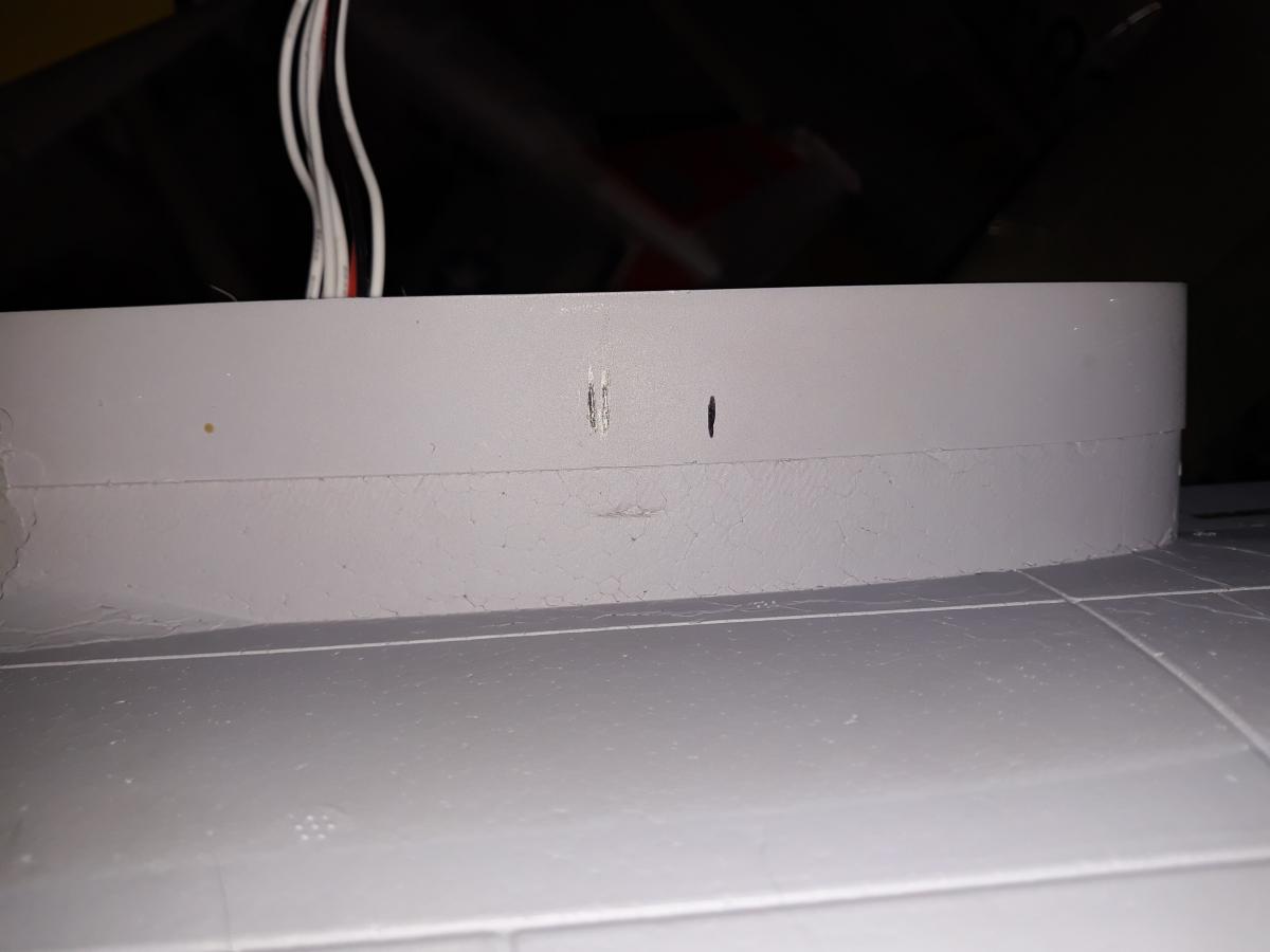

                        I fly her 91mm to 93mm back, CG checked upside gear extended. I use 91mm for strong wind and X wind days and 93mm for light wind to no wind days. Makes for easy rotations and touch down on the mains and mains only! The nose then follows touching down as ground speed decreases.
                        Remember the CG swings forward with the gear in flight. In the pic you can see my marks in the wing root. The mark by itself is the 78mm, the other 2 are the 91mm and 93mm marks. Click image for larger version
