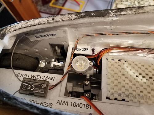

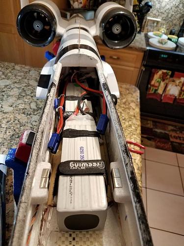

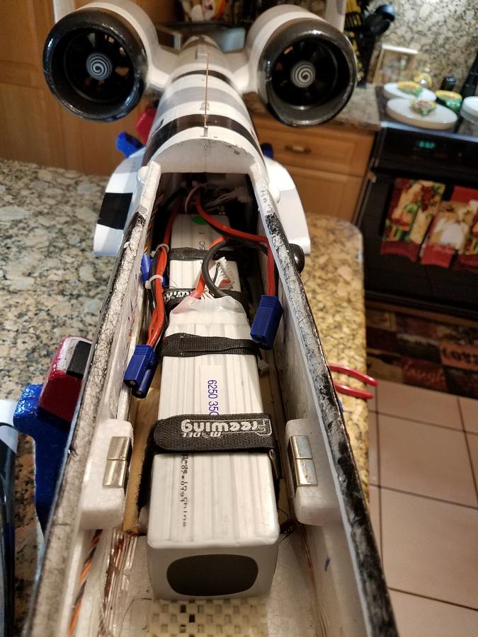

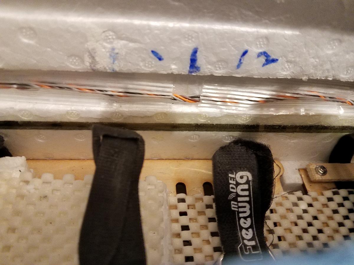

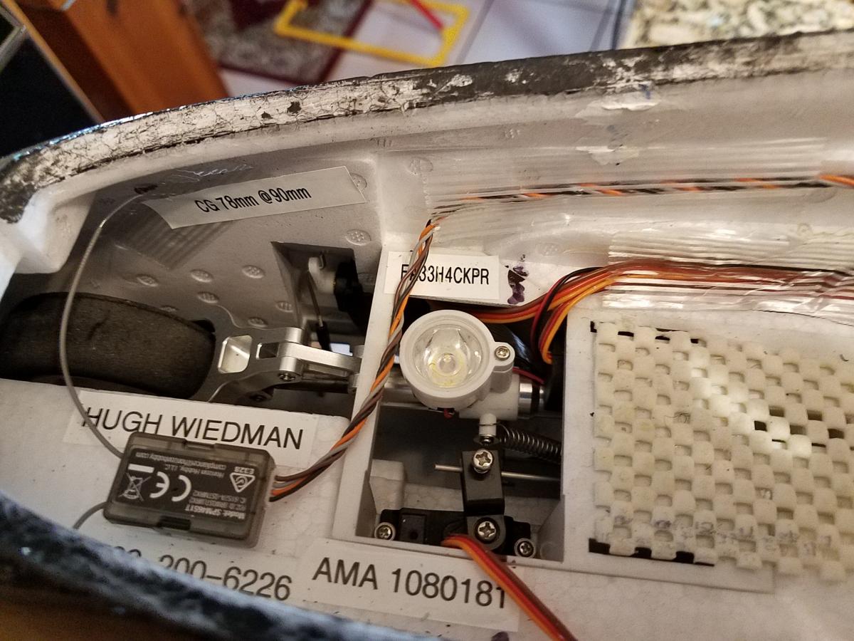

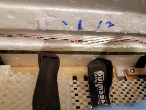

                          For what it's worth, 1st: shows location of the rods (you'll see it when you get the aircraft), 2nd is the location of my satellite, and 3rd is my very very rear located battery placement. RX and antennae for that located behind the aft battery.
ID:	306244Click image for larger version
ID:	306245Click image for larger version

                            Thanks for the pics HW that was very helpful!

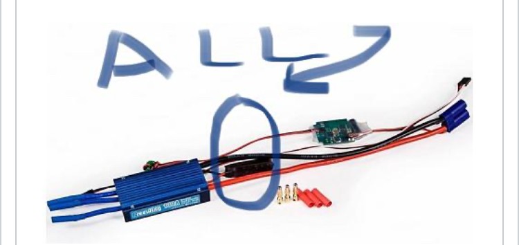

                              GFSPilot - Found this pix...helpful perhaps. It is a suggestion for where to place the clip-on RF chokes. Which side of the ESC, that is. Keep them as close to the ESC as possible. “All” means all these wires need to go through a choke.
                              You can route more than one wire through a choke. I even added a small choke near the green ring choke on the throttle wire....placed it next to the green ring choke. Can’t hurt....but possibly overkill.
                              Additional places to consider....place a clip-on choke near the servo on any long running servo wires. Again....could be overkill, but it can’t hurt.

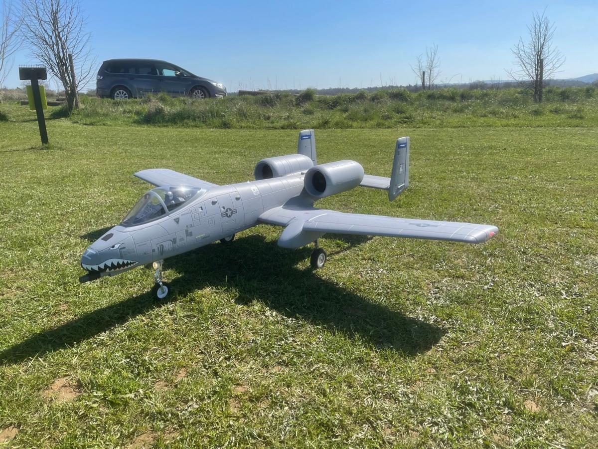

                                Hi all,
                                Flew my hog again today with the new innrunner setup, sounded great but the flight time was short, 3-minutes at best.
                                I have also shuffled the CG back 10-15mm and it's now PERFECT.
                                I fitted an Eagle A3 Super 3 gyro to her and tested it for the first time today, the results were out of this world, I'm almost embarassed to land the A-10 now as I don't really have to do a lot more than ensure she follows the glide slope.
                                Winds were reasonably high for the test, 15mph gusting to 25mph, albeit straight down the runway.

                                  Nice looking Hog Andy. Surprised you're only getting 3 minutes on her. I'm using the original Stock 9 blade 1900 Kv outrunners powered by 2 RT 6250 35 C batteries and get 5 minutes of very aggressive flying in with lots of vertical maneuvers all with the full ordinance package. Mine is also a bit heavier than stock with the Dirty Dee 3D cockpit and I have it balanced at 92-94 mm, with both batteries shoved as far aft as possible after removing the circuit board and sticking it on the port fuselage wall. The relatively long flight time of 5 minutes for an EDF is one of the many things I love about this beast.
                                  What's so different in your set-up that you're ending up with 40% less flight time? We need to keep you in the air longer, sooo many juicy targets to go after and so little time!
                                  BTW, glad our English Brothers are back in the air, it was very lonely up there without you!

                                    Hi Hugh, that’s very kind of you, she’s pretty much as stock as she comes but I love her all the same. After arm wrestling the sharks mouth waterslide to the front of her I pretty much needed therapy afterwards 🤪
                                    Not sure what’s going on with the flight times, I seem to remember getting nearly 6-minutes out of the outrunners. These are the 9-blade inrunners which I had hoped would give me longer... that worked out well then 🤣
                                    C’est la vie!
                                    Andy
