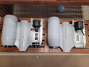

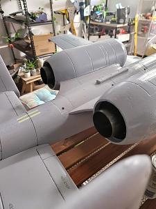

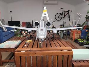

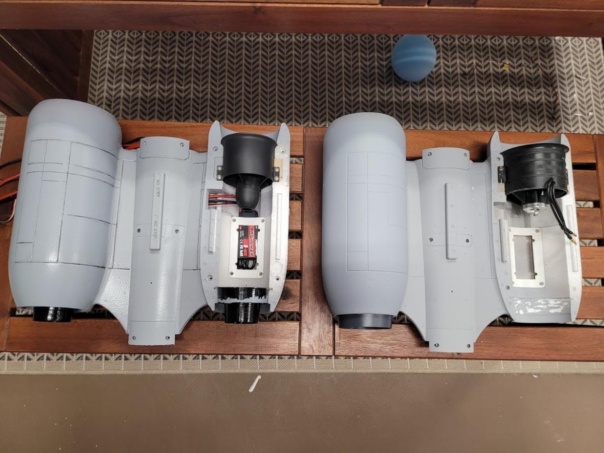

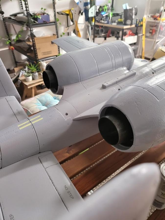

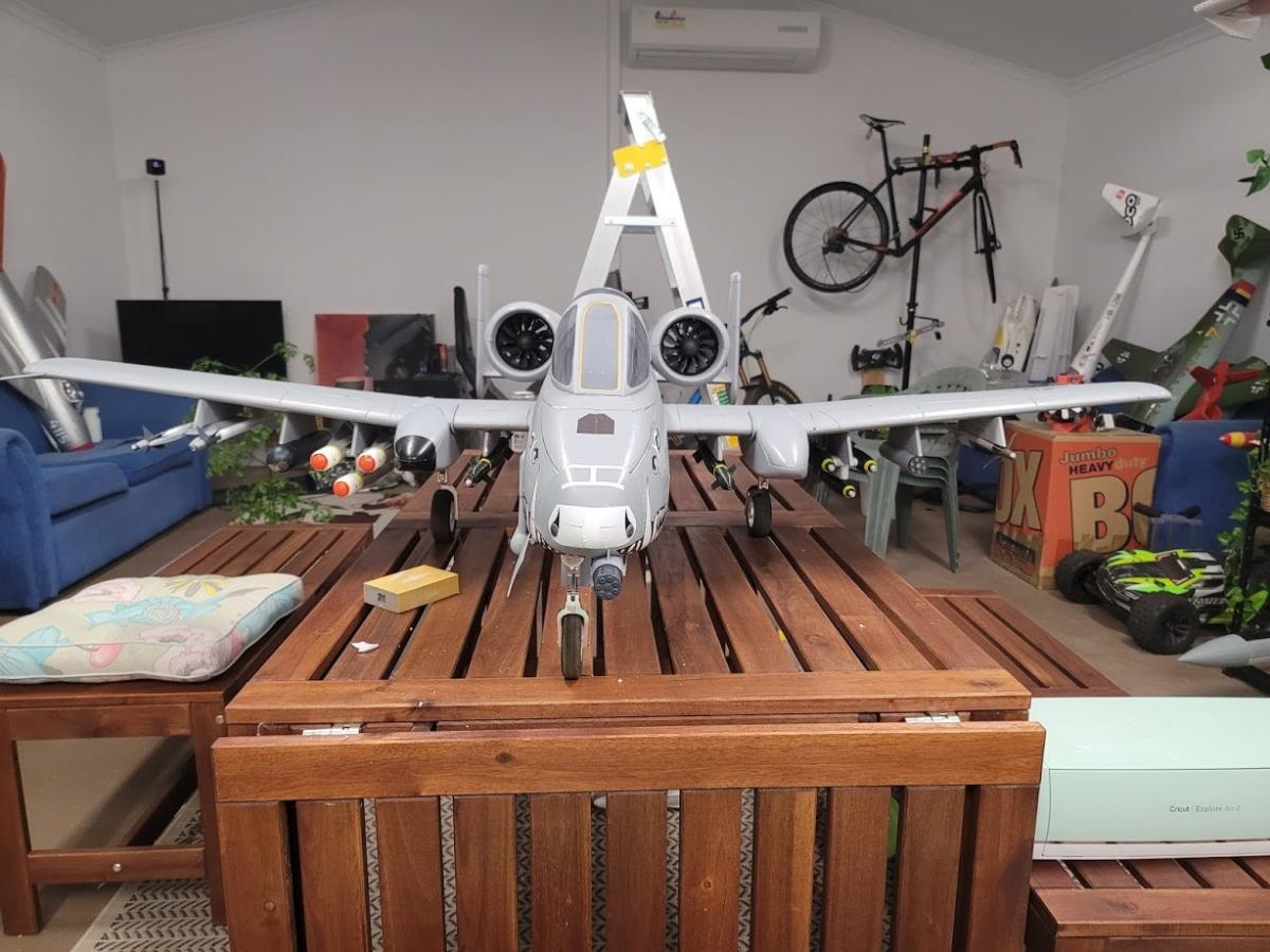

                Thought I'd share some experiences fitting the 90mm nacelles. Had my eye on the stock 80mm outrunners as a mild upgrade for the F-14 and was going to then swap in the 80A power systems from the F-14 given the A-10 flies so well on low power. But then I came to my senses.
                Sourced a pair of low-amp AF model 90mm fans (used and well regarded in the Avios Mig 17). This is a 1550kv 12bl EDF. With peak draw around 100A I was able to retain the stock ESCs, which is handy given they are already configured for the long battery leads (cap packs installed) and obviously drop straight into the ESC pockets in the nacelles. Required some carving, the fit is closer to an FMS housing than a freewing one.
                Having become accustomed to the revised thrust line using Dirty Dee's 3DP exhaust nozzles, I was keen to replicate this for the 90mm nacelles and succesfully scaled them up.
                The end result is a decent bump in peak performance (~3.7kg thrust a side) but surprisingly a more efficient setup which will cruise at 25% throttle and deliver flight times comparable, if not better, than the stock 80mm setup. And the sound is stunning. Im not much of a content creator but here's some flyby clips.
                So, absolutely recommend low current draw 90mm for this plane.
                A few picts of the install, nozzles and finished product.

                    Thanks for the review, your plane sounds amazing!! Of course Motion offers a nice 12-blade 90mm EDF which will fit in the 90mm nacelles without any modification.
                    This is the 4068-1835 motor. Could you please comment, in terms of current draw how does that choice compare to the "low-amp AF model 90mm fans" that you used?
                    Did you use the AF model because it draws significantly less amps than the 4068-1835?
                    (Note to MRC, why is the current draw missing from the product page? Why leave that off?)

                        #10871
                        I'll be honest - I had these af units lying around. OK. Maybe they weren't lying around, maybe they were installed in planes and I've been playing musical chairs with EDF setups. Point being, I had two of them. But, I knew they were spec'd to run a 100A ESC, which meant I could use the stock ESCs in the A-10 (which are probably over spec'd to be honest - many thanks freewing). This is a big deal because they already have the capacitor packs installed to deal with the long battery leads (again - many thanks freewing!).
                        I havent used the motor you listed but on paper it would make more power at the cost of higher current draw. It is spec'd for a 130A ESC. I think freewing themselves have pivoted to a 1900kv 9bl for their high performance 90mm setup? I imagine the newer powerplant is more efficient given the motor size and blade count - if I was choosing something off of freewing's menu that's probably where I'd land. Lower blade count might not have the whoosh factor but then you'd get some of that back from the high kV (1900kv is approaching 80mm territory!).
                        It depends what youre looking for I guess. The stock A-10 80mm EDFs are already overkill, I swear the thing would fly on 4S, it defies logic how a 6kg+ plane scoots around with such little power. For me, I'm pretty much flying circuits and presenting with a plane this gorgeous, so I prioritise flight times above all else. But also... a twin 90mm is just inherently sick. What other manufacturer would be mad enough to offer a drop in option like that? The sound, performance and flight times have surprised me - to be frank these af setups are cheap and nasty compared to a freewing or FMS unit. Guess we'll see how they hold up over the long term.
                        You can find the specs for freewing EDFs in other corners of the internet but, for the reasons Tom mentioned, take them with a grain of salt. As an example, the setup in my FW Sukhoi can vary by 300g and 30A just by changing timing settings on the ESCs. Different planes will respond differently to the same motor as well due to ducting differences - stuff which very smart people like Alpha understands, and I do not.
