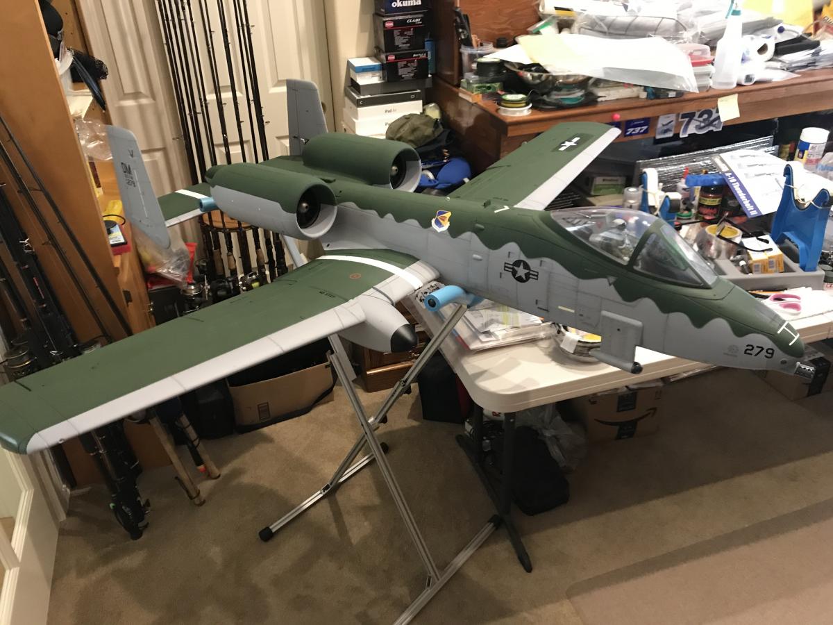

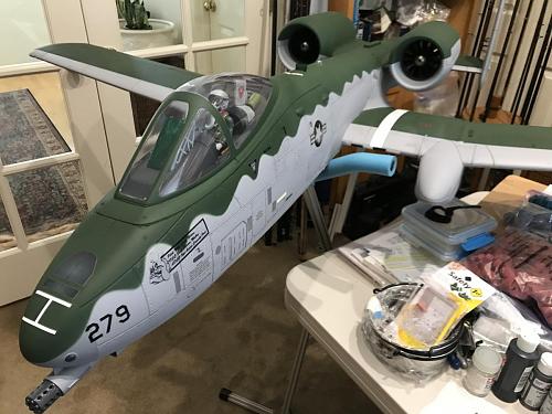

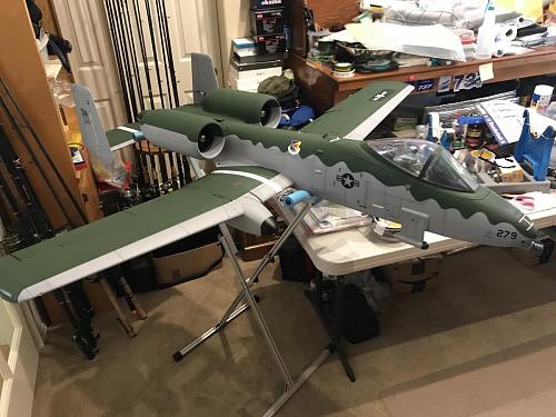

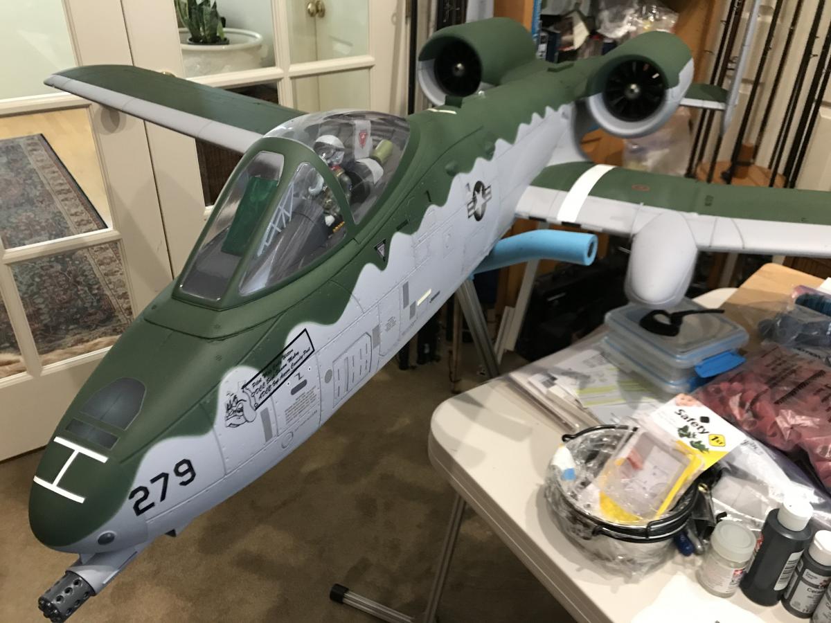

ID:	317919Click image for larger version
ID:	317920 Awesome looking bird.. thanks for your help. Mine is still coming along... Click image for larger version

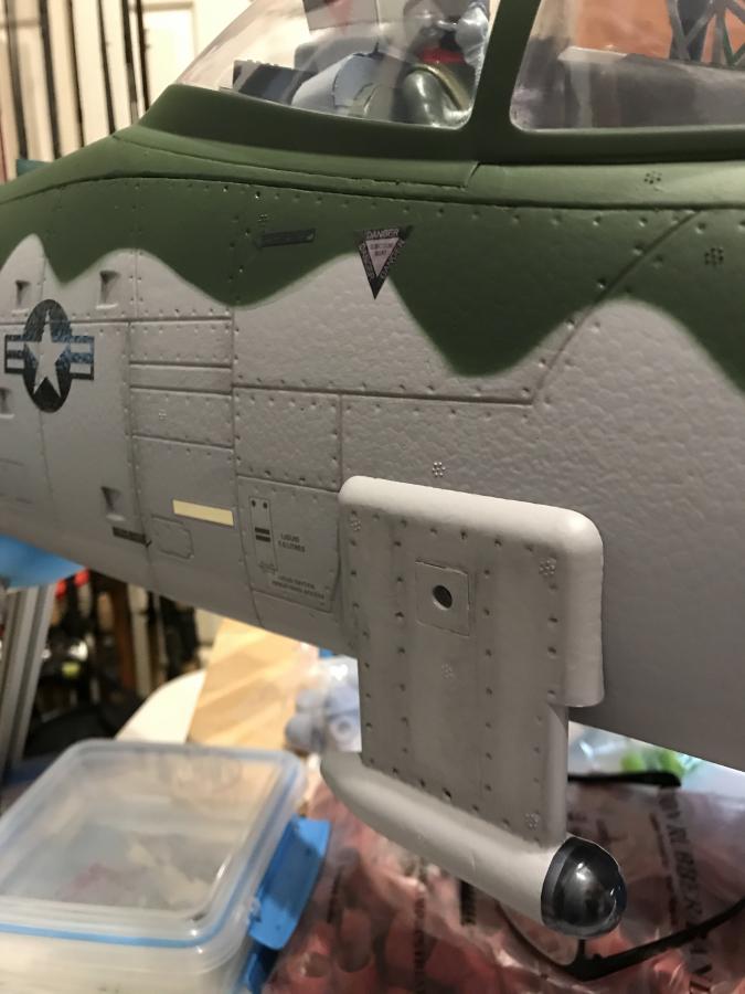

        • 2691
        #10923
        Originally posted by Tom Lasko
        Click image for larger version  Name:	F4222EE7-42C5-4CC8-BA14-A727042E9F8B.jpeg Views:	0 Size:	136.8 KB ID:	317919Click image for larger version  Name:	D6DCD6F9-7387-4604-9880-B0E40B9B22F7.jpeg Views:	0 Size:	127.3 KB ID:	317920 Awesome looking bird.. thanks for your help. Mine is still coming along... Click image for larger version  Name:	A46D774A-6258-472F-9C50-C9588EA9ABBE.jpeg Views:	0 Size:	59.3 KB ID:	317918
        Hogs are Wild!! Outstanding work, I love that scheme. Nice rivet work!

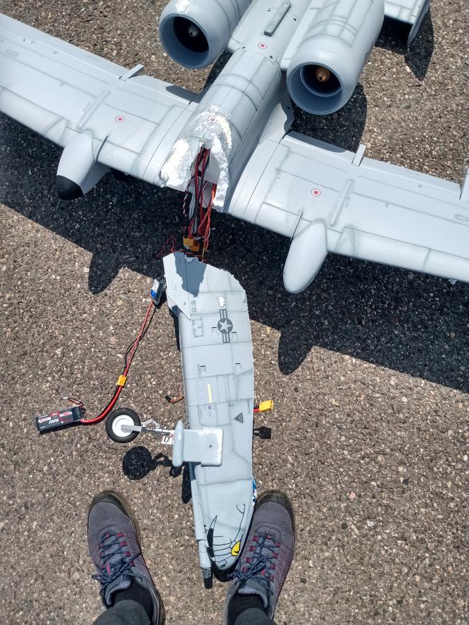

                      #10930
                      About the tenth landing. I left the original chassis. I have never experienced such a jumper. Normal landing, but a little higher speed. Hop, hop, hop and the end ....
                        • 8747
                        #10931
                        Been there, done that. Repaired and it flies again. That was fairly typical (bouncy landings) when this plane first came out, but it still happens.

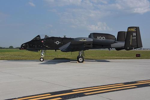

                                        This one goes against all foam paint practices but I’m going for it. Will build out my backup A10 with this Cenntinial 100 year ING scheme and twin 90mm fan upgrade.
