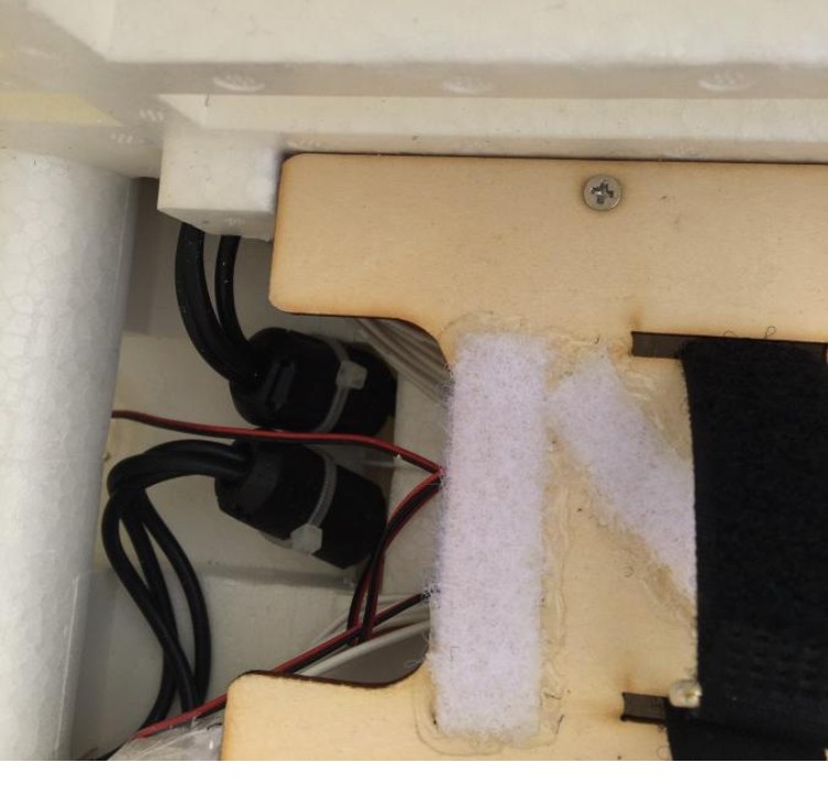

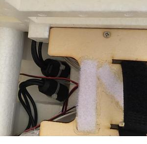

    I checked on Amazon for the RF chokes, and there are different size and brands. Is there a particular one that we suppose to get?

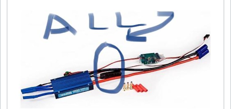

    Get a variety pack….example;
    Install them as close to the ESC as possible on “ALL” the wires shown. One larger choke can have several wires running thru it. Pick the ones that fit the space. Larger chokes provide better function. Since the ESCs are in each nacelle, install the chokes as near each nacelle as possible.
    For good measure, put a small one near the green ring choke, too. It can’t hurt.
    Click image for larger version  Name:	2E7AF022-2071-42D8-BB58-67EE7C3DBBB4.jpeg Views:	0 Size:	37.0 KB ID:	350434
    Below is an example of the installation on the AL37. The ESCs are just below the battery tray area. You can see how several wires run thru one choke.
    Note: The photo below shows the motor side of the ESCs.
    You don’t need chokes on the motor side wiring. The motor side puts out less RF noise. The other side of the ESCs is more important to choke. In the AL37, both sides of the ESCs are easy to get to, and it can’t hurt to choke both sides of the ESCs.
    I add extra security with zip ties to keep them clamped shut.
    -GG

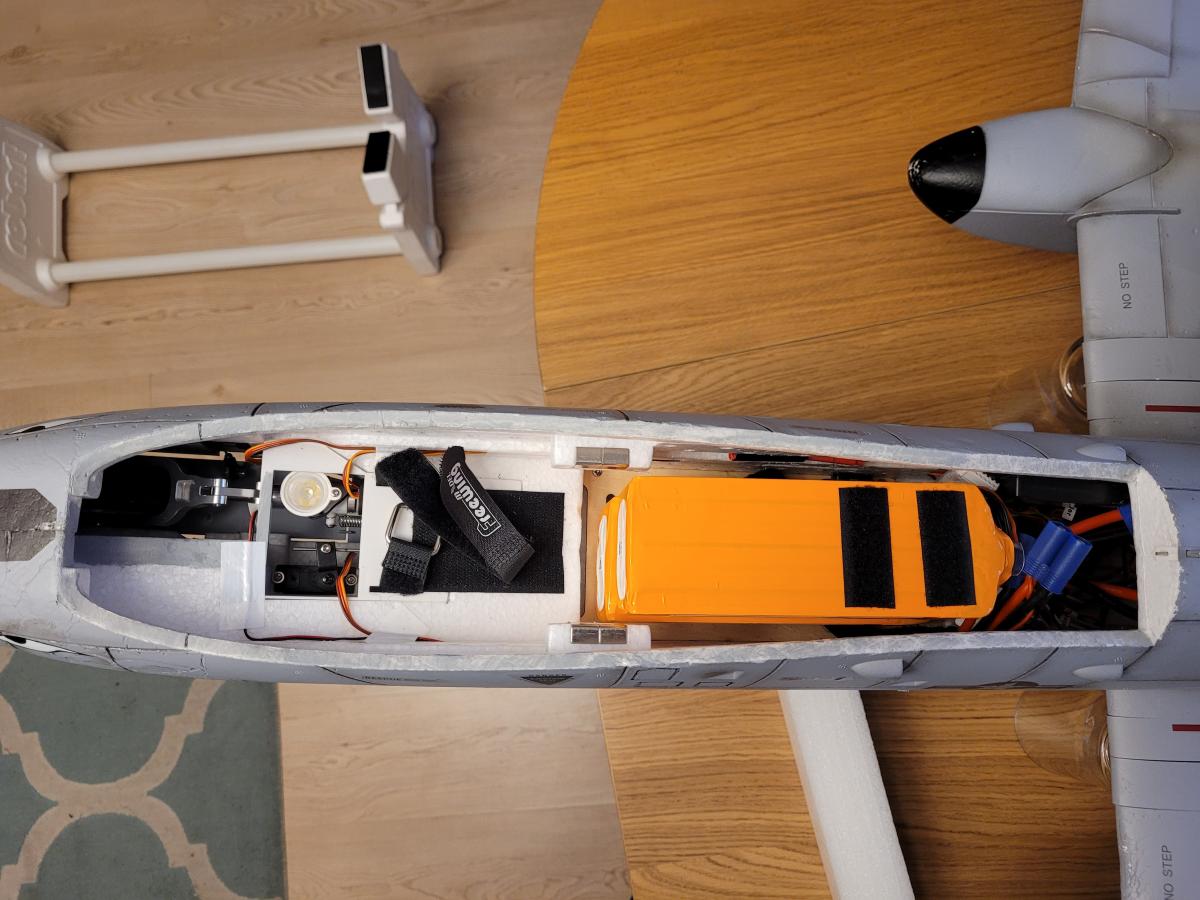

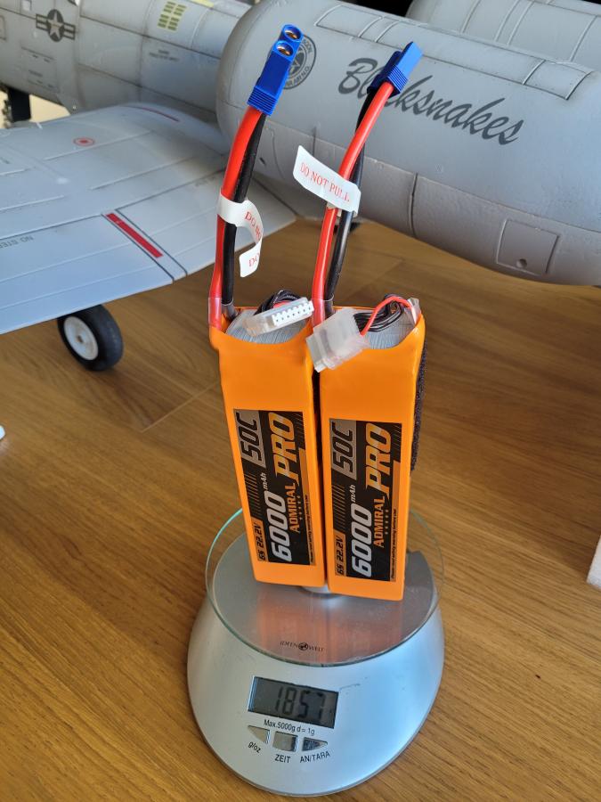

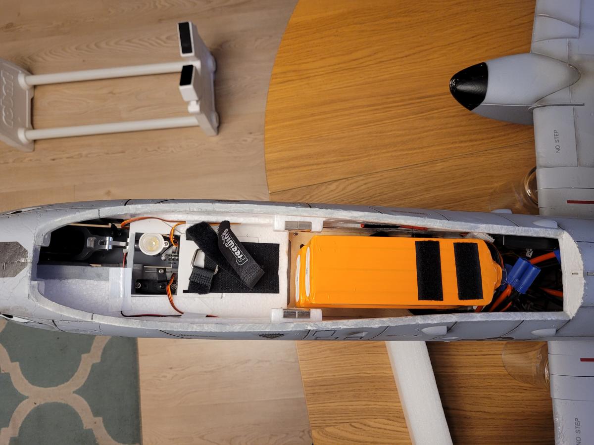

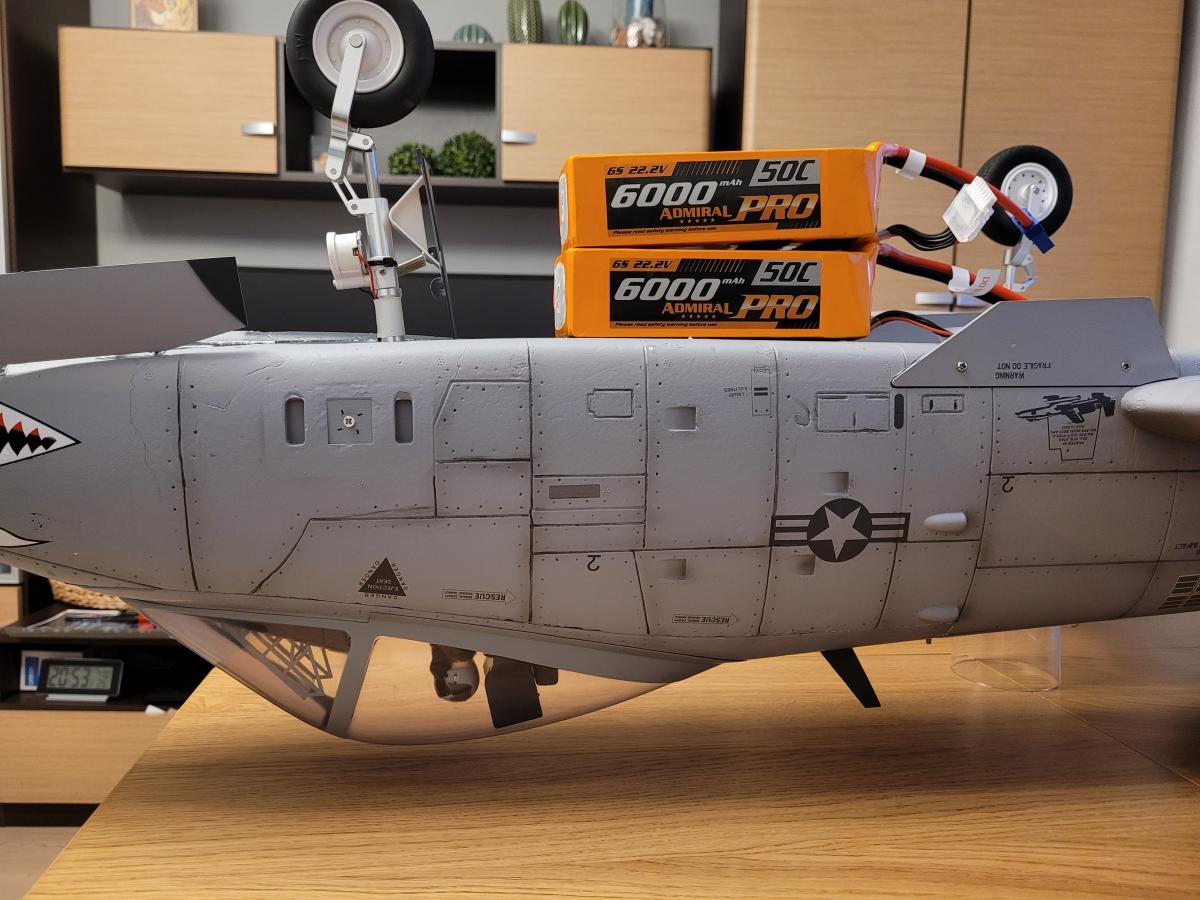

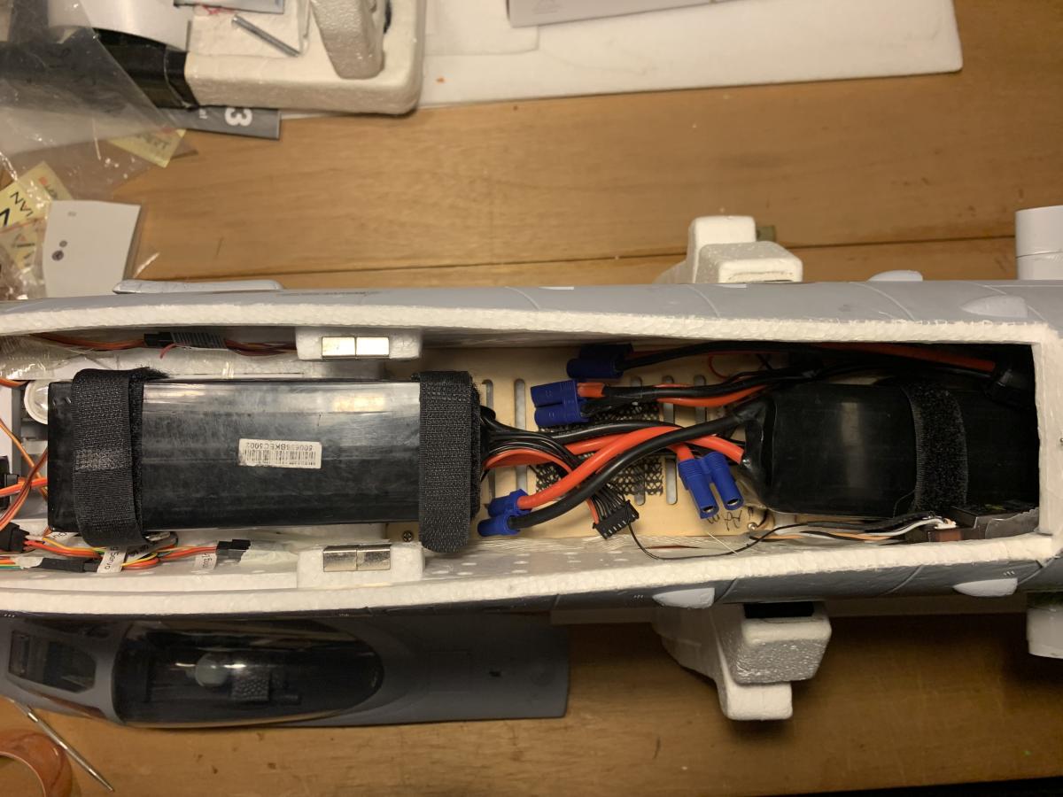

                    • I have a problem with setting the center of gravity using 6s 6000mAh Admira Pro batteries. For the CG 78mm (as in the instructions) I have to put the batteries on top of each other - as in the picture.
                      Please show photos with the installed batteries in your models.

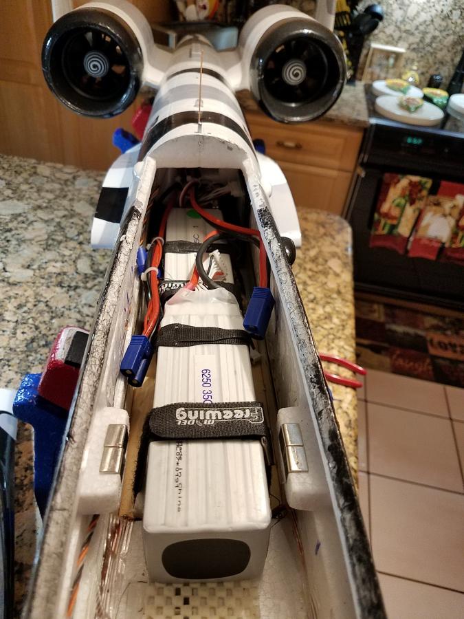

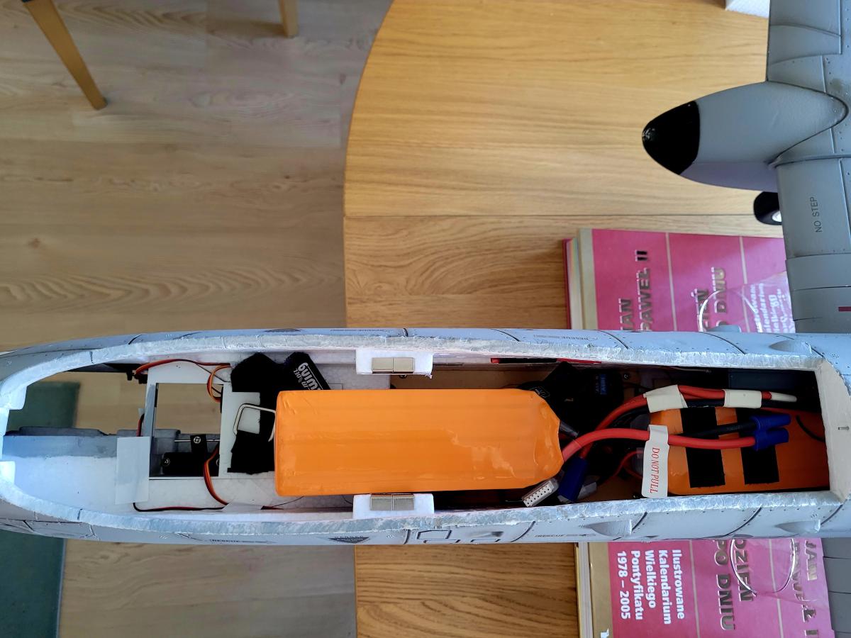

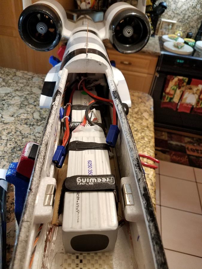

                      • 1. The better CG for this plane is actually around 90mm.
                        2. The recommended batteries are from 4000 to 6000. If you use Admirals, this gives a range of between 566g to as much as 900g. You have to use some innovative thinking if you are going with a heavy battery like the 6000 Admiral. In the following picture, I'm using CHL 5000's, weighing in at 805g each. Notice where the rear battery is. To get that battery back there, the control box must be detached and pushed as far back against the rear bulkhead as possible. This is way I did it. If you choose to use the 6000's, then you will have to mount the front battery a bit further back than you see in my picture, which means you will have to build yourself a slightly elevated battery shelf further rearward than what you see in the picture. (I already have a small shelf under the rear portion of the front battery.) Nevertheless, as you can see, there is still quite a bit of room between my two batteries that can be used for the front battery placement.

                        • Originally posted by RAFALR30 View Post
                          Don't know if this will help, but I fly mine balanced at 92mm as I've found it flies and lands much better further aft from the recommended 78mm balance point. For me, further aft allows me to land with full flaps at a slower speed while keeping the nose slightly up avoiding hitting the front nose gear first and causing the dreaded "bucking bronco". Using the 45 degree method of checking the balance, it seemed just right around 92mm. I'm now using 2 SMC 6200 mah 40C packs, each weighing 814 gr. If I remember, the Admiral 6000 packs weigh a bit more at 840gr. To be able to move the batteries further aft and get to 92mm, I removed the circuit board and stuck it to the port side of the fuselage, allowing the aft battery to go all the way in. The photo below was when I used to use the Roaring Top 6250's, weighing about the same at 800 gr. Had to also put in a foam extension for the front battery base for the step down there and added new velcro strap positions so each had 2.
                          I also did the 3D printed "Dirty Dee" cockpit and put the 1/10 scale JHH full body pilot which added a little more nose weight. Also changed the stock outrunners to the 9 blade 1920 Kv inrunners from my Mig 29, which offset that just a bit, so keeping everything stock, you should be able to position the batteries further back and achieve your desired CG by getting that circuit board off the floor. I would recommend you start around 84-86mm or more instead of 78mm, but that's just my opinion.

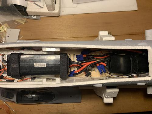

                          • Per Hugh’s recommendation I’d recommend starting at 85mm or close to it as well. I maiden my second A-10 last week at 85mm flaps up due to a flap issue and the rotation was really sweet, no lurching for the sky. Landing was a floater but touch down was mains first. I had to stack my SMC batteries which was not an issue. I intend to move the CG back to 92mm for the next flight.

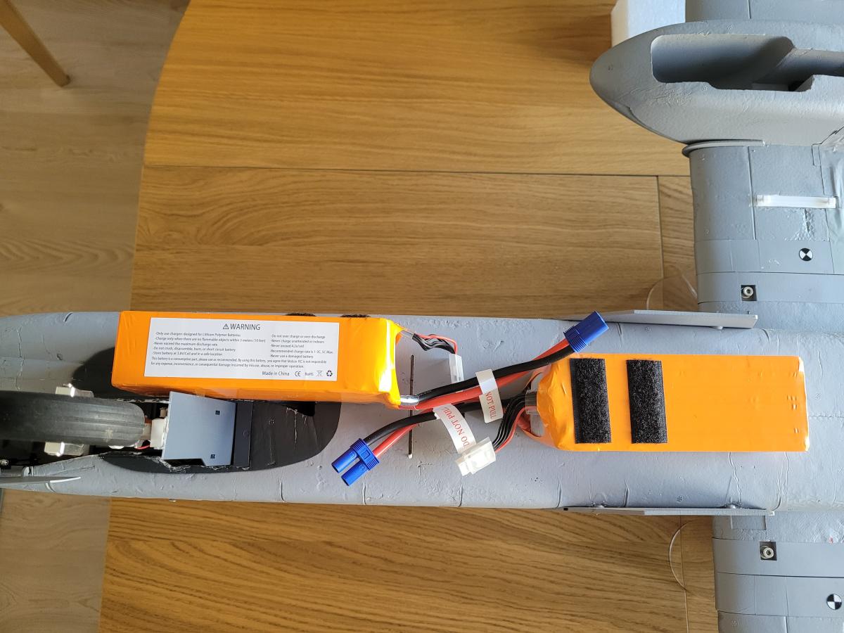

                                        • Gentlemen modelers, which version of the battery assembly will be the best for CG around 85-90mm? Batteries placed one above the other or one behind the other (necessary to disassemble the electronics board and install in other place).
