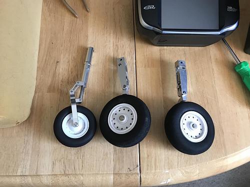

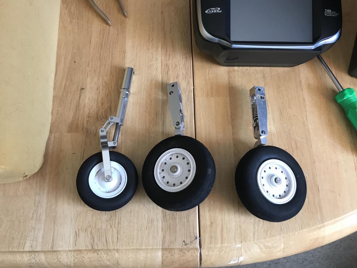

          I have a set of trailing link struts that I would like to trade off for Oleo struts.
          Thanks,
          Paul

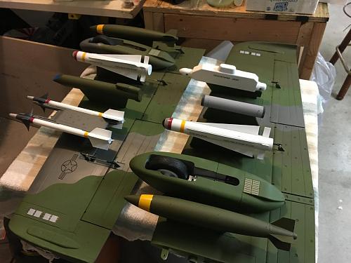

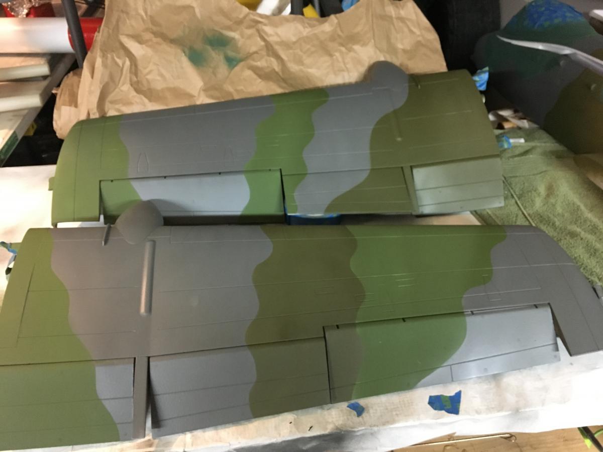

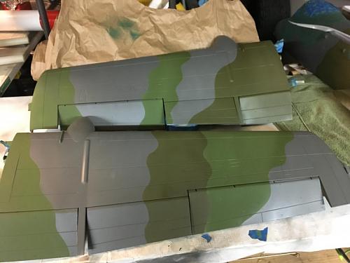

                Egad! Had no idea the original gray paint on the Freewing A-10 was so sensitive. I suspect they all are. The first couple of tries at masking with fine line tape lifted the gray up right down to the foam! Didn't know that was going to happen. So after looking up a few things on line I found a really neat masking technique using strips of material soaked in water and squeegeed out. Makes a decent edge and lifts right off the surface without lifting the paint. Then you can use a rattle can of just about anything. I've been using Rustoleum 2X which works great. Masking Link is attached.

                  HI there Bbolz, what kind of fine line tape are you using? Are you masking a straight or curved line? Many of us agree that even low tac masking tapes can still at times lift up paint from foam airplanes. One trick is to let the tape touch your pants a few times to reduce the stickiness. You want it to feel like a Post-It, but not much more sticky than that. In fact, I use Post-Its for almost all of my hard line masking work. It has never lifted paint.

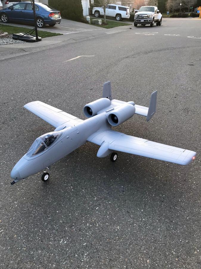

                      #9130
                      weather dependent, will be putting mine up on its maiden tomorrow or the day after. Wx here in CO may or may not cooperate, do most of you recommend the 86mm back inverted CG measurement? also, I am using a LEMON receiver with satellite ant, how are those of you that have them or use satellites mounting these? just 90degrees to the receiver ants?
                        • 8217
                        #9131
                        Good luck on your maiden! I just put mine together this evening. It's been a couple years since I had mine so I too wouldn't mind a confirmation on CG. As for me I am using an Admiral rx with satellite. I mount it along the starboard side of the inside fuse, 90 degrees, yes.
                        I plan on maidening this weekend, hopefully on grass as I don't want any Bucking Bronco landings on a maiden! :Scared:
                          #9132
                          I am running just a little over 80mm for my CG. I don't think 86 will cause you any problems. Best wishes on the maidens.

                            #9133
                            Thanks Alpha! I never thought of using postits. Yes, I need to make curves. I saw a technique on line that a guy uses strips of material soaked in water for trim masking. That works ok but is not as clean a line as fine line tape. That's the automotive trim masking that we used to use on fiberglass fuselages.
                              #9134
                              Wet newspaper also works good for masking. I have used this method several times.
                              • bbolz
                                • Mar 2019
                                • 154
                                #9135
                                Thanks! I'll try newspaper. Right now I'll try anything.

                                  #9136
                                  I used clear mat self paper made by Contact on my A-10 paint job. Picked it up at WalMart low tack and didn't pull up any of the grey.Click image for larger version  Name:	IMG_0302.JPG Views:	0 Size:	80.2 KB ID:	187233Click image for larger version  Name:	IMG_0409.JPG Views:	0 Size:	104.5 KB ID:	187234
