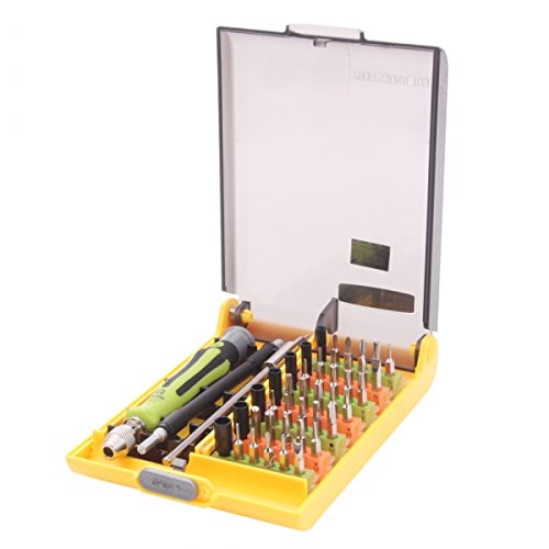

                              #9214
                              Todd,
                              I highly recommend getting this driver set:
                              https://www.amazon.com/HUIJIAQI-NO-8...gateway&sr=8-1
                              I have been using this for over 3 years and it has been awesome.Has just about every small driver head you can imagine. In fact, I love mine so much I just ordered another one as some of the allen bits are a little rounded out.
                                #9215
                                Pat you read my mind. I was going to post asking for a quality set recommendation...My allen key is that little pocket knife looking thing...I hardly think that qualifies as quality. Thank you!

                                  #9216
                                  Love that driver set. I'm going to get one. Also, just use a longer hardened set screw and grind the excess off flush or almost flush. Punch a dent in it with a set point so you could drill it out in the future if need be. And, use locktight.
