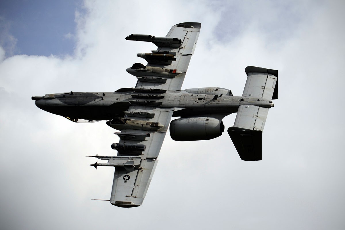

    Here's a belly shot of the A-10.

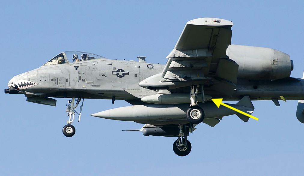

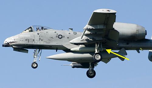

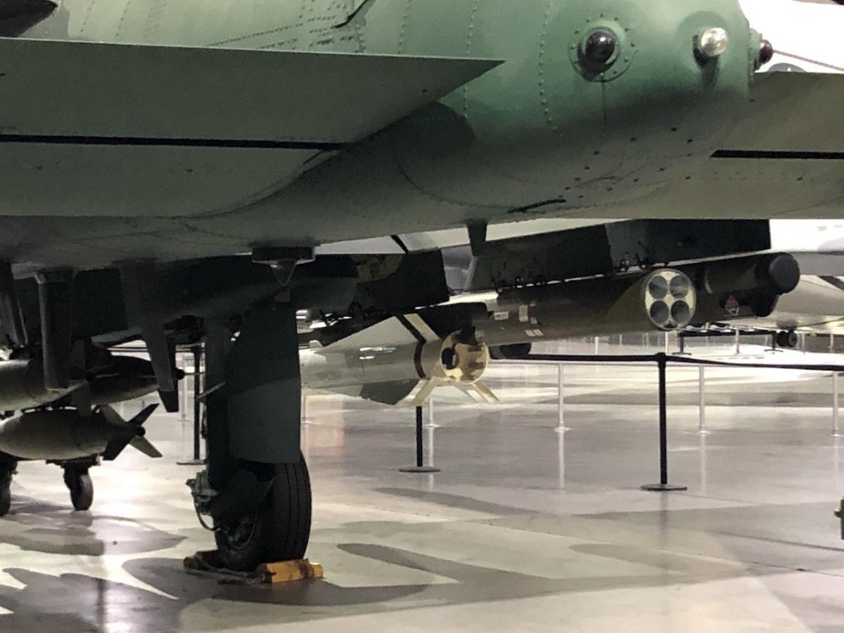

      I've considered main gear doors, but the trailing link struts would make it tricky, but it could be done with the oleo version struts

        ....I don't believe the A-10 has main gear doors...
        In today's world of the perpetually offended by everything, I think the union of main gear doors local #302 would be inclined to disagree. Possibly maybe even be insulted. LOLLOL
        Poor little main gear doors. Always forgotten....

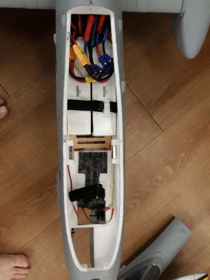

                        I have two CHNL 6s 6000mah 70c batteries side by side in the aft battery area, to balance the CG.

                            u
                            Guys... please keep your feet out of the photos I am 1/2 kidding... well maybe not quite 1/2 :Silly:

                              #9074
                              :Silly: Yeah saw that as well after I posted lol. My wife says I have cute feet! How love blinds us...:)
