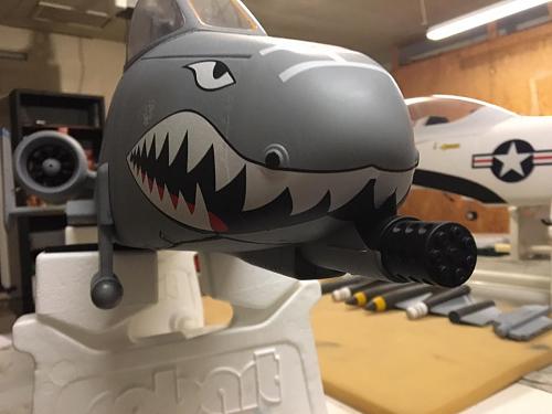

                      She is coming along. Long process with these rivets !
                          Nice job on the shark mouth decal...I spent hours trying to get that to cross the dimples and still come across the nose level at the front! How did you get yours to be so even on the front and still not hiked up the sides??? Rob

                              #7074
                              It wasn’t easy that’s for sure. I kept it half way on the waterslide paper till I found the perfect spot. There are still rinkles at the bottom sadly.

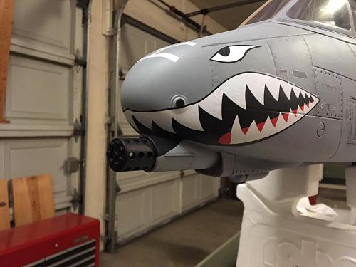

                                    Click image for larger version  Name:	IMG_0790.JPG Views:	1 Size:	90.9 KB ID:	107162Click image for larger version  Name:	IMG_0791.JPG Views:	1 Size:	78.8 KB ID:	107163
                                    Yeah, I had to cut mine in a couple places to snug on the compound curves...I used Solvaset to shrink up the excess. It is a challenging, but rewarding, project!!! Rob Click image for larger version  Name:	IMG_3003.JPG Views:	1 Size:	153.0 KB ID:	107164Click image for larger version  Name:	IMG_0789.JPG Views:	1 Size:	82.7 KB ID:	107161
                                    holy freaking perfect ! Dang you make mine loon like garbage. I have to paint in some black to make them blend together. Looks like mine is a lot lower than yours.

                                      #7078
                                      No way man...you're doing great! You're right about the black background though...here are some shots that show the black on the housing of the GAU-80 up to the fuse. One is RCJetdude's job too! Rob Click image for larger version

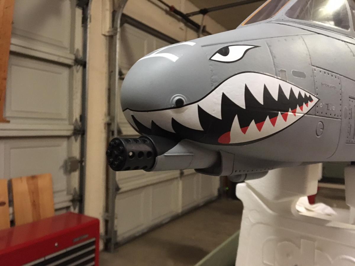

                                        So, I posted what I did but it was back on page 200-something.... so I'll post again.
                                        I also had problem getting the mouth decal to line up the way I wanted, to be close to scale. I didn't like that sharp "bump" where it met in the center. And the black part wasn't right either. So I left a big gap like you see in the first picture, then I painted in the black using a matte black paint. Then I cut out a thin strip of black decal using parts of the other decals that weren't used, and cut out two new white teeth using some white parts of the other decals, and picture #2 shows what I came up with. Its not perfect but from 2 feet away I think it looks pretty damn good.
                                        I also drilled out and painted the gun barrels because I didn't like the tiny holes that it came with.... BRRRRRRRRRRRRRRT
