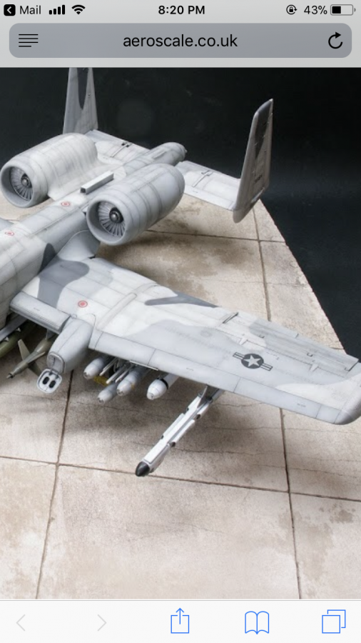

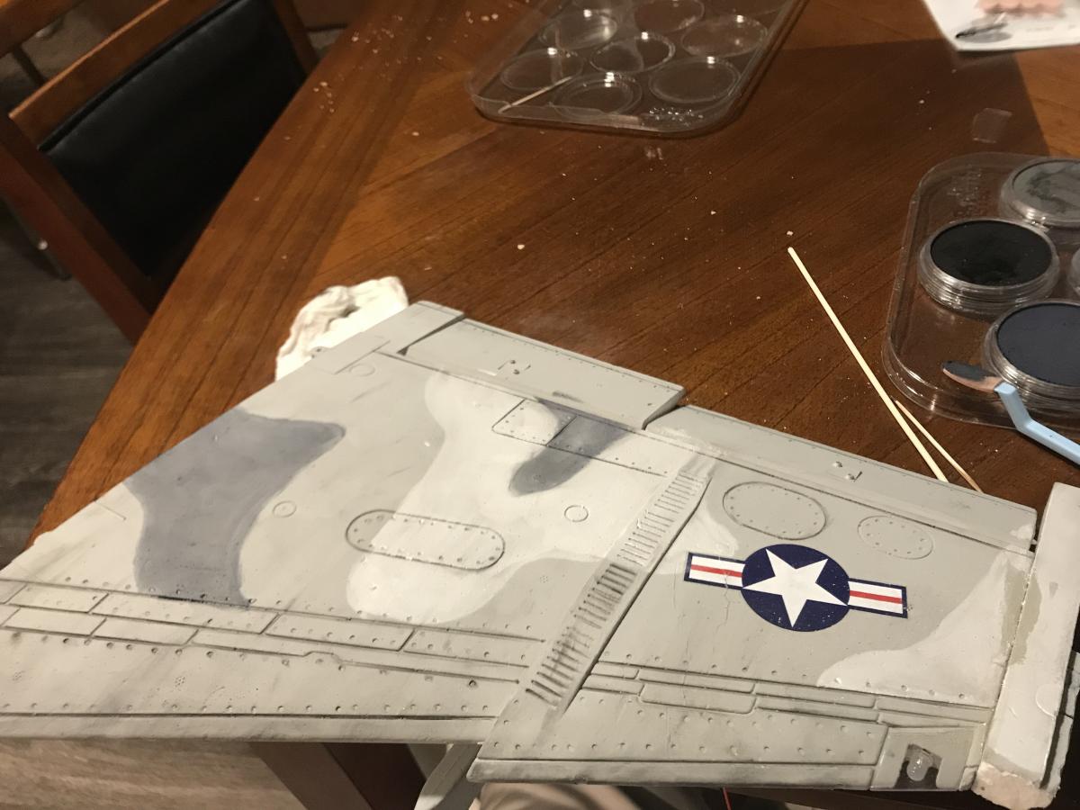

                    Practicing weathering/ painting for my a10. I’m using pan pastels which is a chalk of sorts. Anything I could spray over it to keep it from smearing ? And any tips on the weathering ?

                      Someone with more experience might chime in, but I believe best bet is a coat of minwax polycyclic or similar to seal it all in and stop smearing etc. works great on mine.

                        Do a sample test paint on a scrap of broken airplane... then try the clear matte finish on top.
                        I expect you will be better off with a spray so you don't smear the pastels with brushing.
                          #7032
                          I have been using either Testors Dullcote or Model Masters Flat Finish on my birds after detailing. Not only does it protect your detailing work, it also knocks any glossy sheen off decals and helps seal the factory paint.
                            Are you airbrushing the Testors Dullcote or the Model Masters Flat finish paints?

                                  No, I'm buying it in the 3oz spray cans. The Testors is #1260 Dullcote, and the Model Master is #196003 Lusterless (Flat) Lacquer Overcoat. Just to be clear, these are clear lacquer overcoats, not actual paint.

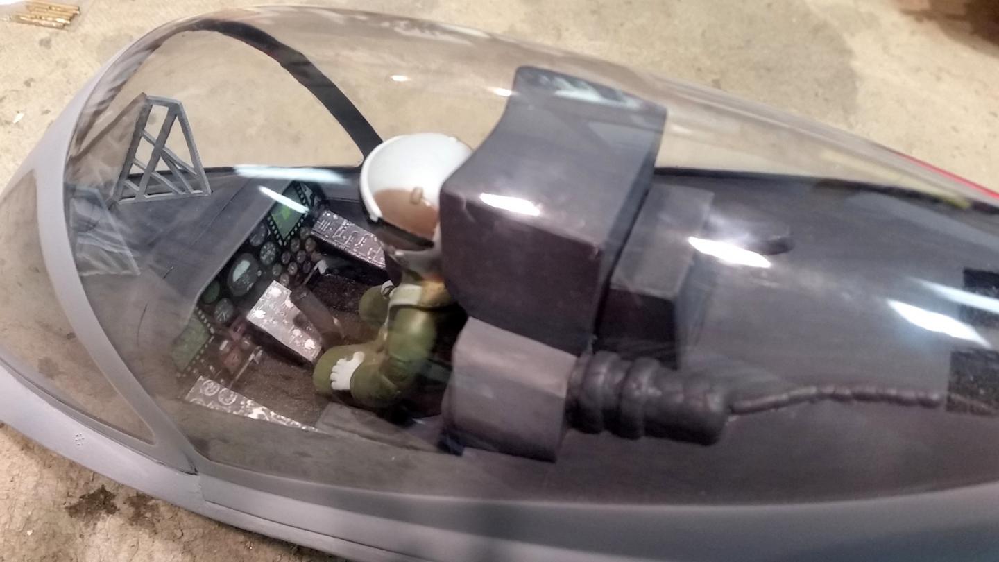

                                    So hey, I've been working on my A10 cockpit. Pogo's working canopy just blew me away, I can't believe how cool that is. I wanted to just quit!! But I went ahead and finished my little project up, it took me about two weeks worth of evenings.
                                    This summer I kept my bird out of the sun when it wasn't flying, but the foam inside the cockpit did alligator anyway, just from flying. The sun is powerful....
                                    So here's what I did to fix it:
                                    Removed the clear canopy by carefully peeling it off in one piece
                                    Removed the entire seat by cutting around the edges (this piece was glued in separately by the factory)
                                    Carefully sliced off the other three things behind the seat
                                    Cut out the two holes in the rear deck and cut out the floor of the cockpit, then inserted a very thin layer of black open-cell foam (this will allow air to circulate)
                                    Added paper decals for the side instrument panels and the center console
                                    Added a control stick
                                    Removed the HUD panel and side braces
                                    Sanded all the alligatored surfaces flat, then covered all of them one part at a time, with white cardstock, including the seat. This took a long time.
                                    I used some foam-filler to fill the cardstock-edges around the seat pieces
                                    Painted all the cardstock, and the rest of the interior a dark gray
                                    Reinstalled the bits behind the seat (they're covered in cardstock as well, except for the round thing)
                                    Reinstalled the HUD panel and side braces
                                    Glued the top back on (tonight)
                                    Yaaaaaay. it turned out OK. But it doesn't open. <sigh> And the pilot (Douglas Bader) has no knees.

                                      It looks really good.... Well done!

                                        Definitely a big improvement over the standard foam interior mudduck :Cool:

                                          Duck, the heavily 'gatored cockpit foam made me cringe all summer long- yours looks soooo much better now! :Cool:
