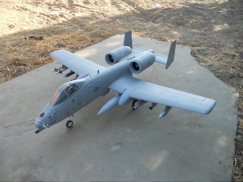

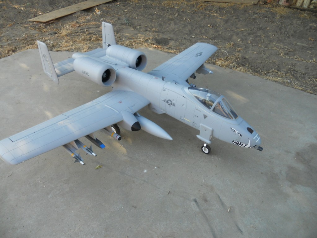

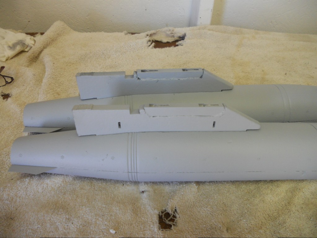

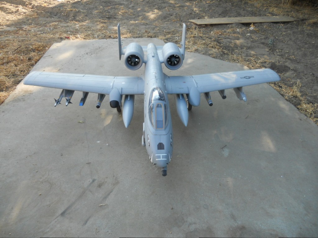

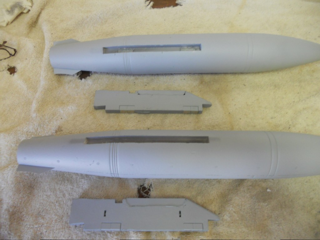

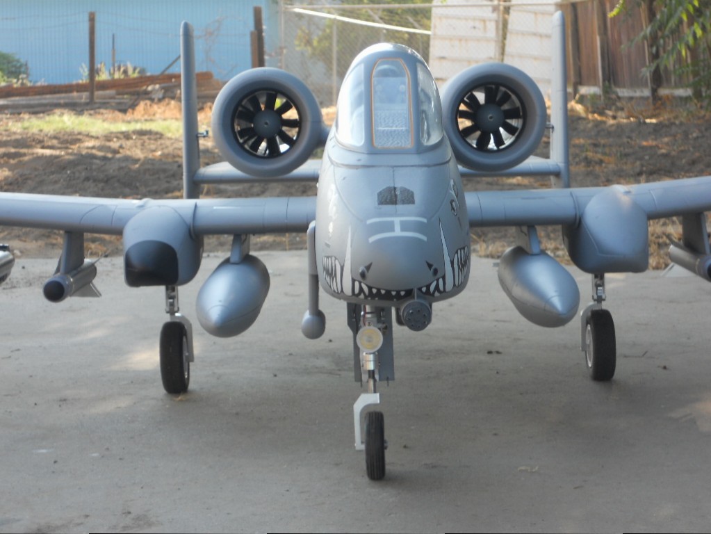

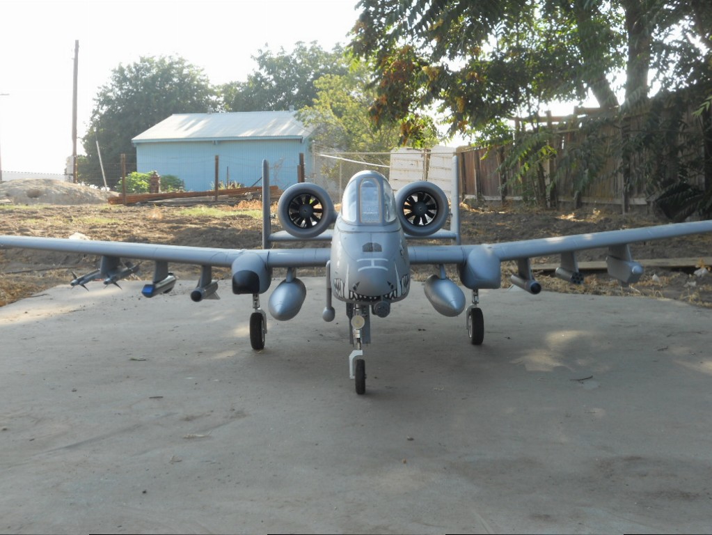

                    • These are my final production run drop tanks from the FW 90mm F-16.:) I flew with them this morning and didn't notice anything out of the ordinary as far as flying, added a couple beeps of up trim and you do notice maybe a little drag from them, sorry no video, only these pics......:Cool:
                      • Really adds to the already awesome look! Will you be making any for you to sell?
                        • Those tanks look awesome guys. Amazing work :Cool:.

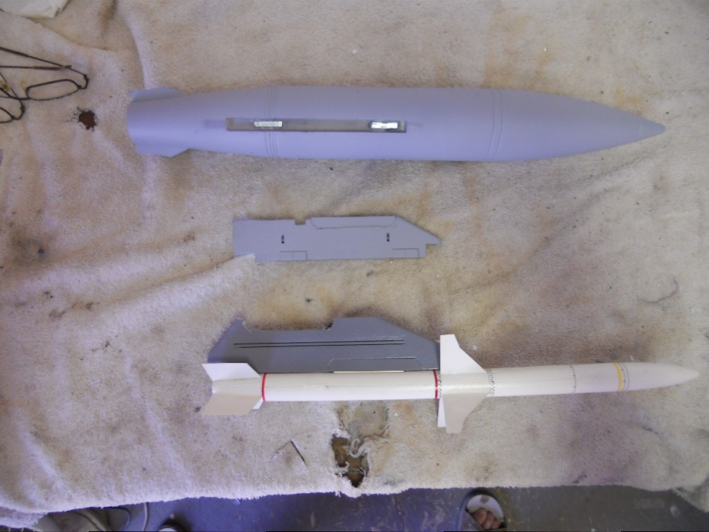

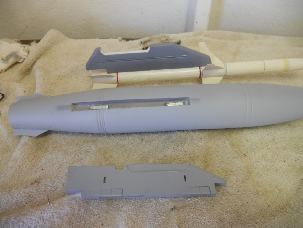

                            • Originally posted by DCORSAIR View Post
                              These are my final production run drop tanks, flew with them this morning and didn't notice anything out of the ordinary as far as flying, added a couple beeps of up trim and you do notice maybe a little drag from them, sorry no video, only these pics......:Cool:
                              Those are the 90mm F-16 tanks modified with sliding brackets instead of the magnetic mounts right?
                                Those tanks look amazing! Nice work.
                                • Well, thank you guys for the kind words, I wasn't sure if the tanks would look right or not, or maybe just mount one down the middle, I seen someone else doing the middle drop tank so I thought I would be different. Yes, all the parts I used are from the FW 90mm F-16, I only run the sidewinders on my F-16 and I had all the parts laying around doing nothing so I thought, why not. All I did was slice off one of the plastic sliding mounts from the AGM-88 mounts, then I shaved off the top of the magnetic mounts for the drop tanks, glued the sliding mount in place of the two foam tabs that go into the F-16 wing, slice those off then just cut the foam from the top of the magnetic mount down until the plastic sliding mount fits even, glued everything with five minute epoxy, now I can slide the whole thing on or off or just leave the slider mounts on and take off the tanks, which are held on with the magnets.
