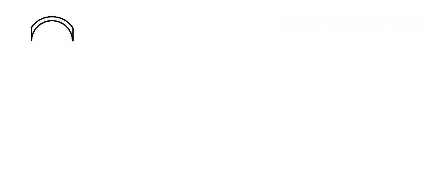

        I have one of those bench top belt sanders with the side disk sander as well. I just set them on the tray next to the disk sander and kept sanding down the edges and having to break off the burr on the bottom edge of the dome until I got the diameter down to about a 1/32" larger than the inside edge of the dome. Something like this. obviously with the Pave Penny you only want to take it down to the OD of the foam which left about a 1/8" flat edge all the way around the 7/8" dome.
        Click image for larger version Name:	Maverick dome cross section.jpg Views:	1 Size:	16.7 KB ID:	91644

                I used the 7/8" and 1" domes to do what I did.

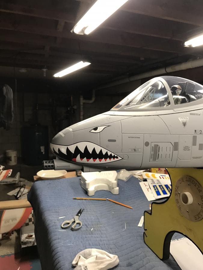

ID:	91716 Well I got r done. Whomever had the wet sock idea,thanks !! Worked like a charm!! It may not be perfect but it's done!!

                      Looks awesome mate. Great job.

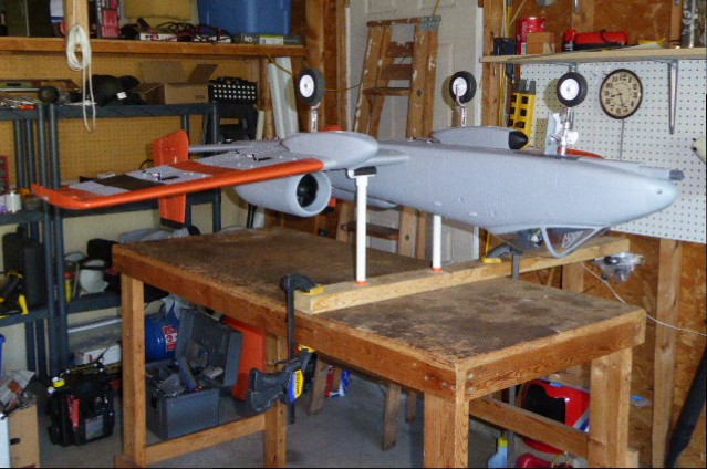

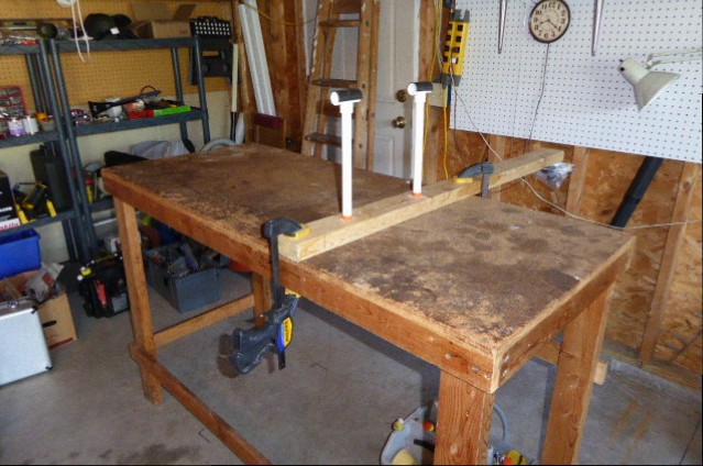

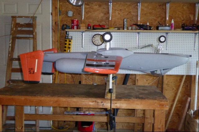

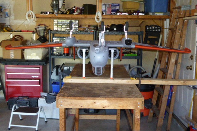

                                  INEXPENSIVE BALANCING STAND FOR YOUR FREEWING A-10
                                  I made this stand with parts I had around the house: a piece of 2X4, some 1/2" pvc, a couple of "T"s, and some "Non-Stick" tool box liner.
                                  The only thing I had to buy was the liner - and now I can line my tool boxes with the leftover!
                                  It is self-explanatory. Glue the tool box liner to the top of the "T"s. The center-to-center distance between the uprights is 10". The uprights should be at least 10" long. I drilled out the 2X4 with a 7/8" bit, which is a little sloppy, but I put a couple of laps of orange duct tape around it so they fit tight.
                                  As long as you are close to the CG, the liner will keep it from slipping and you can move the airplane around until it balances perfectly.

                                  Nice work.

                                        What is the wet sock idea? Brad
