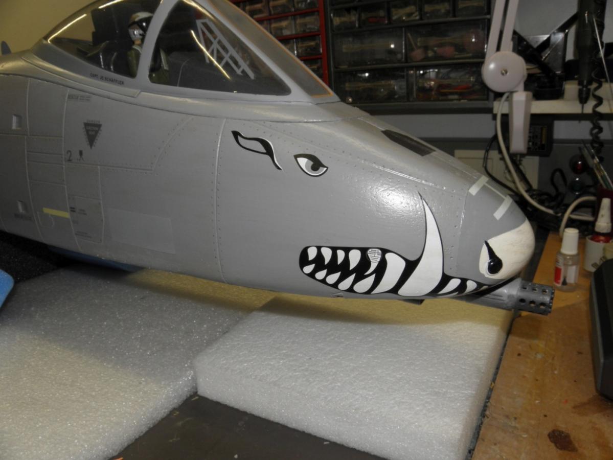

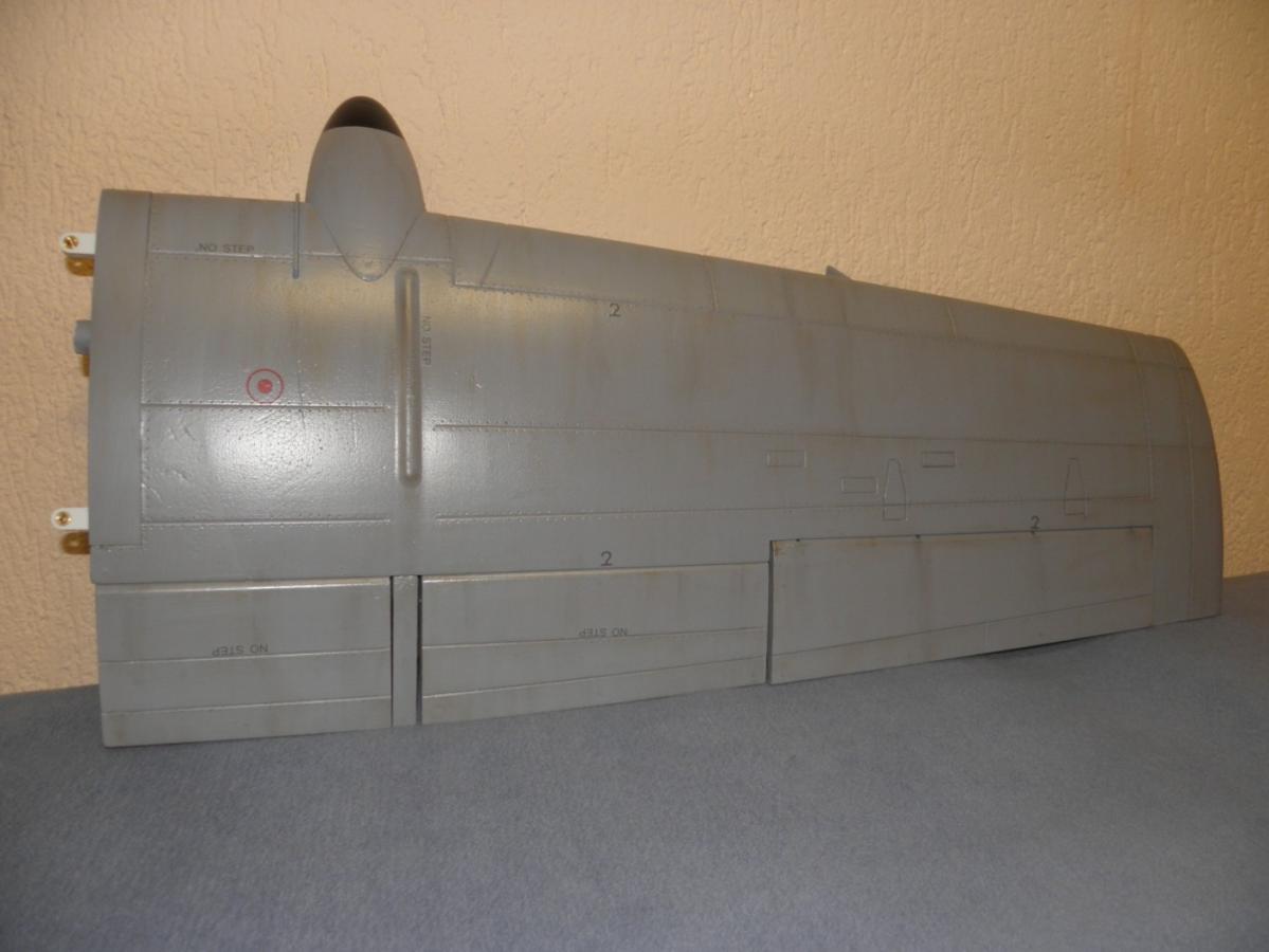

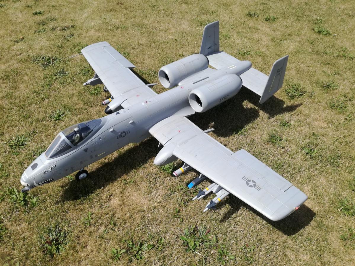

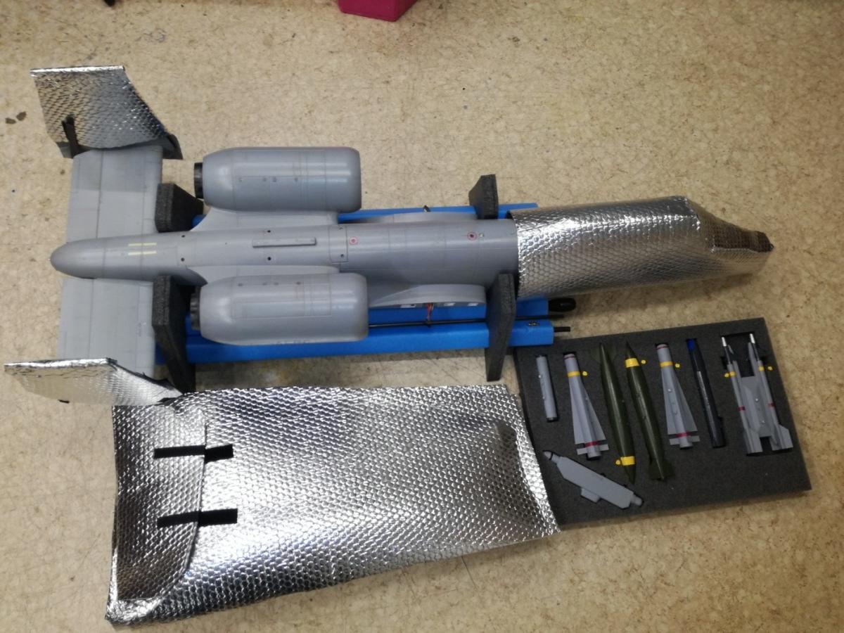

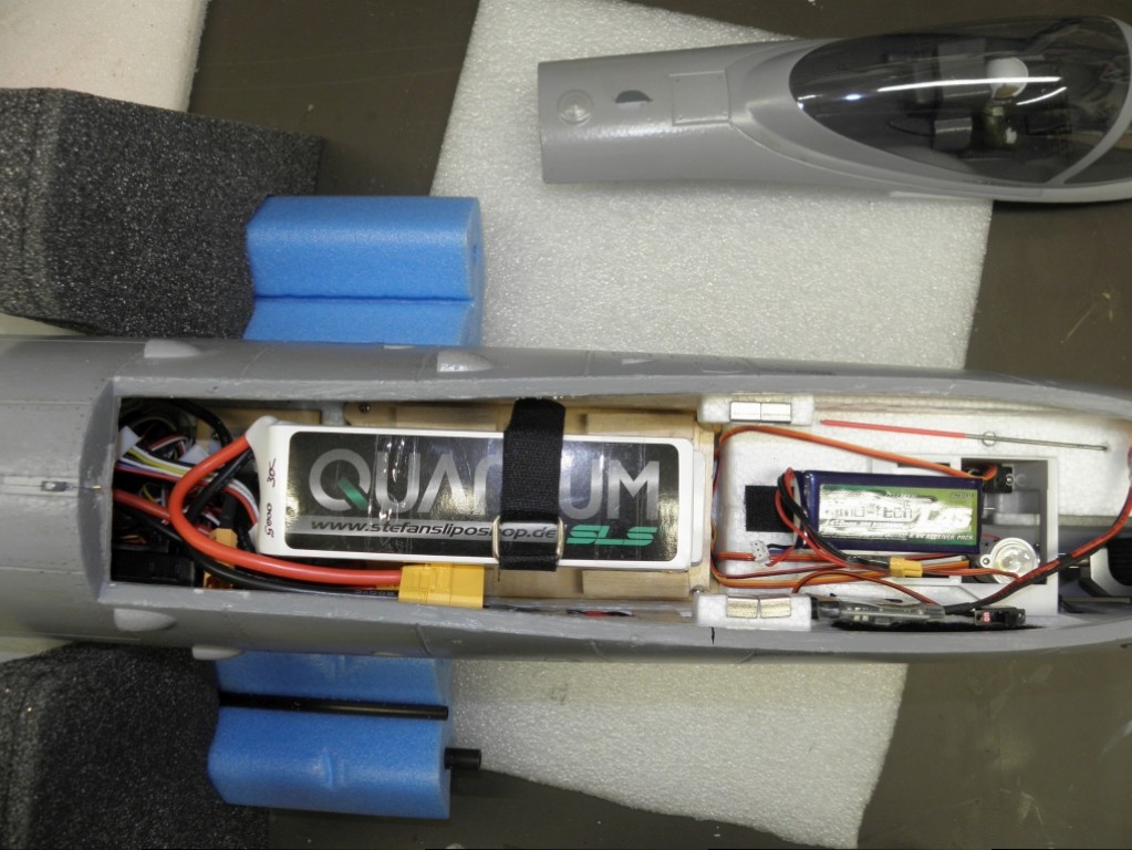

          I do a few modifications, for example both Batteries 6S 5000 SLS in the back position, cg are more back at 86 mm (middle of the front carbon tube), external LiFe for the Receiver,
          rivets are made with a pencil, weathering with Tamiya Set and a varnish coating with acrylic semi gloss.
          Now a few pictures of my A-10
          Click image for larger version Name:	A-10 Akku.jpg Views:	1 Size:	163.1 KB ID:	90290

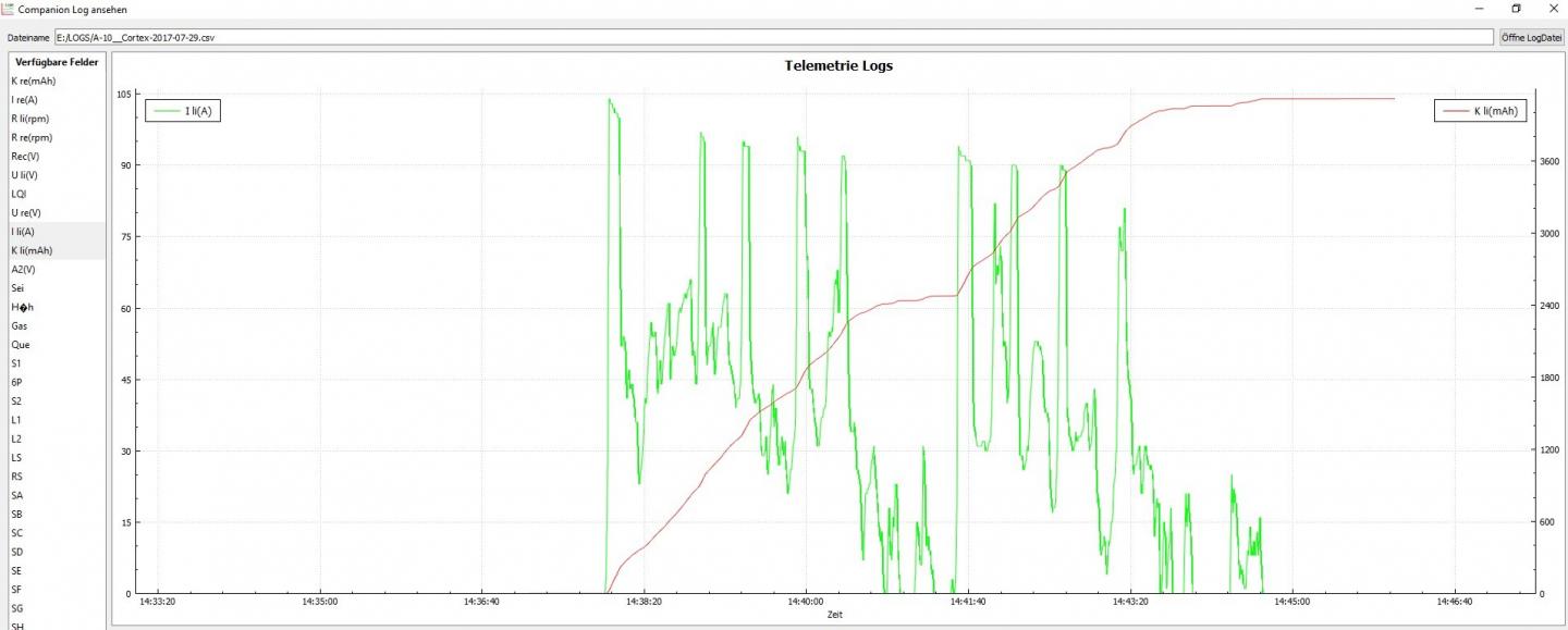

          Log SM Unisens E left turbine (video flight), right turbine is the same.

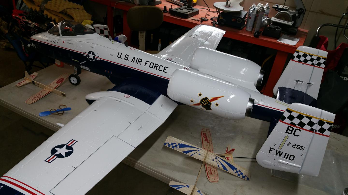

                I​ ​ ​

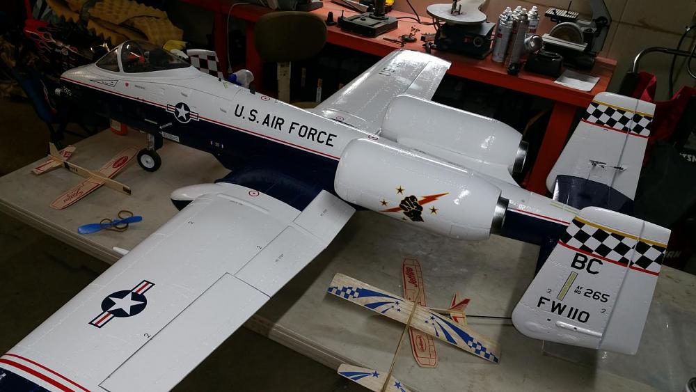

                I am done with the clear coat finish now. Competed the setup and and radio settings. This bird is ready to fly now. I have to get it out of the shop and finish other planes now, because I have other planes on the way that I will have to start on :)/

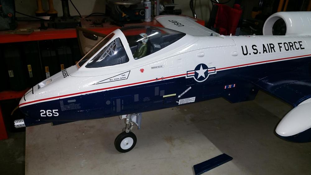

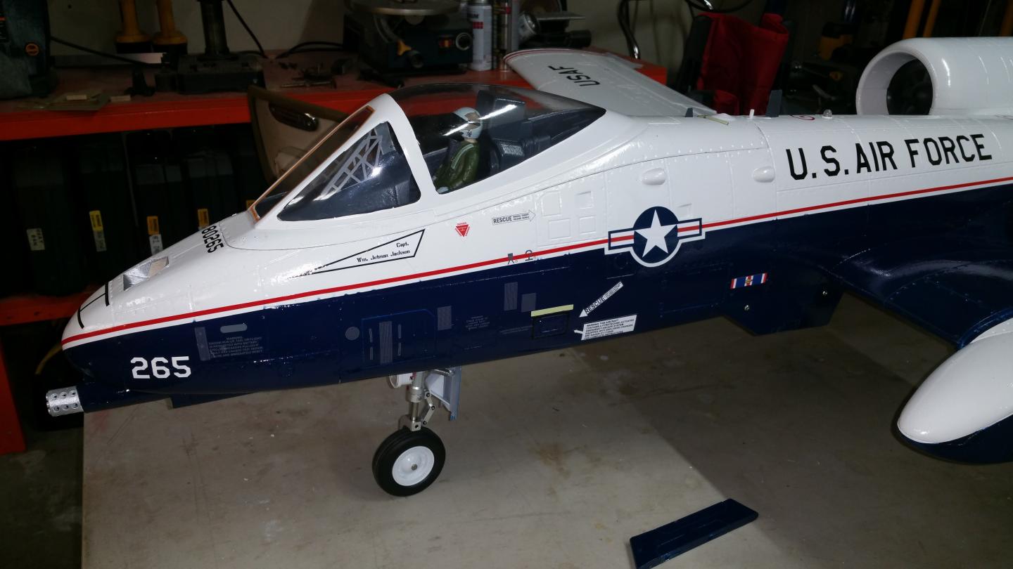

ID:	90425Click image for larger version  Name:	20170731_055406.jpg Views:	1 Size:	100.6 KB ID:	90424​​​ ​​​ ​​​ ​​​​​​​ the , . .

                    Looks SO amazing!! Fantastic job!

                      Thanks T-CAT, She's no show piece, and I could have done better on the paint had I took my time, but good enough for me to fly with some pride.

                            OMG that is gorgeous! That's my new favorite paint scheme!

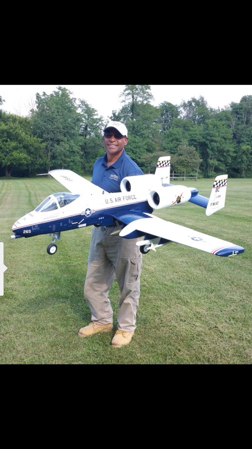

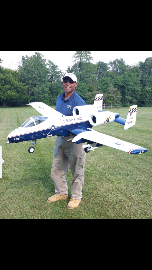

                                  WOW! That one would be my "Hangar Queen" and I'd order another to fly. Fantastic job T33!!
                                  That just put me to shame. I don't have a single decal on mine yet. Don't know if I've been lazy, or if I'm letting work be my escuse. YIKES...I'd better get busy detailing.

                                        Mighty fine job.
